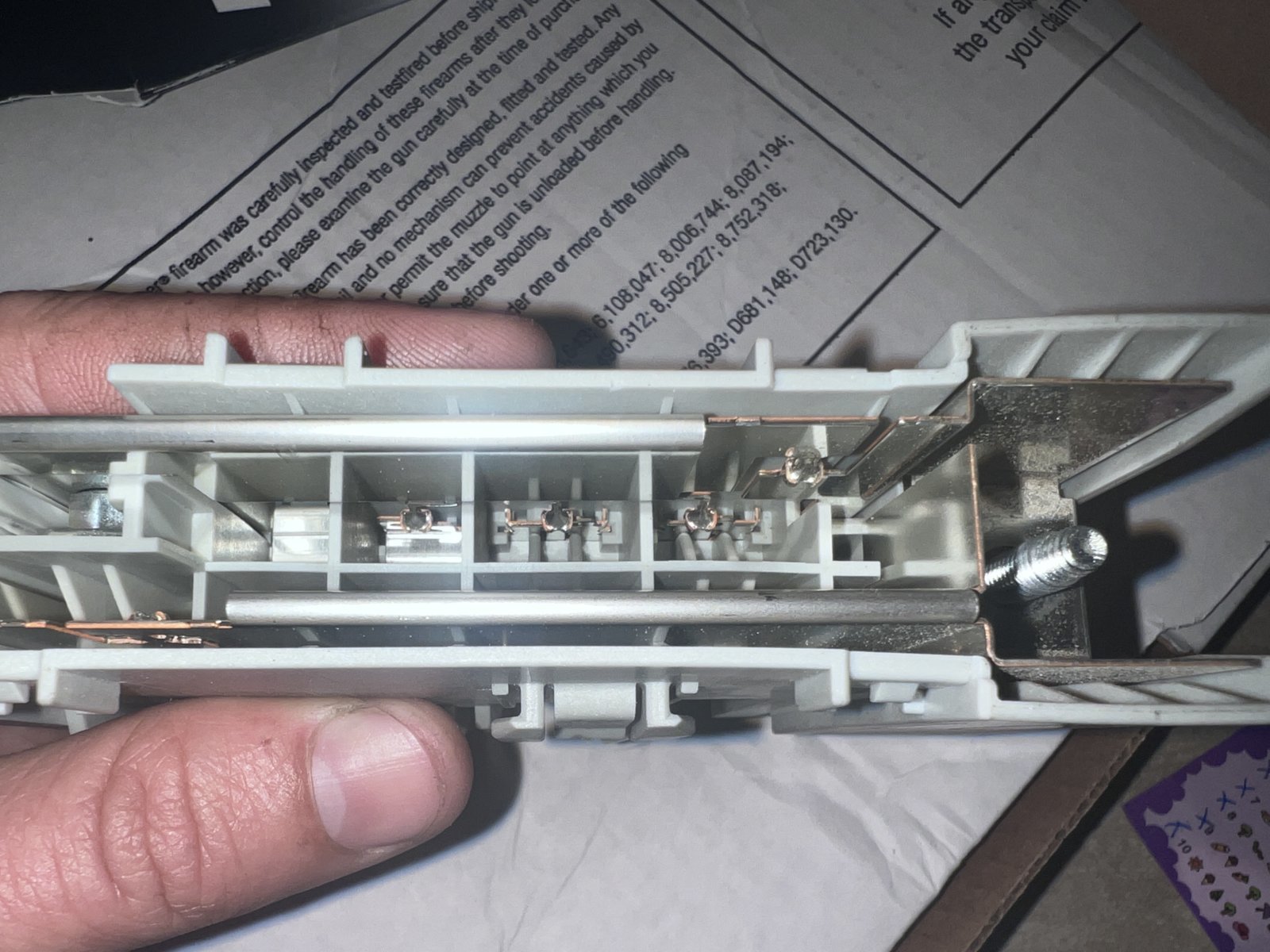

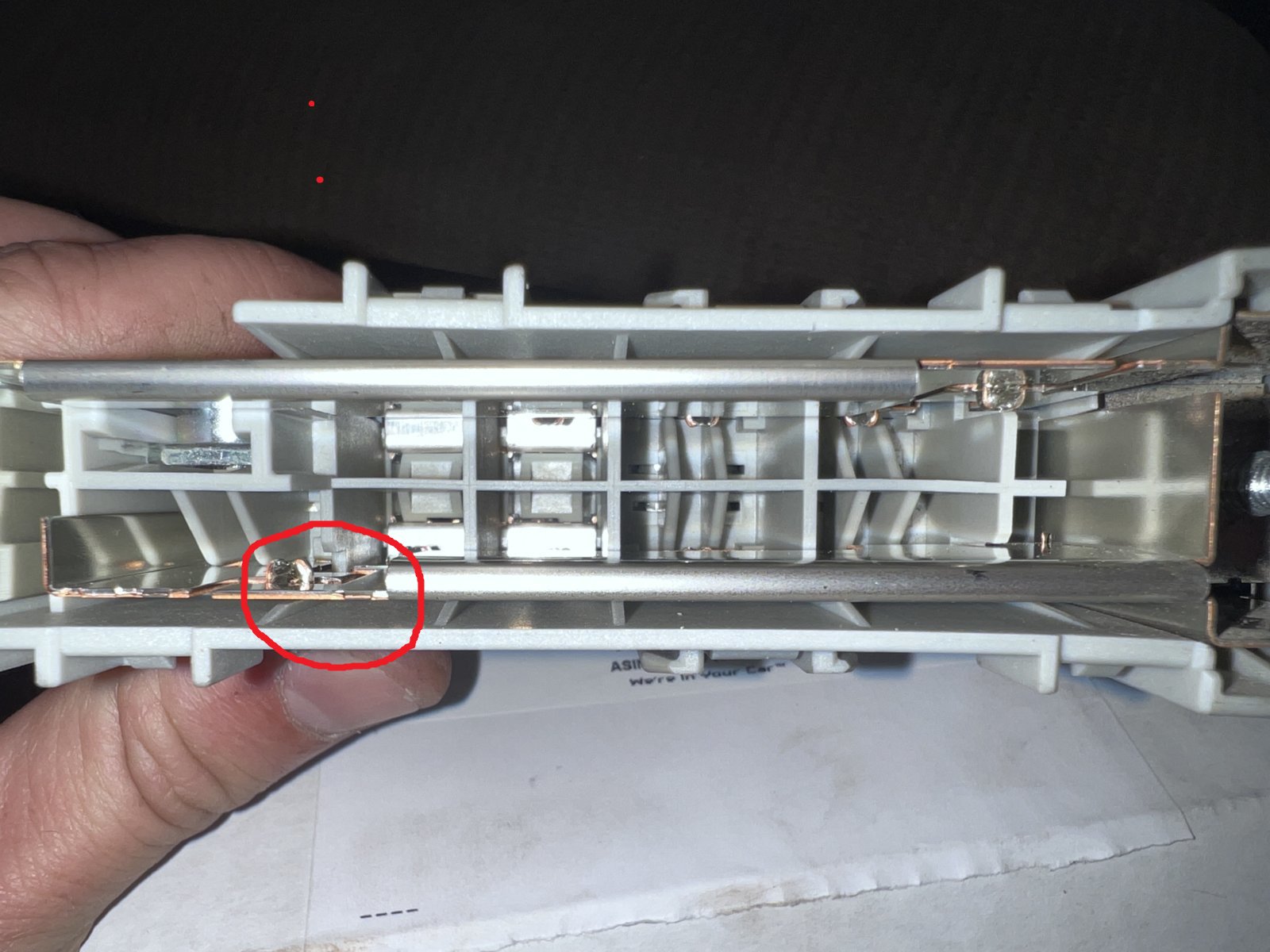

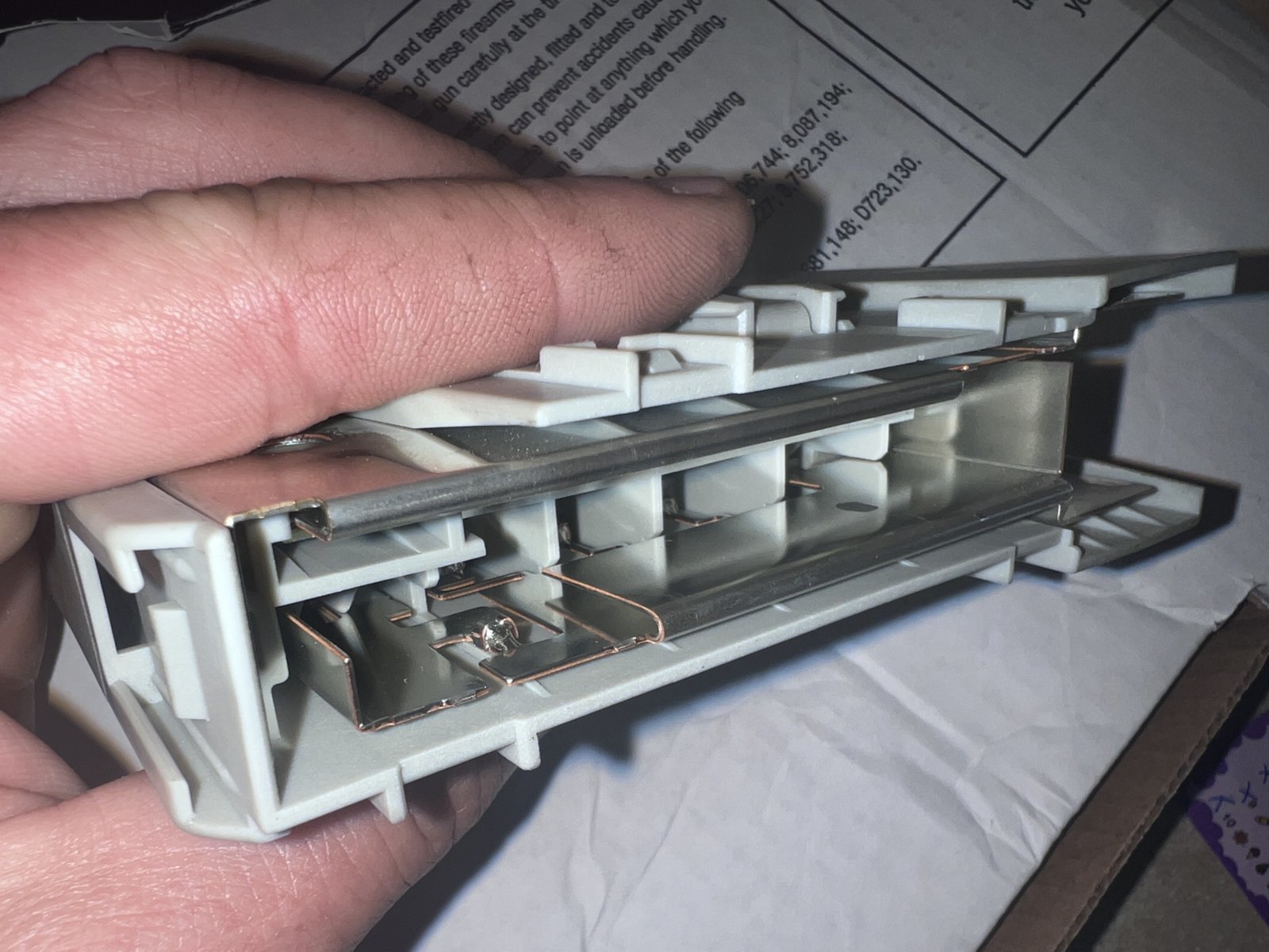

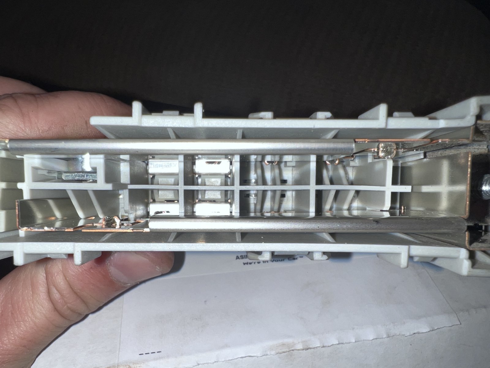

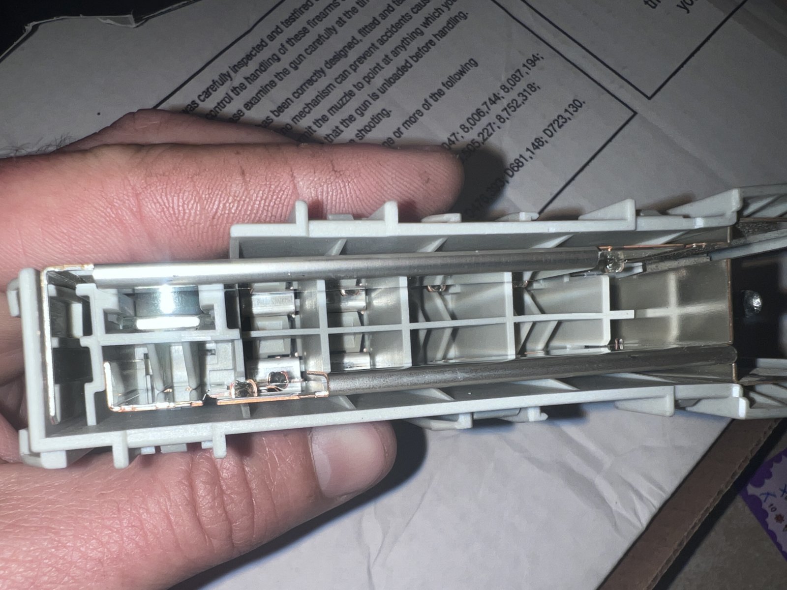

  3. Mar 16, 2024 at 2:38 PM

    Is this burnt out?

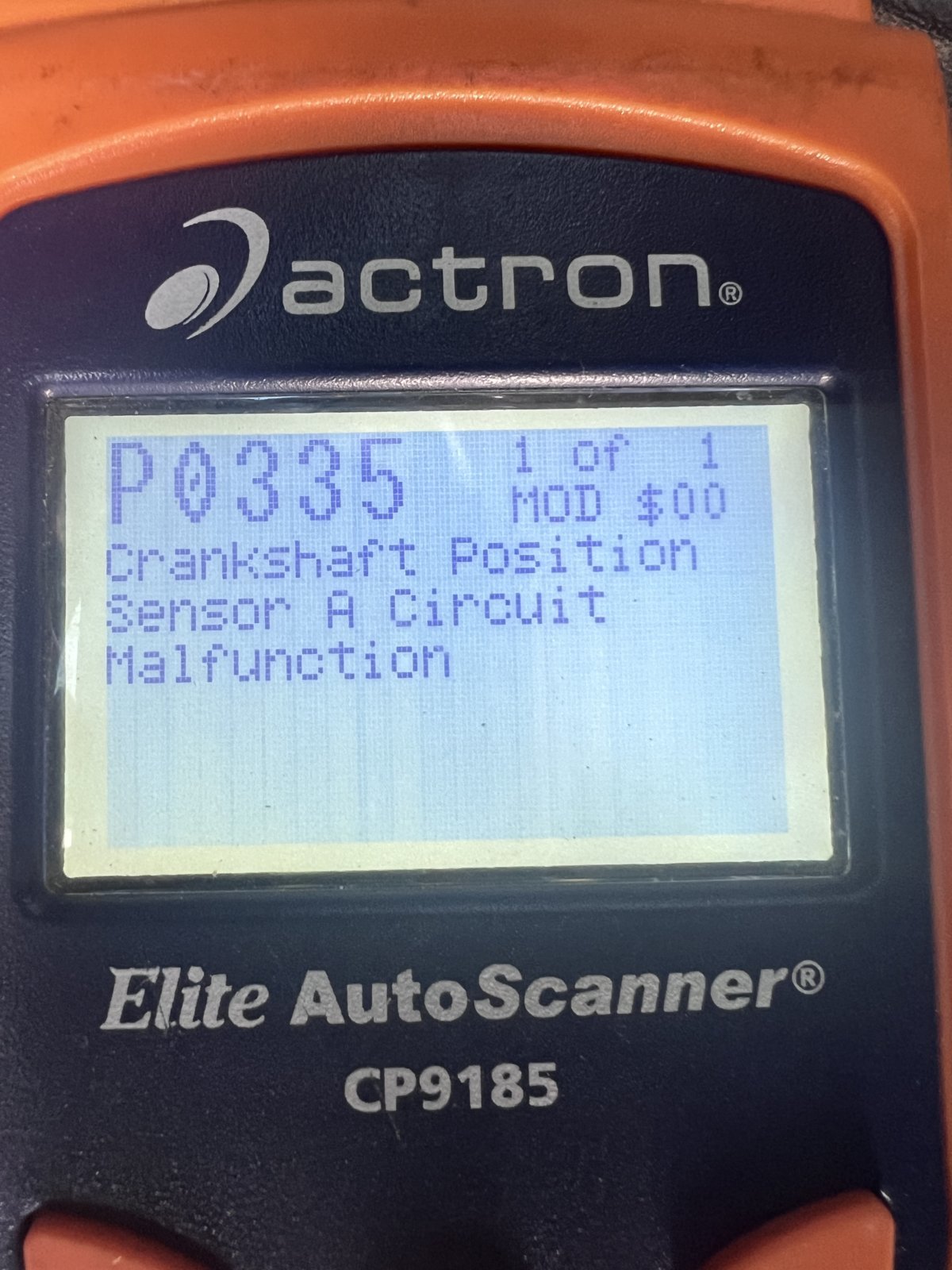

    I don’t think it is.
    Also, I read Code P0335 “Crankshaft position sensor A Circuit Malfunction”. I cleared the code and tried to get it to throw again and couldn’t. No other codes at the moment.
    New photos attached.
