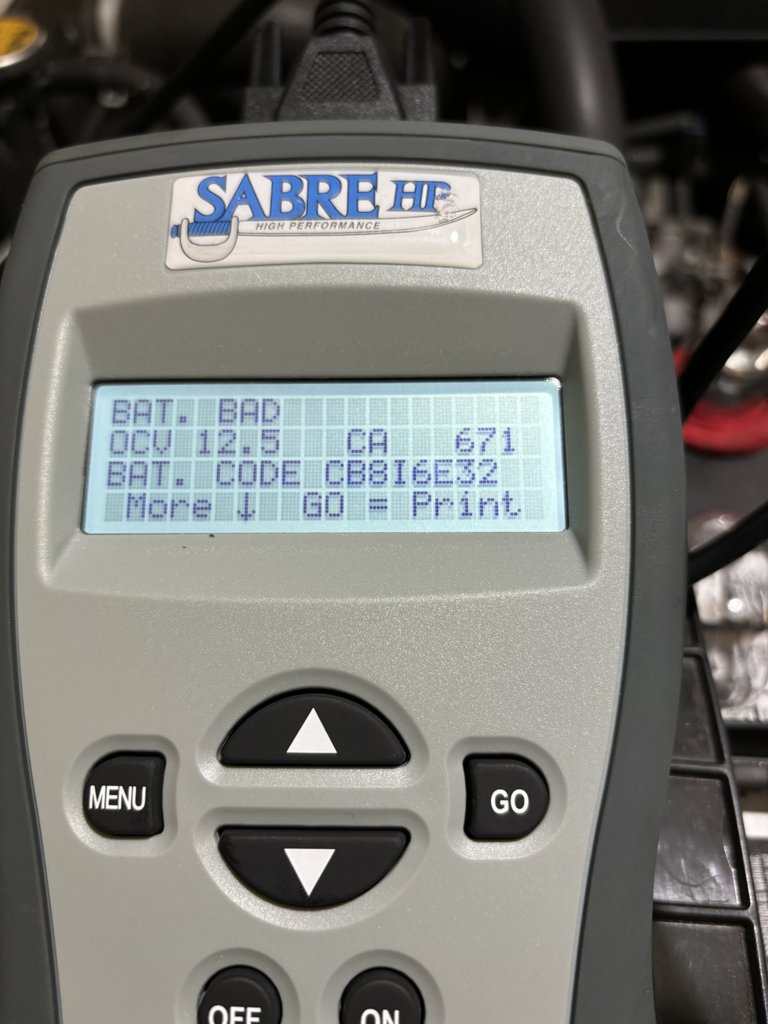

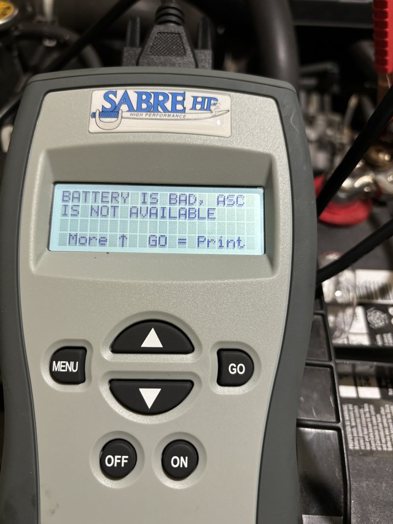

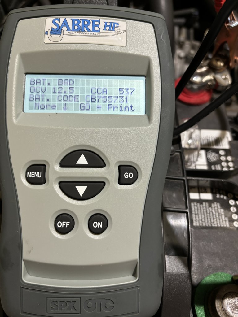

    Fortunately, you should just need to tell them to test the battery, they'll probably have a battery tester similar to mine, and it'll clearly tell you the voltage "OCV" (12.5v in this case) and the cranking amps "CA" (671 in this case), and the cold cranking amps "CCA" (537 in this case). It also tests outputs other factors of the battery that are maybe important or not (DIN, AHR).
    And the tester will read "BAT GOOD" or "BAT BAD", as mine shows it was BAT BAD and then says it more clearly on the 2nd screen. If they have a printer attached, it'll print out a report with all this info, easier-to-read.
    Fortunately, they make it stupid simple
