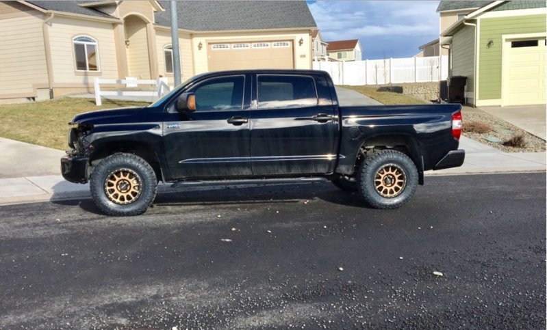

    Bilstein 5100 F&R - Front middle setting w/2 CB shims Toytec rear shackles @ 1" setting Method NV 18x9 +25 Bronze 295/70/18 Nitto Ridge Grappler Retrofit headlights with Morimoto DS2 4.0, Apollo 3.0 shrouds, switchbacks Prodigy P3 brake controller
    I'm rocking them as well in a 295/70/18 size. Truck needs a good wash after this nasty winter is over.

    Truck looks good are you running any shims up front on your 5100? What notch are your shackles on?
    Front 5100's are on the middle setting with 2 shims per side. That gave me 2.6" of lift. Rear is on 5100's with toytec shackles on the 1" setting.
