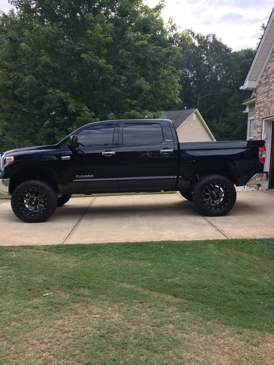

    6inch RC with upgrade struts. 295/65/20 Nitto Ridge grappers 20x9 fuel vapor with 0 off set
    6 inch lift 295/65/20

    Looks sweet! What offset do you have?
  23. Jan 29, 2020 at 2:38 PM
    DM 2018 Tundra
    DM 2018 Tundra New Member
    Nov 1, 2018
    #21227
    719
    South Carolina
    2018 Limted Tundra
    0 offset. Sticks out 1.5-2inchs

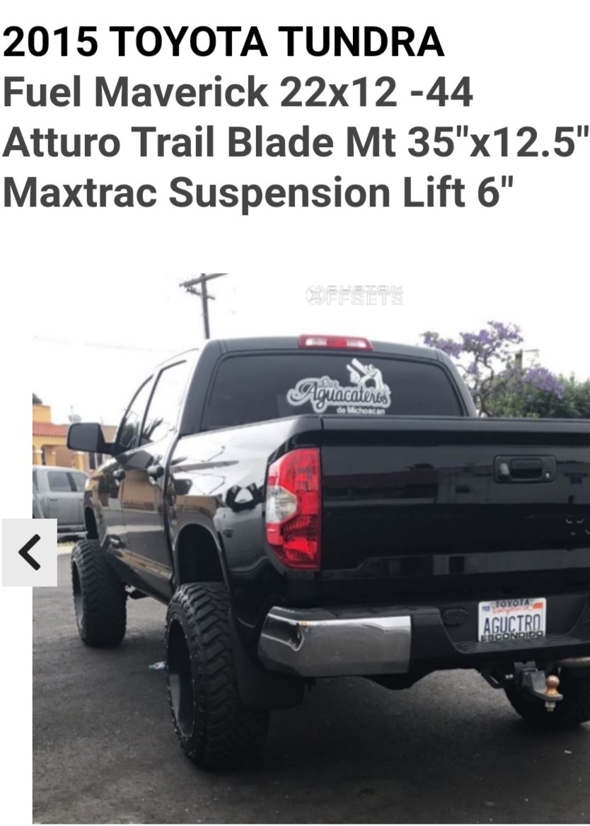

    There are almost 1000 things to say to your first post its impossible to go.over all of it 100%. As far as lift goes your on the right track in my book that new set up rough country just came out with is very nice. That a side wheels and tires. I love this forum bit at times alot of people including myself will tell you stuff of what we like and not maybe what you want. I highly recommend you check out customoffsets.com tundra photo gallery you can put in what size lift you may want and wheels and almost every time there will be at least 5 trucks in there with that exact set up. As for me I'm on a 6" RC lift and 18x9 wheels +1 offset and 35s but moving to a 22x12 -44 offset wheels and 35s by this summer. here is my truck now
    Here is a truck with a -44 offset wheel on a 6" lift.
  28. Jan 29, 2020 at 5:04 PM
    #28
    Mnorris1206
    Mnorris1206 Super white is fast as f***
    Dec 24, 2018
    #23448
    2,509
    08 tundra
    6" lift kit 35" tires with cold air intake and exhaust
    Is thos because of tire ? Or offset ? Just curious.

    I will definatly be checking out customoffsets website. Do the pictures come with a list of whats exactly installed. So I can print it off and take it to my local shop and just point while I smile and nod?!?
