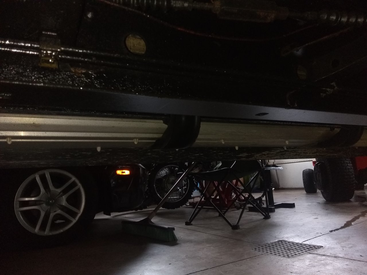

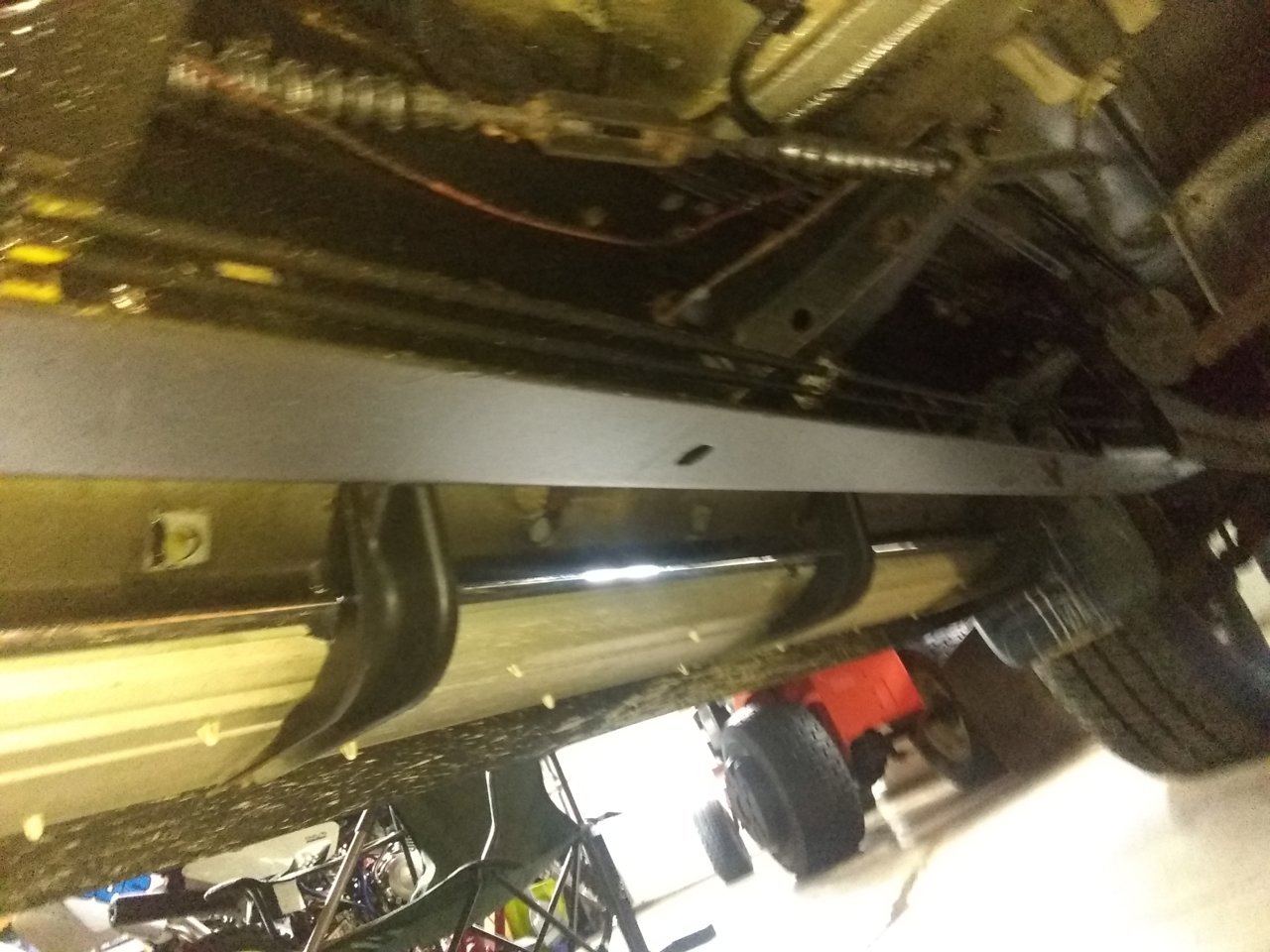

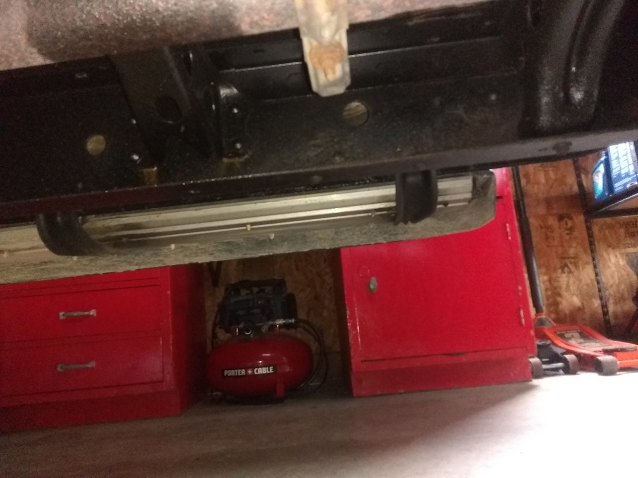

    2. The frame is in good condition for a truck that has been in Michigan for 7-8 years. I applied fluid film twice a year on my Tacoma and that seemed to slow the rust and keep the frame solid. Should I keep doing this? What do you all recommend for a Tundra in the Midwest?

    Nice lookin truck.. the answer to all 4 questions is yes.
    I would let the TB go another year or so, but, you know what they say about an ounce of prevention...
    Oil changes can be done at 6-7K with synthetic. Even then, it's going to come out looking like new oil. I promise.
    keep doing the Fluid Film application. It's a good idea.
