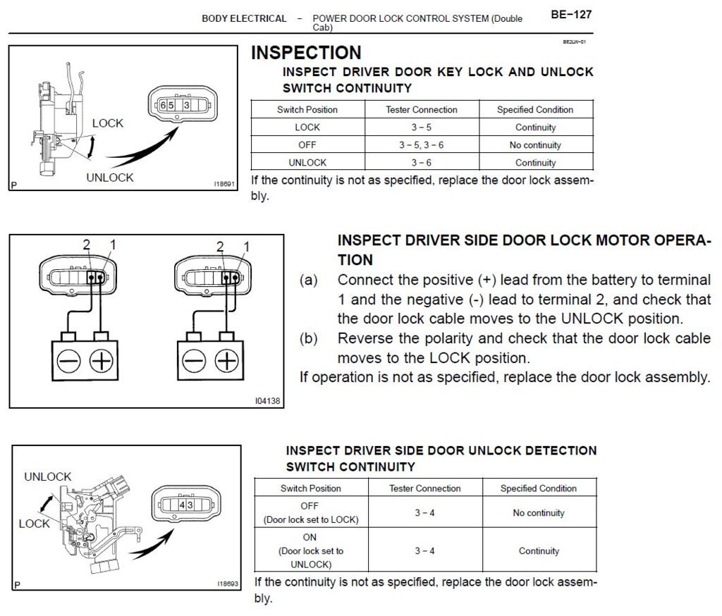

    While closing the door slowly, look at the door lock and the door lock striker, are they that far out of alignment ?
    I don't believe the door would be sagging enough to pinch wires going from drivers kick panel to door cavity. Personally, I feel your problem is the door actuator. Definitely have to remove door card to investigate.
    The below tests should help determine if it's the door actuator.
