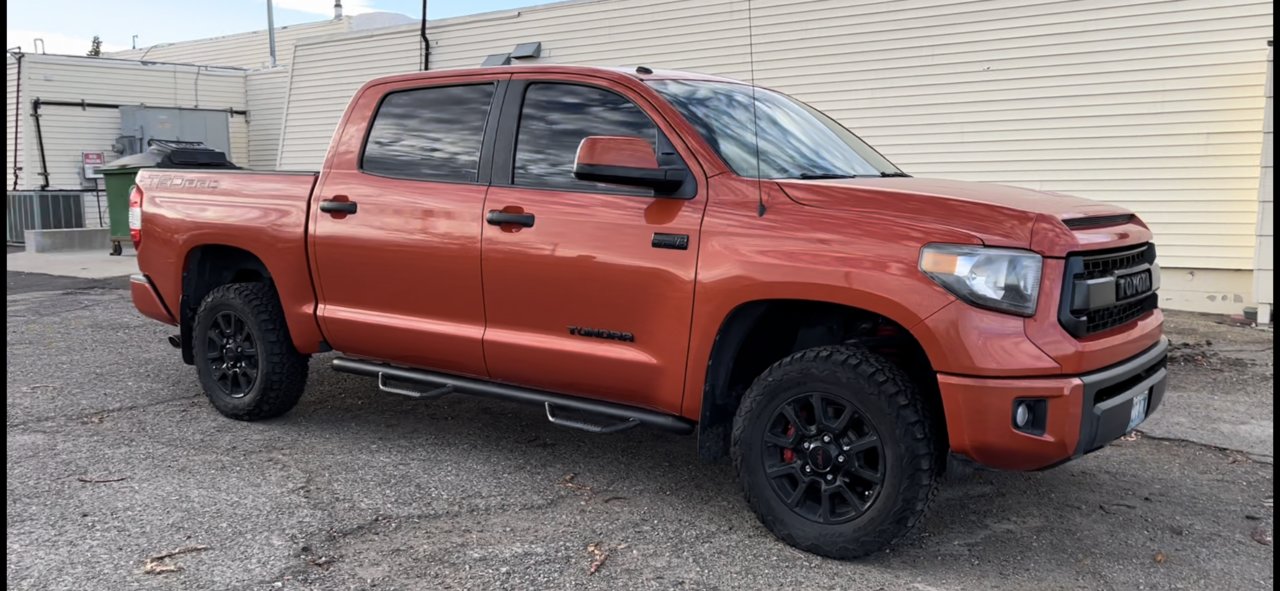

    I just purchased a 2015 TRD PRO inferno orange with 103k miles. I purchased it for $27k.
    Previous owner had all service records and has airbags for towing.
    I’m not sure if I paid too much or got a good deal. Still nervous about the purchase.
    TXCarol7304[OP] and Terndrerrr like this.

    I think you did just fine. I traded my 15 Inferno TRD Pro (extended cab, not crewmax) with 60k miles in on a 19 TRD Pro last week and they gave me $33k on trade. Had the local Toyota dealer offer me $33k cash as well but with the reduction in tax liability going the trade route it saved me about 2k. I suspect they will put it on the lot at around $38k and go from there.

    Thanks guys! For now, I’m going to enjoy it for now and not do any modifications as I feel it does not need any. The interior space is very spacious compared to the 5th gen 4Runner.
