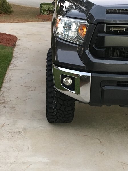

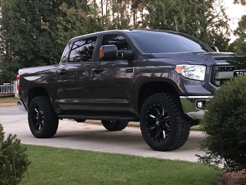

  14. Oct 23, 2016 at 7:36 PM
    #44
    louscrw
    louscrw all jacked up on Mt. Dew
    Oct 11, 2016
    #4829
    1,302
    Lou
    Warner Robins, Ga
    2023 F150 Raptor
    Looking at Fuel's website, you can get 20x9 Vapors in a +1, +20, or +35 offset. The +1 will be too aggressive and probably require BMC. The +20 will stick out pretty close to like mine and will probably require similar fitting as mine. The +35 will sit pretty flush with the fender and will probably require a little less work to eliminate rubbing...if you have any at all.
  15. Oct 23, 2016 at 7:40 PM
    #45
    Royalpeeps
    Royalpeeps [OP] Awesome!!!
    Oct 18, 2016
    #4913
    512
    Chad
    2017 Blazing Blue Pear Tundra SR5 TRD Package
    20" Fuel Vapor wheels 35" Toyo A/T II Tires 3 inch Toytec Boss kit with SPC UCA NFAB Wheel to Wheel Black Textured Nurf Bars OCD Center Storage Organizer and tray
    Thanks. But I'll prob get fender flares and want them to come close to even with them so looks like the +20 will prob be the ones and I'll have to mod. Damn it Jim. Sacrifices of designing a bad ass truck I guess. As long as I don't have to cut into the cab manifold or anything extensive. If it's a trim here and there I'll be ok.
  16. Oct 23, 2016 at 7:43 PM
    #46
    louscrw
    Oct 11, 2016
    #4829
    1,302
    Lou
    Warner Robins, Ga
    2023 F150 Raptor
    Here's a pic of front and back of mine
  17. Oct 23, 2016 at 7:47 PM
    #47
    Royalpeeps
    Oct 18, 2016
    #4913
    512
    Chad
    Yeah that's what I'm going for. That looks nice.
