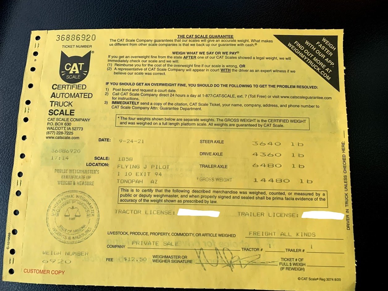

    I would look at your hitch setup and it might help marginally..... By looking at the weigh ticket, your front and rear axles weigh a combined 8,000 pounds on the truck. GVWR is probably 7,200 for that truck so you are about 800 pounds over payload. I am going to assume that bone stock that truck weighs about 5,800 pounds.
    Looks like bigger tires and wheels? 200 lbs.
    Truck Bed Cover 200 lbs.
    WDH 150 lbs.
    Add these to 5,800 pounds of the truck and you are at 6,350.
    This means you have a hitch weight of 1,650 as you were configured at that time. That seems about right if you were loaded up to 9k pounds as a travel trailer hitch weight is usually around 13-16% if loaded right, with right hitch setup to prevent sway.
    However your trailer looked to be relatively empty at the time so looks like you were really tongue heavy at the time.
    I am making some assumptions on weight above but I am pretty close. Looks like hitch adjustment or a different hitch would help out. I would imagine that trailer would be a handful with that setup...
