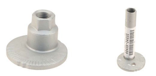

    Yes I'm noticing this... The passenger side is set nice but the drivers side is positive camber (the top of the tire sticks out further than the bottom.)
    I need to move the driver's side eccentric to match the passenger side ....

    take it to an alignment shop, it's going to save you money on tires. next time use a marker and mark where the bolt sit.

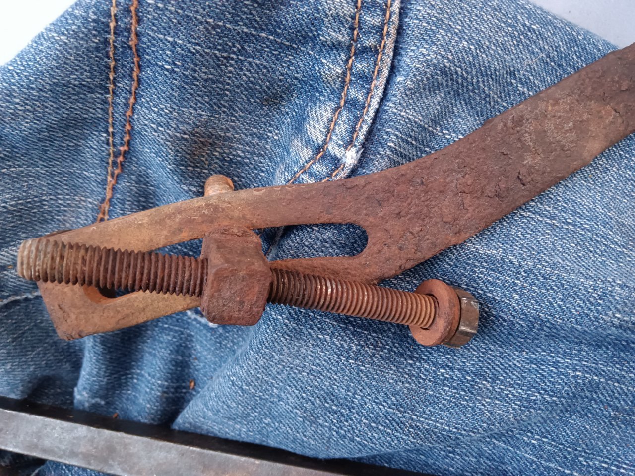

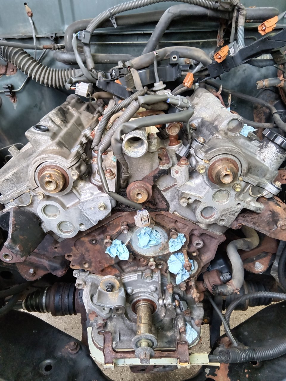

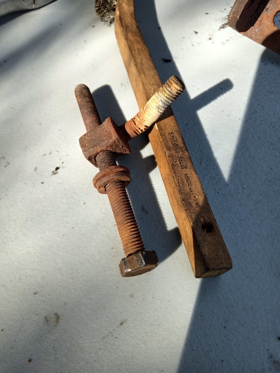

    Moving slowly on the timing belt and valve cover. Lots of rusty bolts. The alternator adjuster was siezed and so was the alternator itself. Having to clean and dress all the bolts. Going to do the tare-down then make a trip to the junk yard to get all the replacement parts that failed...

  5. Jun 12, 2023 at 5:54 AM
    #245
    shifty`
    Jun 20, 2020
    #48239
    31,567
    ATL
    '06 AC Limited V8/4WD
    Nothing a 3-4 hour soak in Krud Kutter wouldn't solve.

  6. Jun 12, 2023 at 6:32 AM
    #246
    Bmktw2
    Bmktw2 [OP] Yard Dog
    May 16, 2023
    #97109
    474
    Nic
    AC 2001 5spd 4x4 V6
    The bracket is bent, the bolt is bent and siezed...
    shifty` likes this.

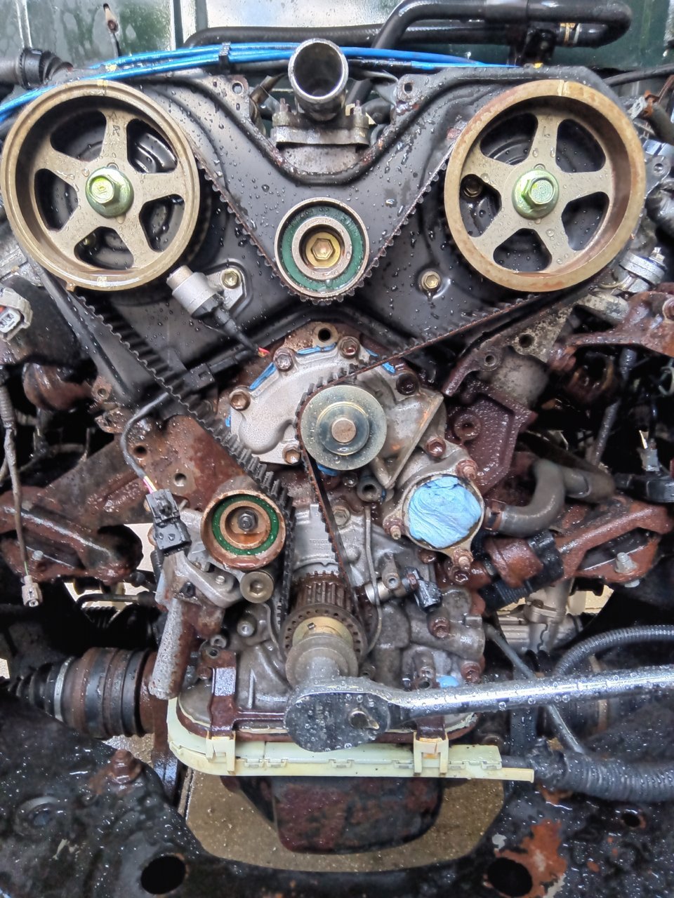

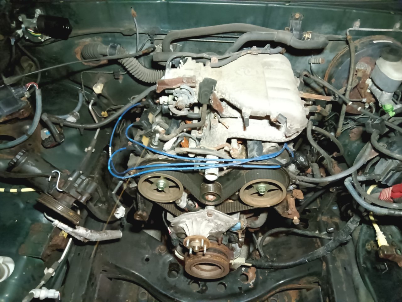

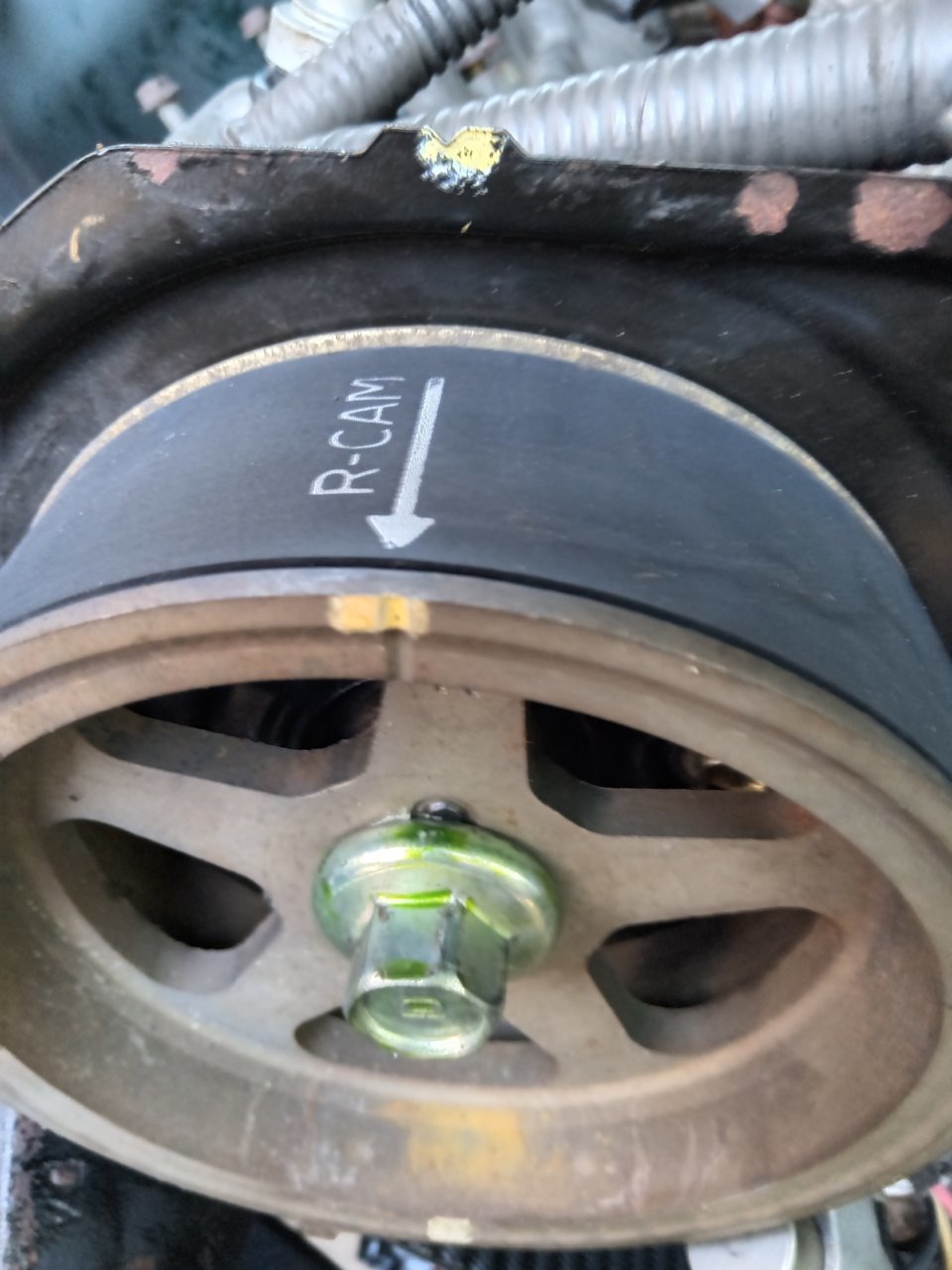

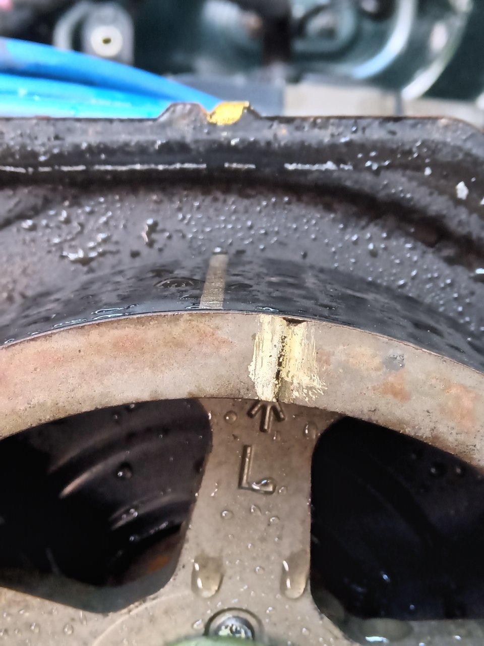

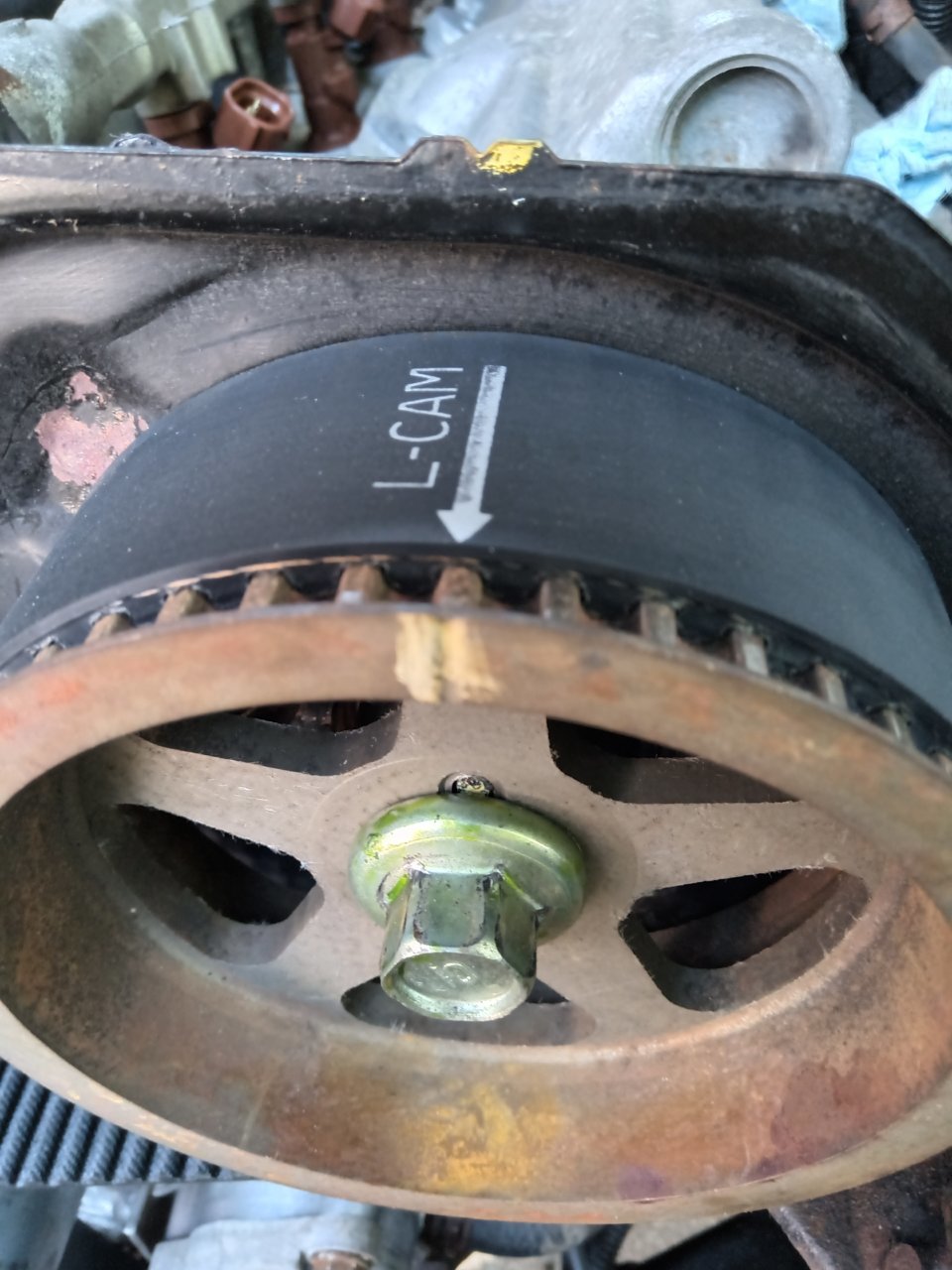

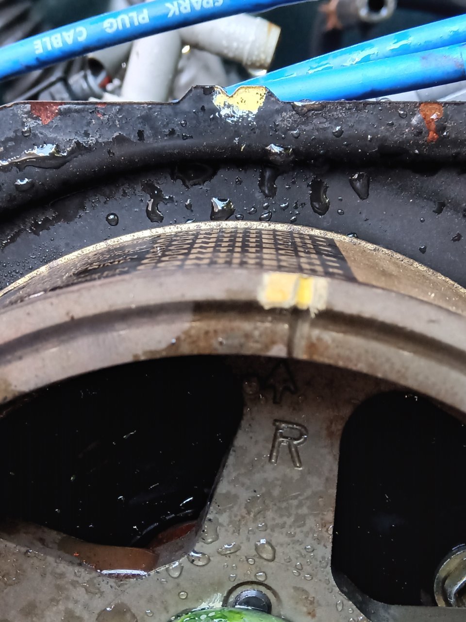

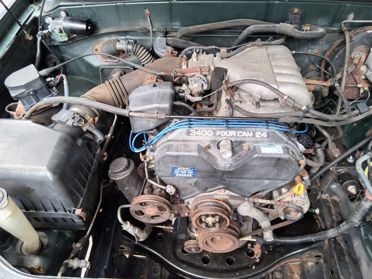

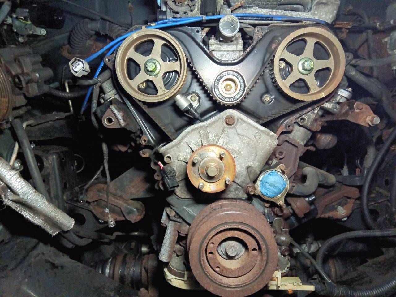

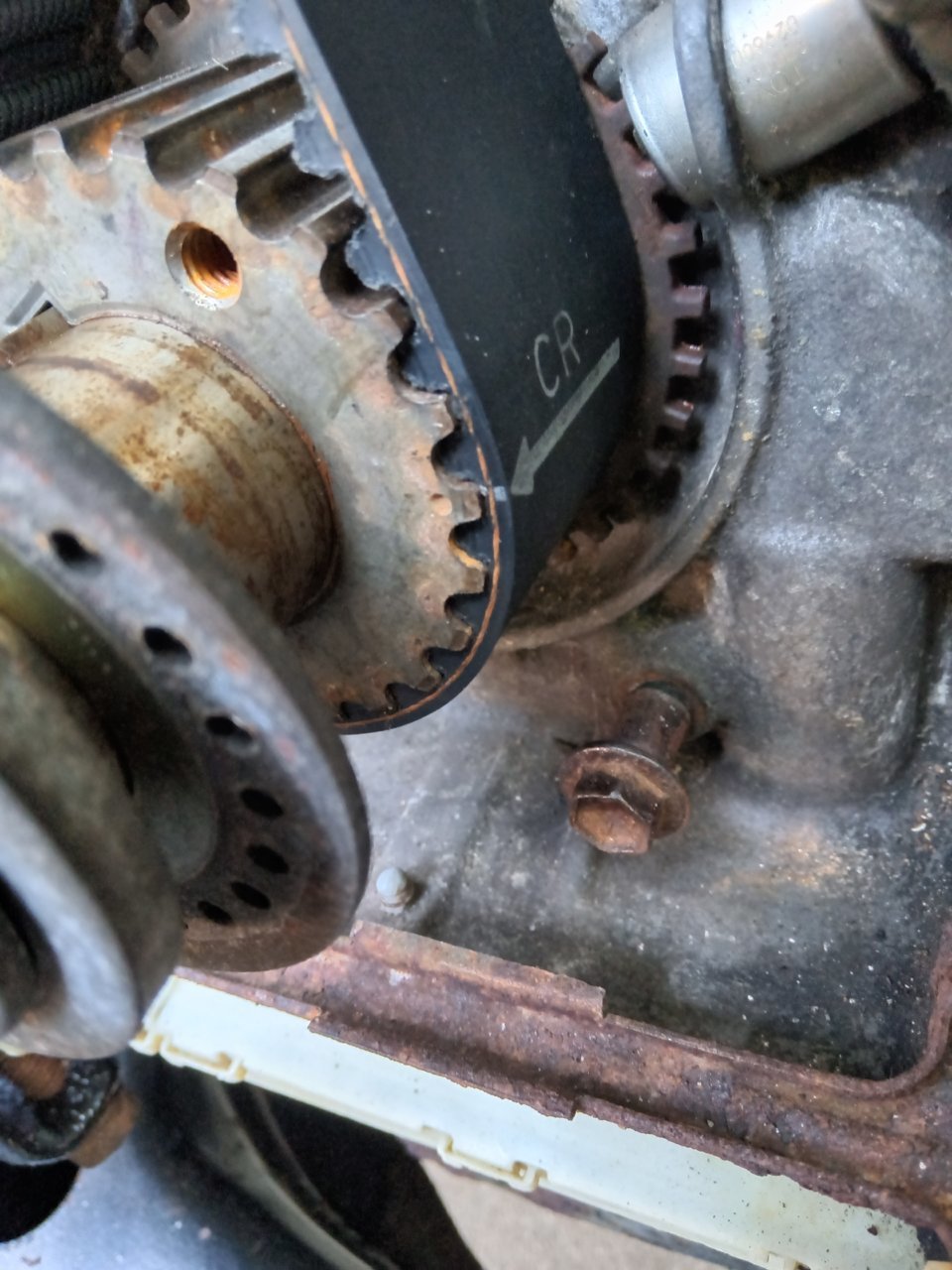

    This is where I'm at with the 3.4:
    I'm about to remove the old belt, gears and seals.
    I have the crank lined up with the mark and this is where the cams landed...
    So my question: is the motor at TDC on the compression stroke? Is that necessary for it to be on the compression stroke? Everyone I've heard for this motor and job just says line the 3 marks together... Am I good here or what?
    2nd is, are the cams off one cog or is the belt stretched what's the deal here?
  10. Jun 13, 2023 at 11:12 PM
    #250
    Winning8
    Winning8 New Member
    Jul 4, 2019
    #32819
    2,039
    Da Bay Area
    2019 MGM DC 4x4 SR5
    Mumba 18x9 ET 12, BFG KO2, FOX suspension, diamond back HD cover w/ rack, LED head & fog light bulb, TRD rear sway bar, timbren enhancement, RAS helper spring, avs auto shade, Carhartt front seat cover, bench seat cover
    Compression cycle is the TDC, Find TDC have to look at the intake and exhaust valve, when piston going up, both should stay close.
    If it’s still show the same, maybe the guy before install it wrong, off a tooth is not end of the day, just put it back on the mark.

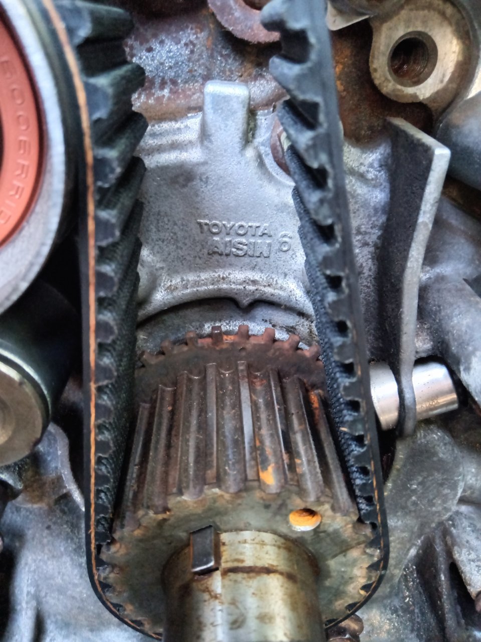

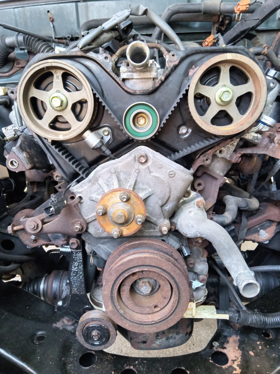

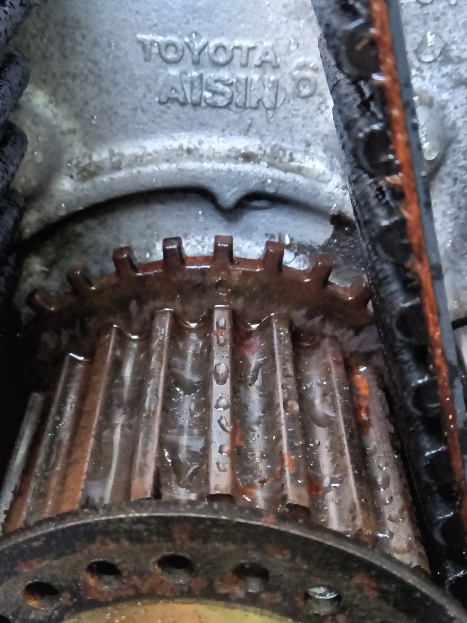

    Gettn to the cam and crank seals

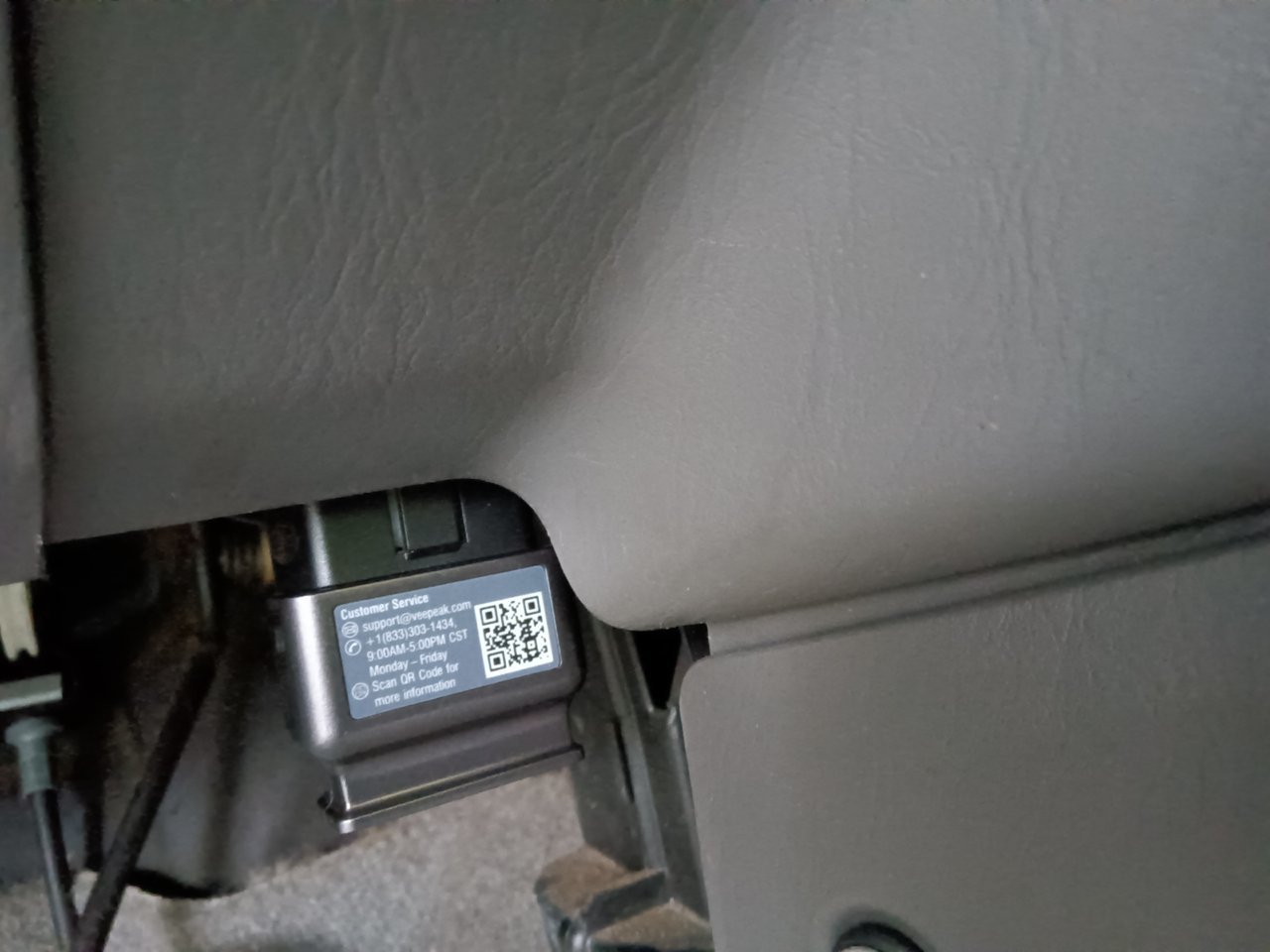

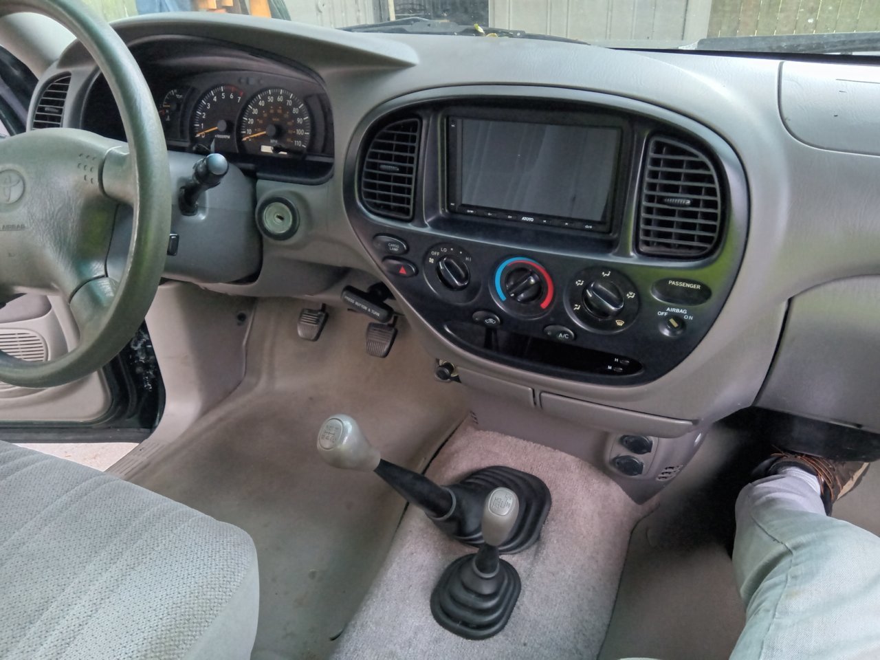

    Double din w/Bluetooth OBD reader
    The Black Mamba, bmf4069 and Winning8 like this.

    OMG it's a stick shift...:bowdown::bowdown::bowdown:

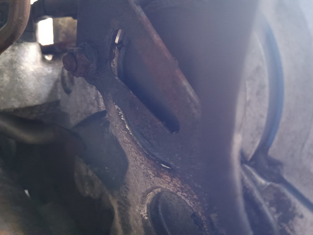

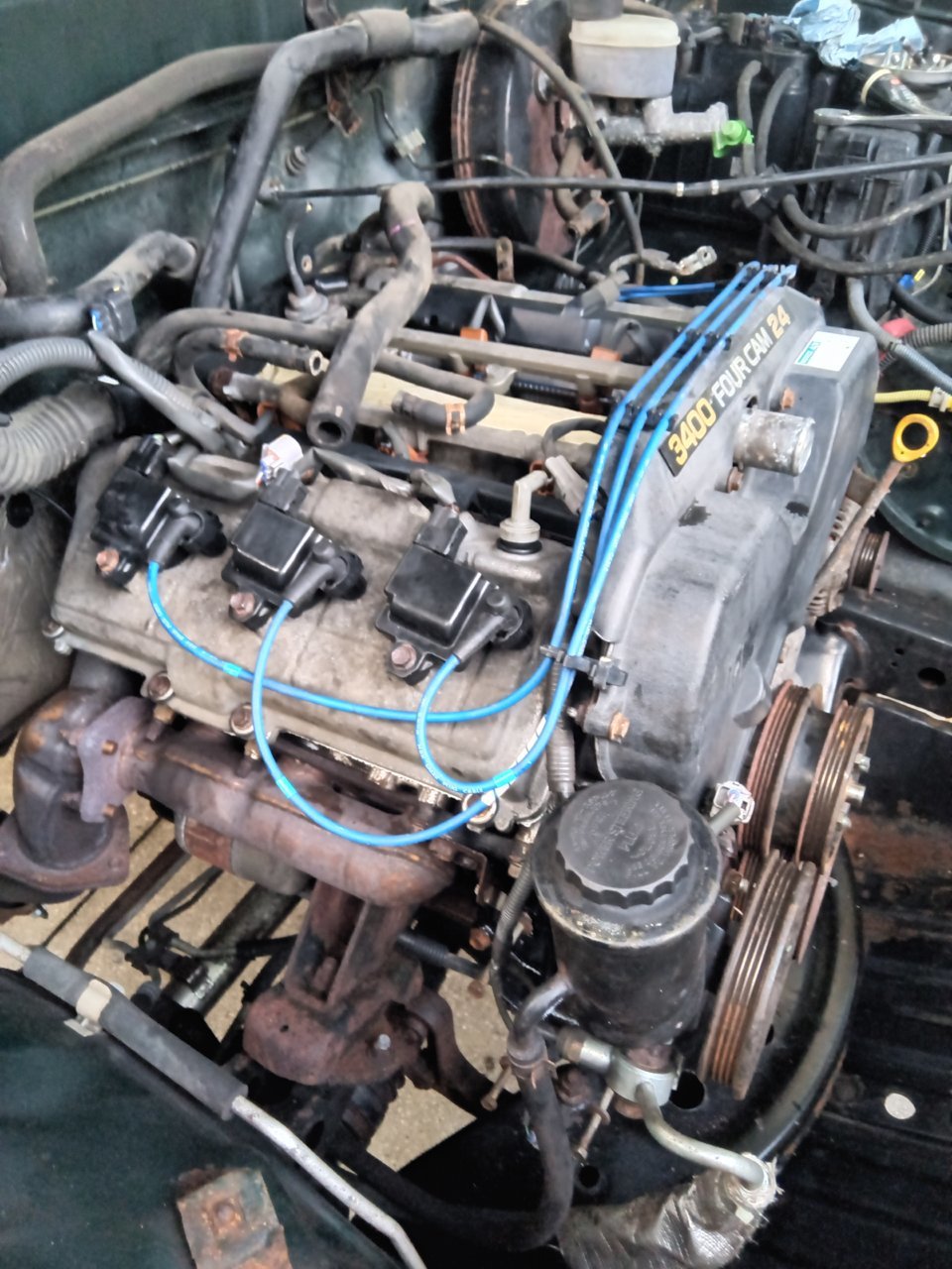

    When doing the valve covers, are you guys putting rtv on the cam plug?
    And why did Toyota put this bracket on back here? What does it do?
  18. Jun 18, 2023 at 8:40 PM
    #258
    Mr.bee
    Mr.bee King Turdra
    Jun 4, 2022
    #79178
    6,423
    SATX
    '02 AC TRD
    I dont know if there are different 'grades' of the toyota FIPG, but i'm pretty sure thats what people use.

    Be careful leaving the reader plugged in all the time. Two main issues reported by others:
    1. Parasitic drain: There's a constant-hot lead on OBDII
    2. Bizarre CELs and other gremlin-like behavior
    Doesn't seem to be model-specific, but has been reported here a few times now. Dead batteries in the AM, tied back to the unit. Check engine light with weird codes, all disappears when dongle is removed. YMMV, just seeding this in case you encounter the same.

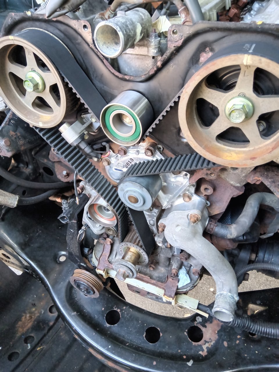

    AC 2001 5spd 4x4 V6

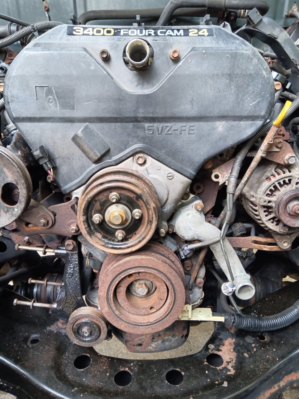

    Moving along
    Put in new cam and crank seals.
    The tensioner pulley was bad and the tensioner arm was siezed up. Good thing I did the timing belt.

    AC 2001 5spd 4x4 V6
    Yes it appeared to be one cog out of place.
    I also found 3 cracked vacuum hoses which were for sure leaking.

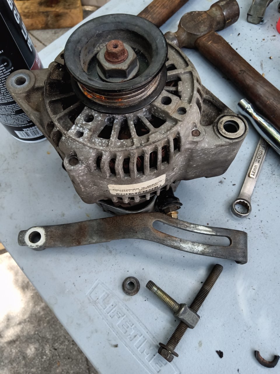

    Made a trip to the scrap heap and grabbed a new alternator and brackets
    shifty` and w666 like this.

    You gonna go ahead and swap in new brushes etc. while you've got it out?
    bmf4069 and Bmktw2[QUOTED][OP] like this.
