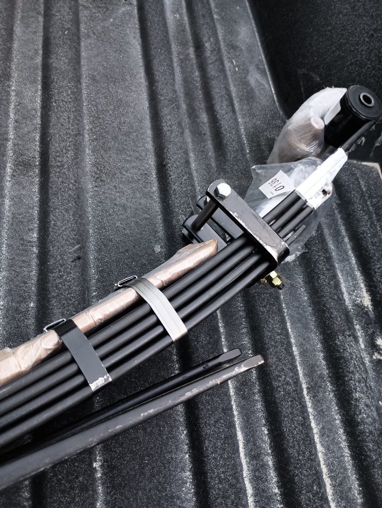

    I ordered this HD leaf spring setup yesterday desiring an increase of capacity weight to include the fiberglass topper and supply.

    If you think about it, take some before/after measurements. Just curious to see what you end up getting.
    The forward driver side mount is probably the only difficult fastener. When hanging your spring, if doing it solo, or even if not, I found using the OEM bottle jack to be a lifesaver to incrementally lift/hold the spring so the bolt holes line up. Maybe a helpful protip if you haven't done yours yet.
    Don't forget to remove your lower shock bolt, helps a ton with axle travel.

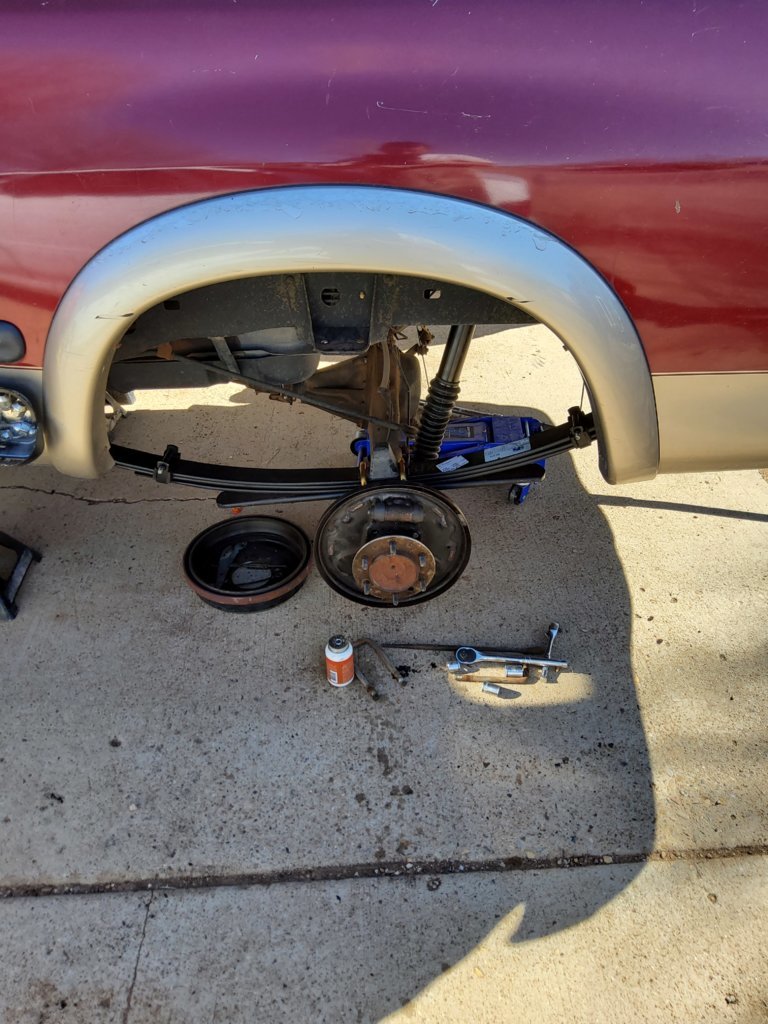

    I just put the same springs on today. Went surprisingly well. Torque wrench bit it on the third 125 ft/lb hanger/shackle bolt so I had to guess the rest until I buy a new one.
    When you get them, make sure the shackles are installed on the right end of the spring pack. I put new shackles on mine so I can't say for sure I didn't mix them up, but I'm pretty sure they came with shackles installed on the short end of the leaf, rather than the long end. Confused us a for a few minutes.

    To avoid this, I used a paint pen to mark an arrow pointing forward on the forward-facing end of the OEM leaf pack.
    When I pulled the leaf pack, I put the ATS and OEM leaf packs side-by-side so the long/short ends matched, and moved over the hanger to the ATS pack.
    Then reinstalled the leaf pack; for good measure, I marked the new leaf pack with similar arrow pointing forward b/c I can be a mindless dumbass at times.

    Luckily we caught it when there were only two shackle bolts installed, and only snug, not torqued. This time was way better than when I did them on my Tacoma. Having a friend helped, but also, there were no real issues. All the bolts came out no problem with the impact wrench, minimal wrestling to get the new bolt holes lined up. Less frustrating all around than I remembered the job being.

    Funny. We noticed there was no way the alignment pin on the leaf springs was going to reach the hole on the axle. "Either I bought the wrong springs, something else is weird here..."

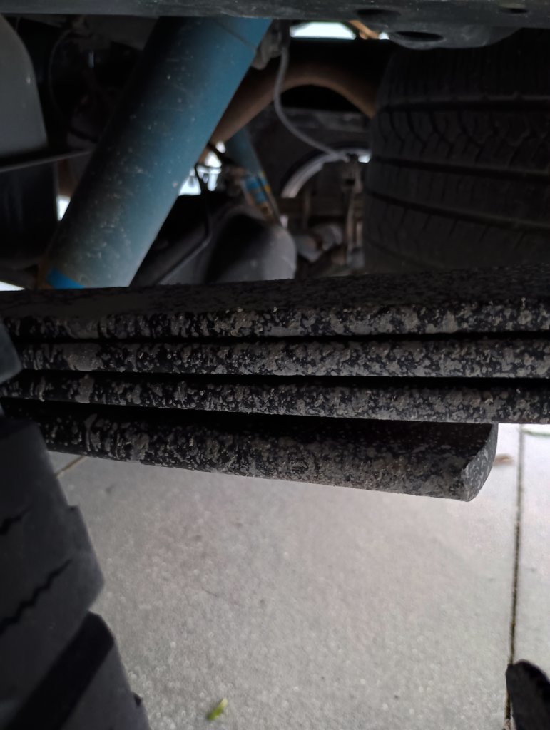

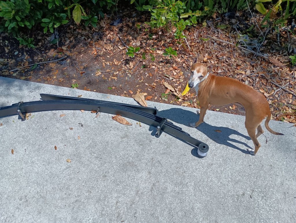

    New ATS heavy duty 4 leaf
    Original equipment soft 3 leaf
  22. Mar 30, 2025 at 1:33 PM

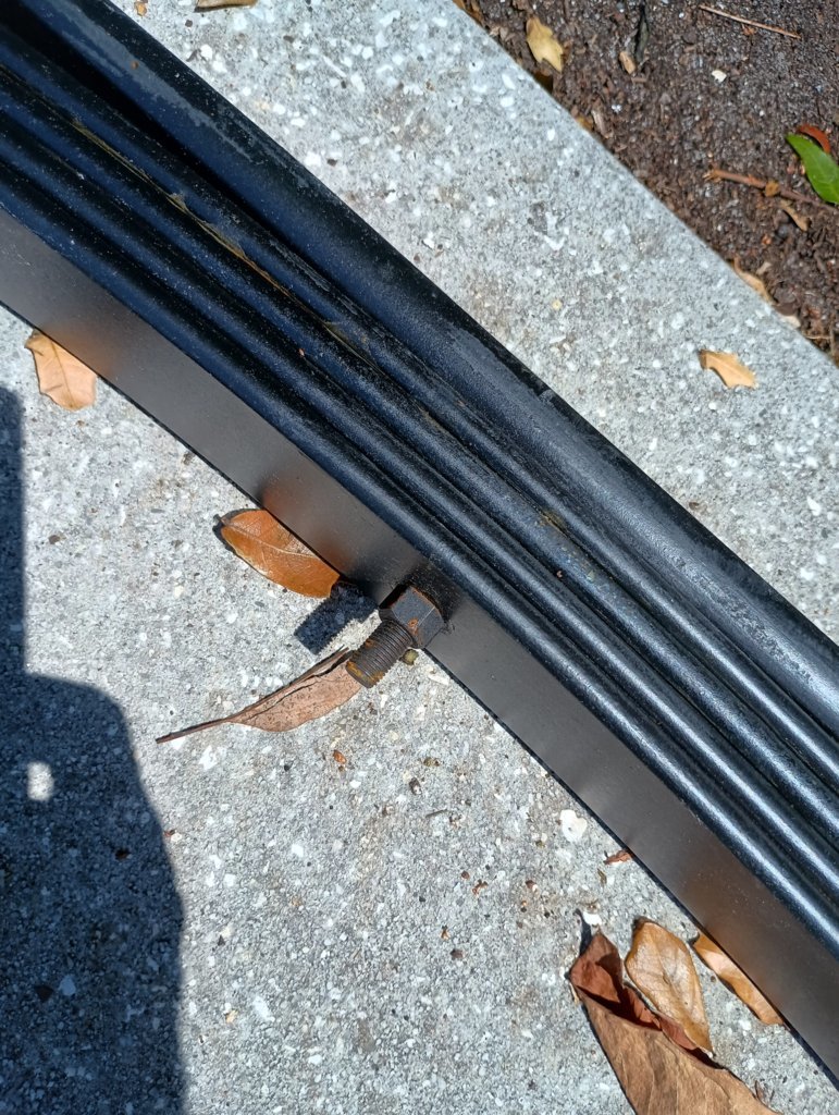

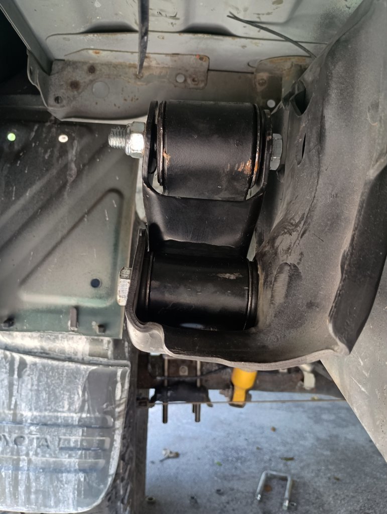

    The bolts have to be installed in a certain direction or else they don't fit or get stuck behind the Reese hitch.
    Then you have to cut the bolt short that goes under the bump stop.
    The truck lifted a little bit but I'm really happy

    Looks great! Yep, we had to cut that center bolt, too, but since I replaced my stock bump stops with Sumo Springs, I wasn't sure if that was the reason.
    With the 3/4" lowering shackle, I think I got almost no lift at all. It definitely raised the back end from where it was sitting due to completely worn leaf springs, but I don't think I'm much higher than stock.

    I also wanted to mention that the bolts on the shackle have to be installed a certain way. Anyone installing new leaf springs, note the image I have shown of the bolt orientation.

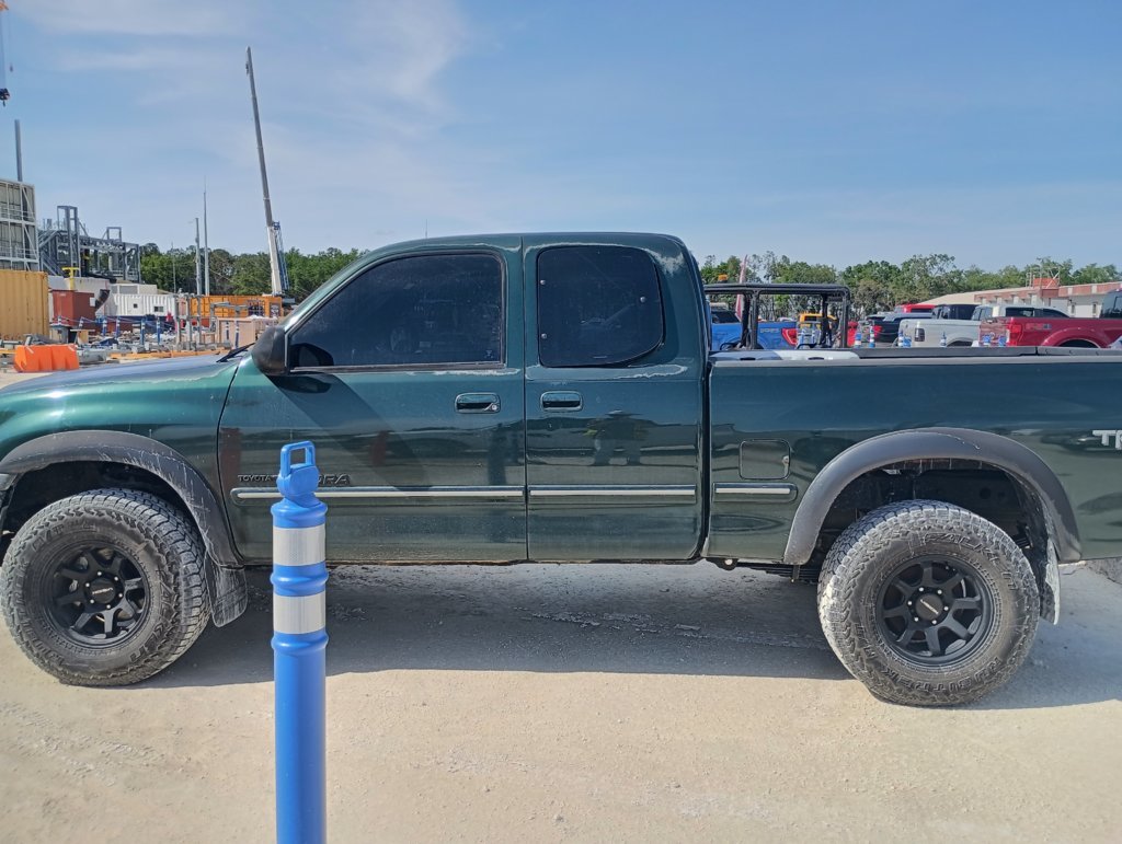

    Here is where I'm at right now. Empty tank of gas and fresh springs installed yesterday. Once I get a full tank and the springs settle a little it should be fine. The ride is definitely a bit firmer but I believe it really needed it so I'm happy. Would recommend to anyone on the site to get these springs especially if you have a topper or use a trailer.

    Yeah looks great. I agree, they feel good. I've been driving a lot of dirt roads that are pretty trashed as winter starts thawing, and I love the way my suspension feels.
