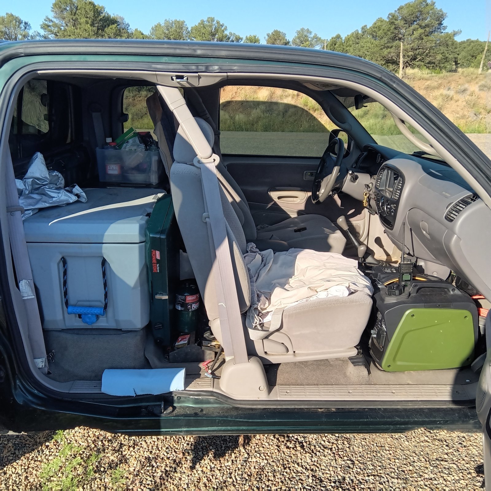

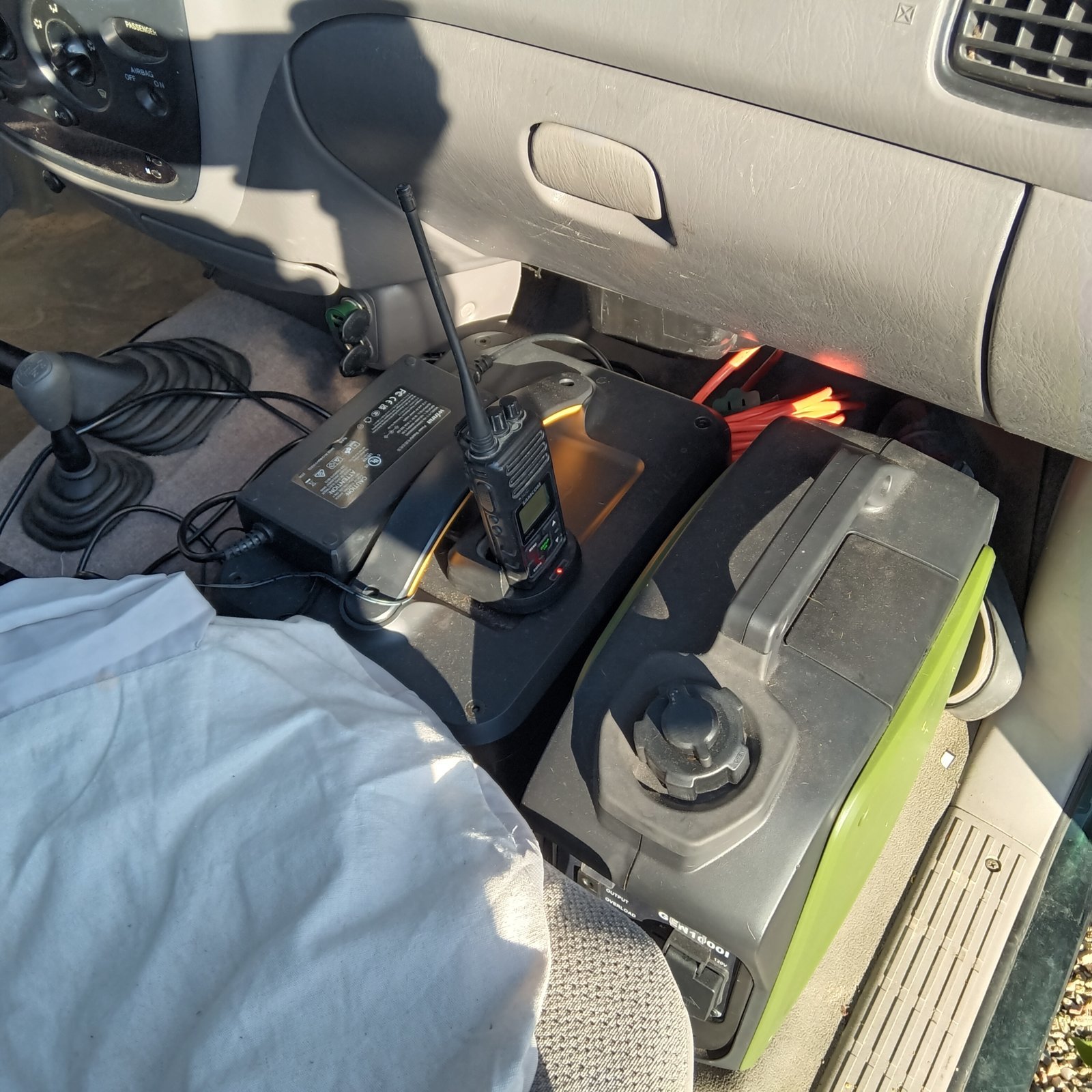

    Here's the working setup loaded up and still organized.
    Inside the cab I have a tool tray , cooler, gas generator, extension cord, solar generator with battery power, clothes tote, cooking drawer, and basic welding tools.
    In the bed of the truck I have a foam 3" memory foam pad on top of a carpet that covers the bed.
    The box fan is crucial for keeping cool and flying bugs away.

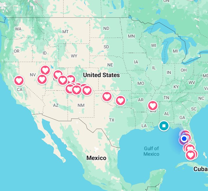

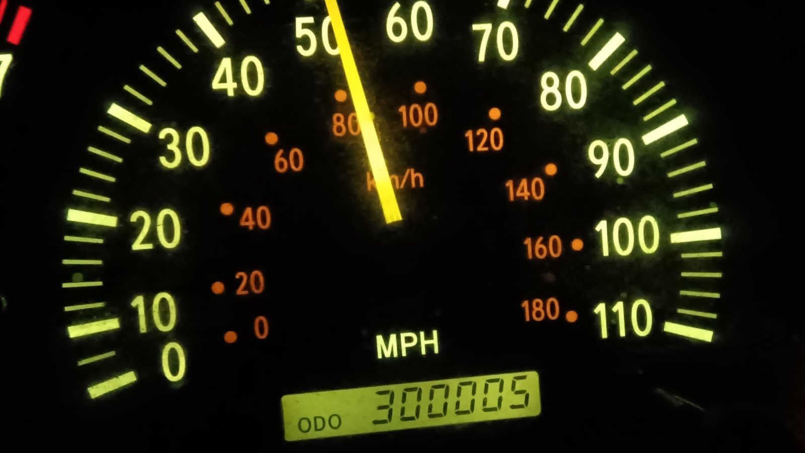

    Hit 300k on my way back to Florida.
    The total trip distance was 6,524 miles
    I spent $3,000 total expenses by camping in the truck.
    Was able to save the best FREE truck-camp locations all along the way to Cali
    I do have to admit the truck needs a more heavy rear leaf pack to carry the weight of the topper and supplies but did great anyways. The tundra has a large capacity fuel tank and can run for a good distance. Was nice when crossing the desert.
    The manual transmission worked nice when in the mountains. The 3.4 also did excellent. I kept the RPMs at 3k and it could do most any incline. The upgrade WL cast brake calipers did excellent. I am extremely pleased with the comfort, reliability and performance of this truck.

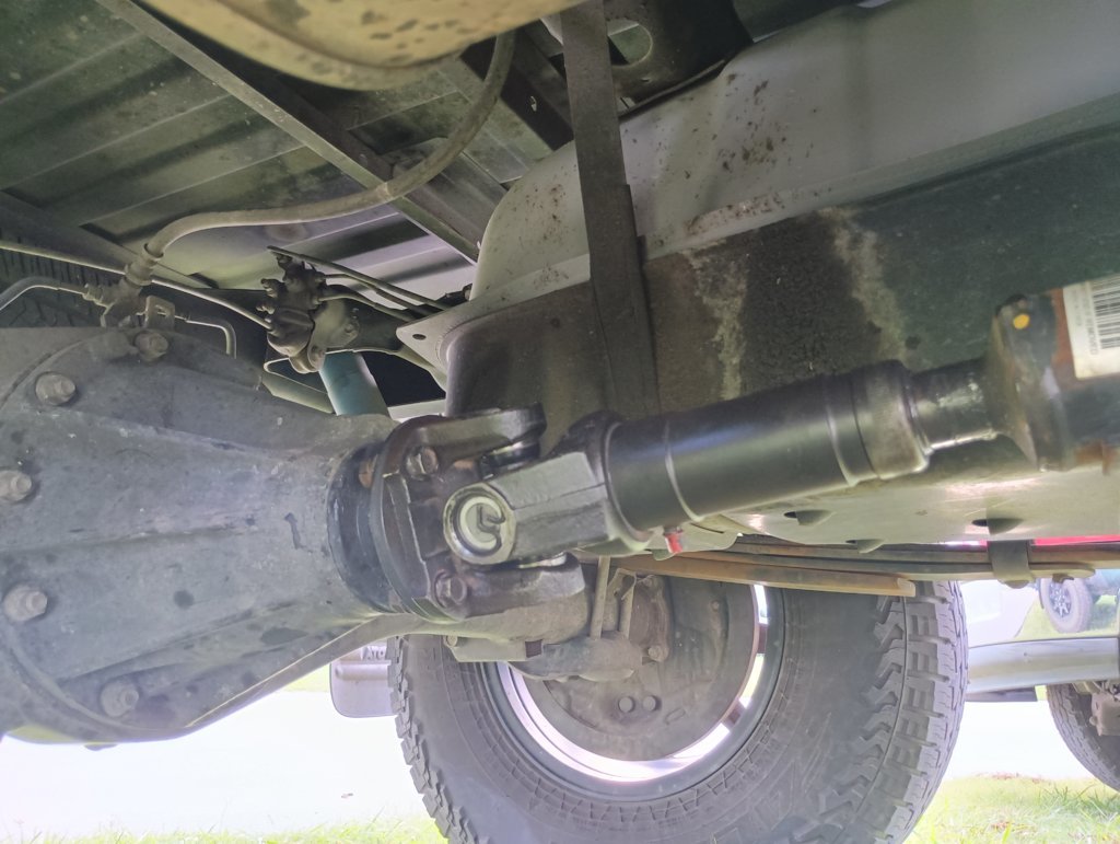

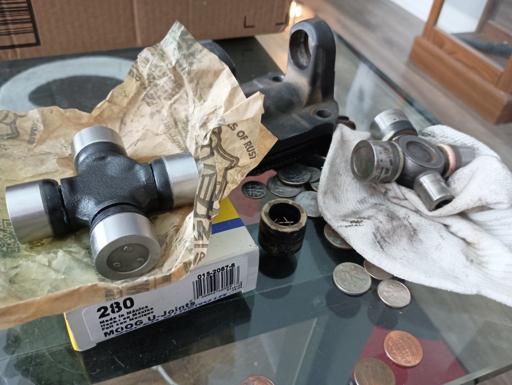

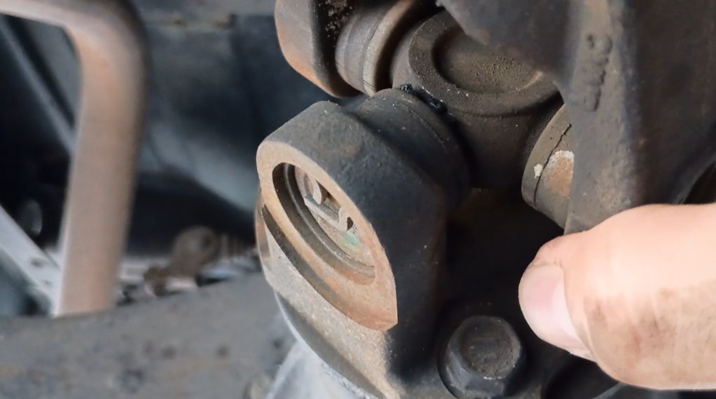

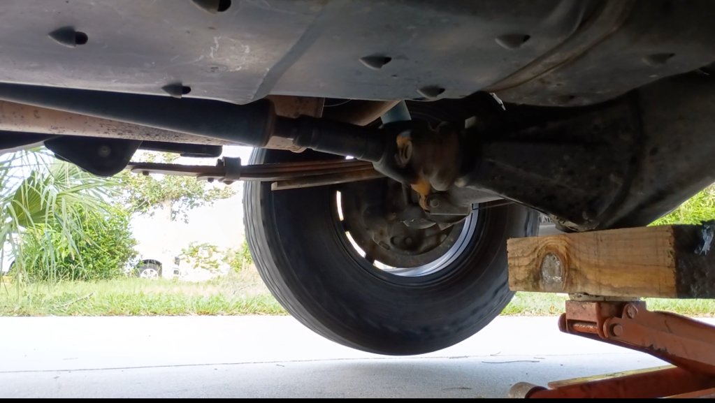

    Well at about 30k miles a u-joint is having an issue... I disconnected the driveshaft and spun the axle , it still makes a clunking clacking sound like a bad bearing race...Been hearing a roar at 70mph so I think there's a couple problems but going to tackle the u-joint first

    You're not saying a U joint failed with only 30k on it right? oem part?
  23. Sep 29, 2024 at 12:43 PM
    #713
    Bmktw2
    Bmktw2 [OP] Yard Dog
    May 16, 2023
    #97109
    473
    Nic
    AC 2001 5spd 4x4 V6

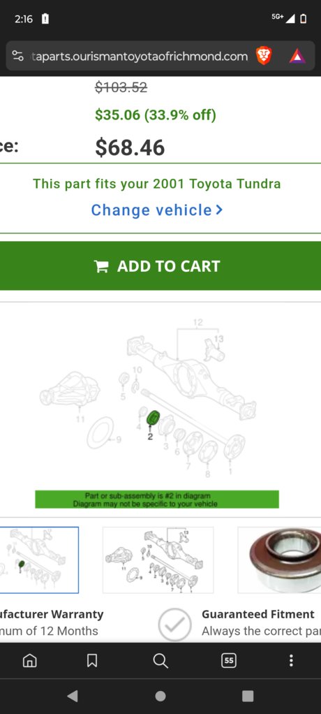

    Doorman u-joint.
    Still have a sound coming from spinning the axle with the driveshaft unbolted. Going to see if I also need an axle bearing...
    A replacement...
    Final product fit excellent. The truck is driving much smoother now
    I ordered the axle bearing puller tool in case I have to replace the axle bearing.. man these bearing are expensive

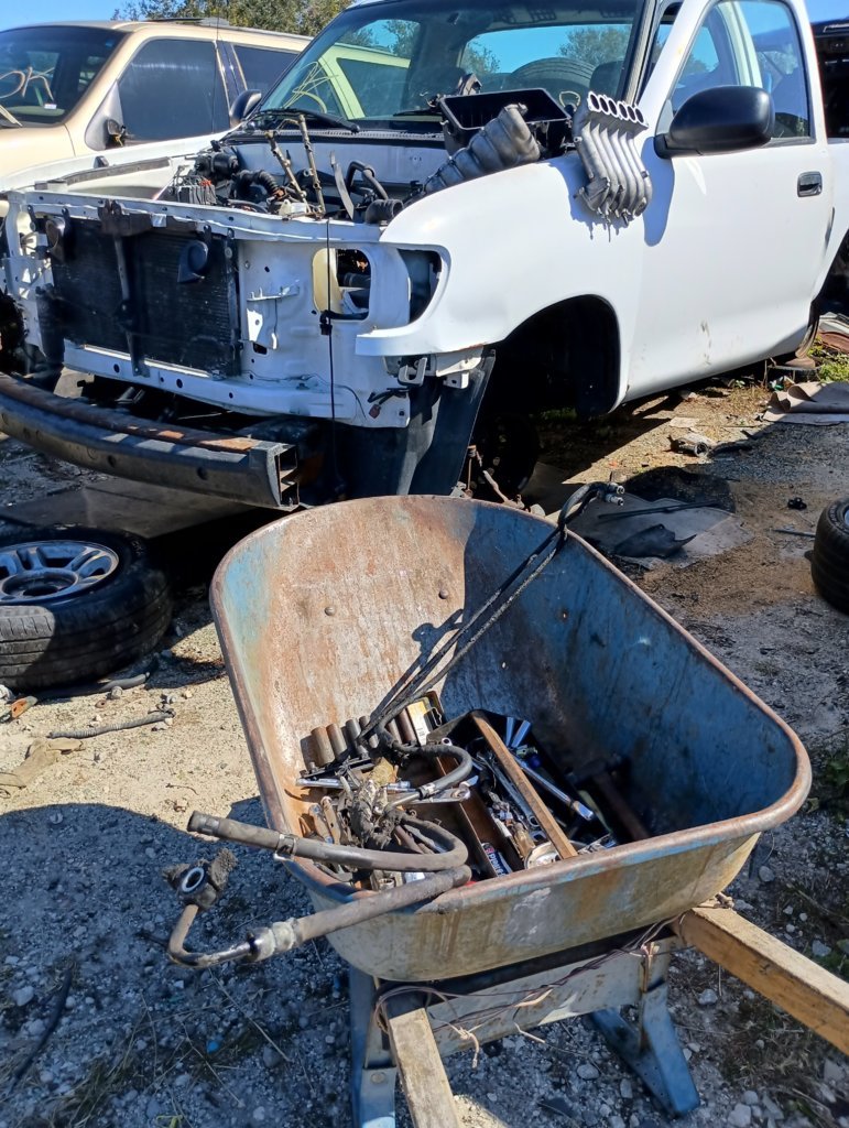

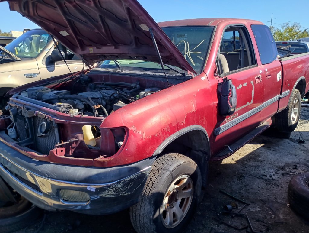

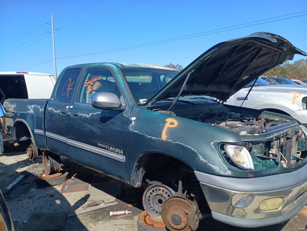

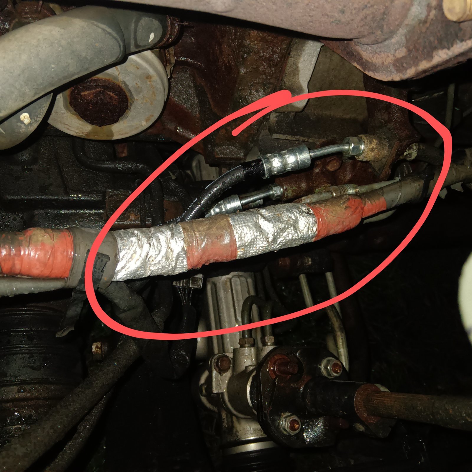

    Well the hose spring clamp rubbed a hole in the power steering line and caused a leak on my truck...
    Here I found a nice replacement:
    Decided to post the other trucks I found in the yard while I was there for your viewing pleasure

    Pressure hose is not that expensive. Why not new?
