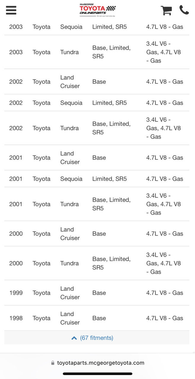

    That looks normal to me. Will that part fit a v6? Looks like it's only for v8s.

    According to the McGeorge link I posted above, yes it does, as in many years and models. If you go to that link and select “What it Fits”, you’d see it fits 98-22, V6 and 8, Sequoia and Tundra.
    As for normal, there is no “normal” when it comes to our 1st Gens, speaking of fully warm at idle, IMHO. We’ve seen any where from almost at bottom line to quarter mark. At end of day it’s an idiot gauge.
    sample pic starting at bottom of list….

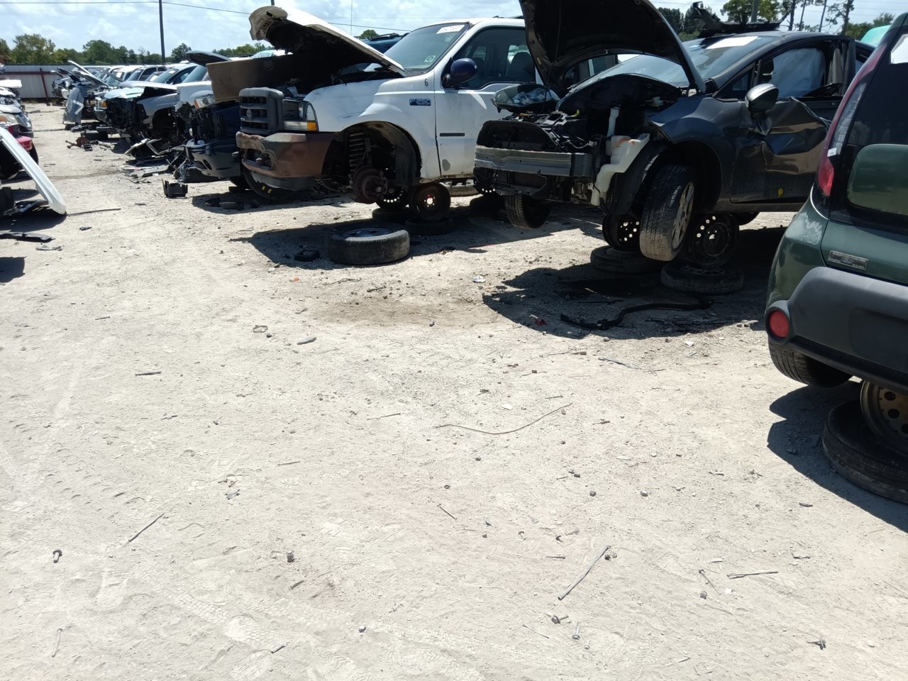

    Went to the yard in Bradenton yesterday an hour away to do some shopping on the 2003 and 2002 Tundras they had over there.
    I found the back two pieces of trim moulding I was missing on the bed and a nice new air filter box with all good clips.
    Since I bought some double sided tape to stick the trim moulding, I decided to paint the emblems flat black and reattach them to the truck.

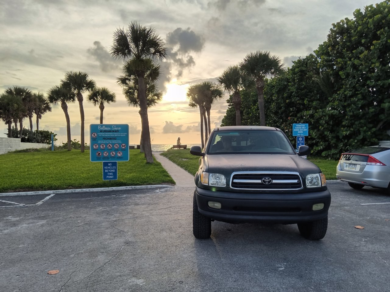

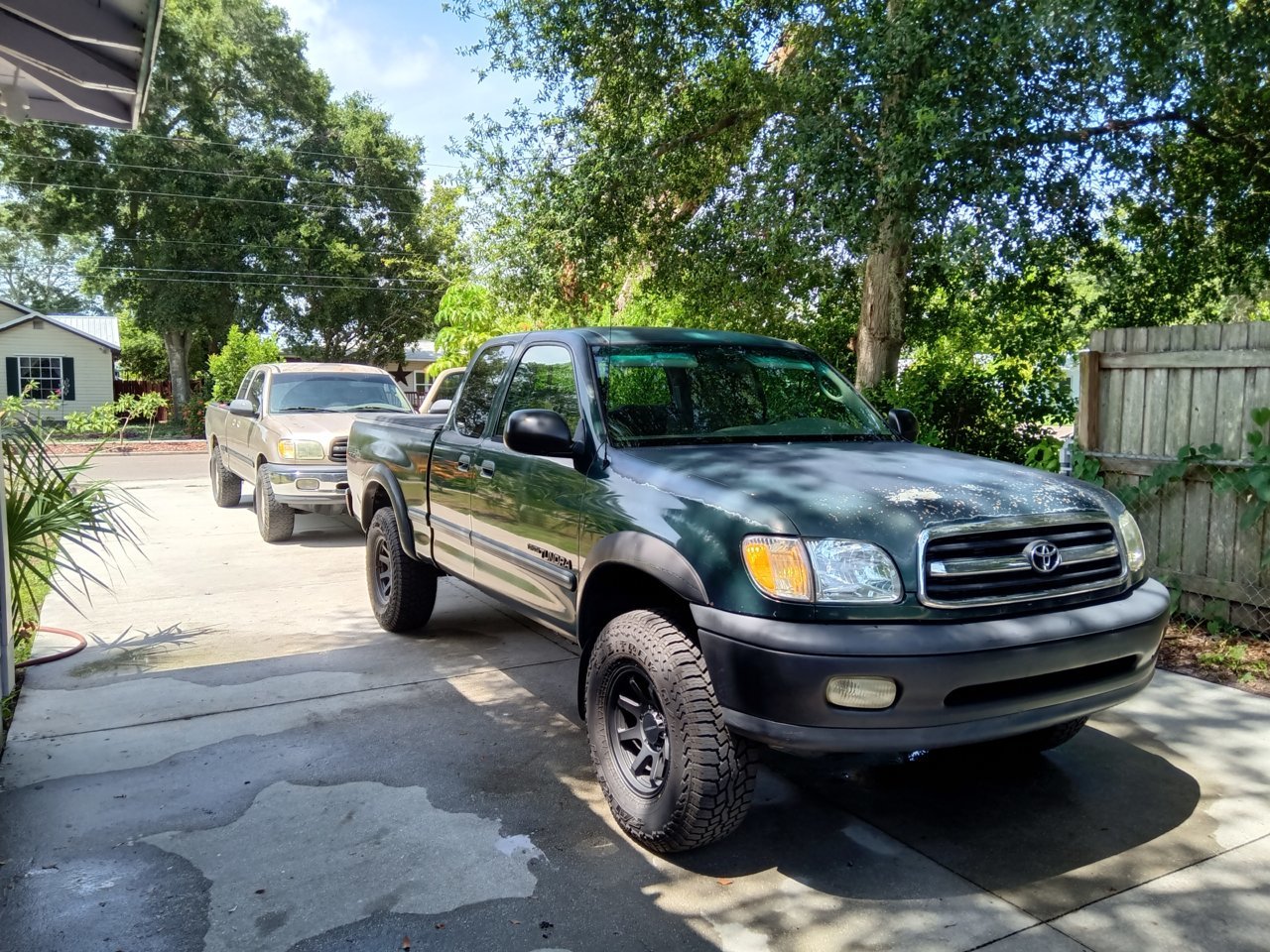

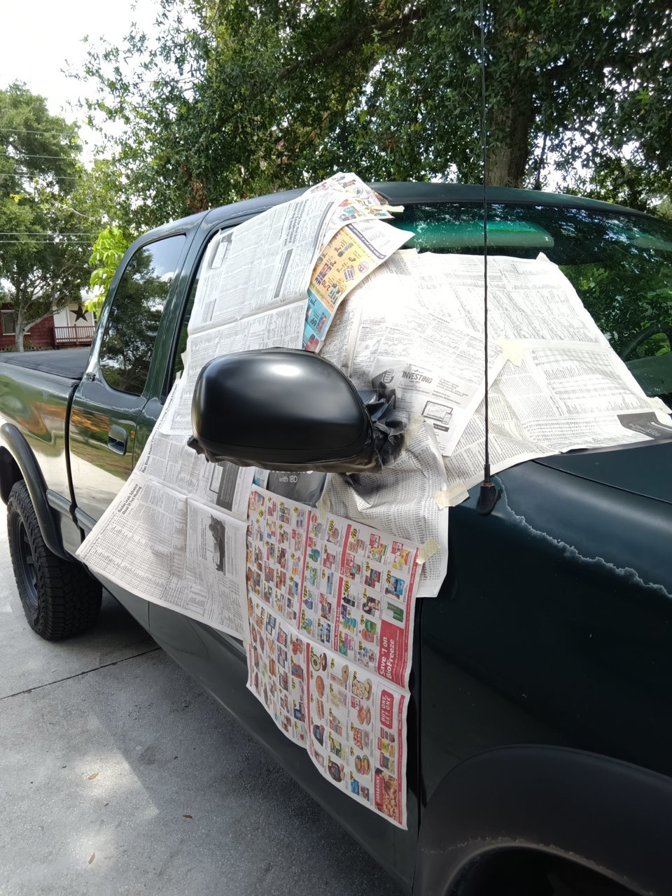

    Plasticoat
    Finished with the plasticoat right when my buddy showed up in his 2002.
    On the way to the beach we swung by the junk yard in Largo where I picked up a full-size spare tire and he got some window weather strips and some little tabs for the interior.

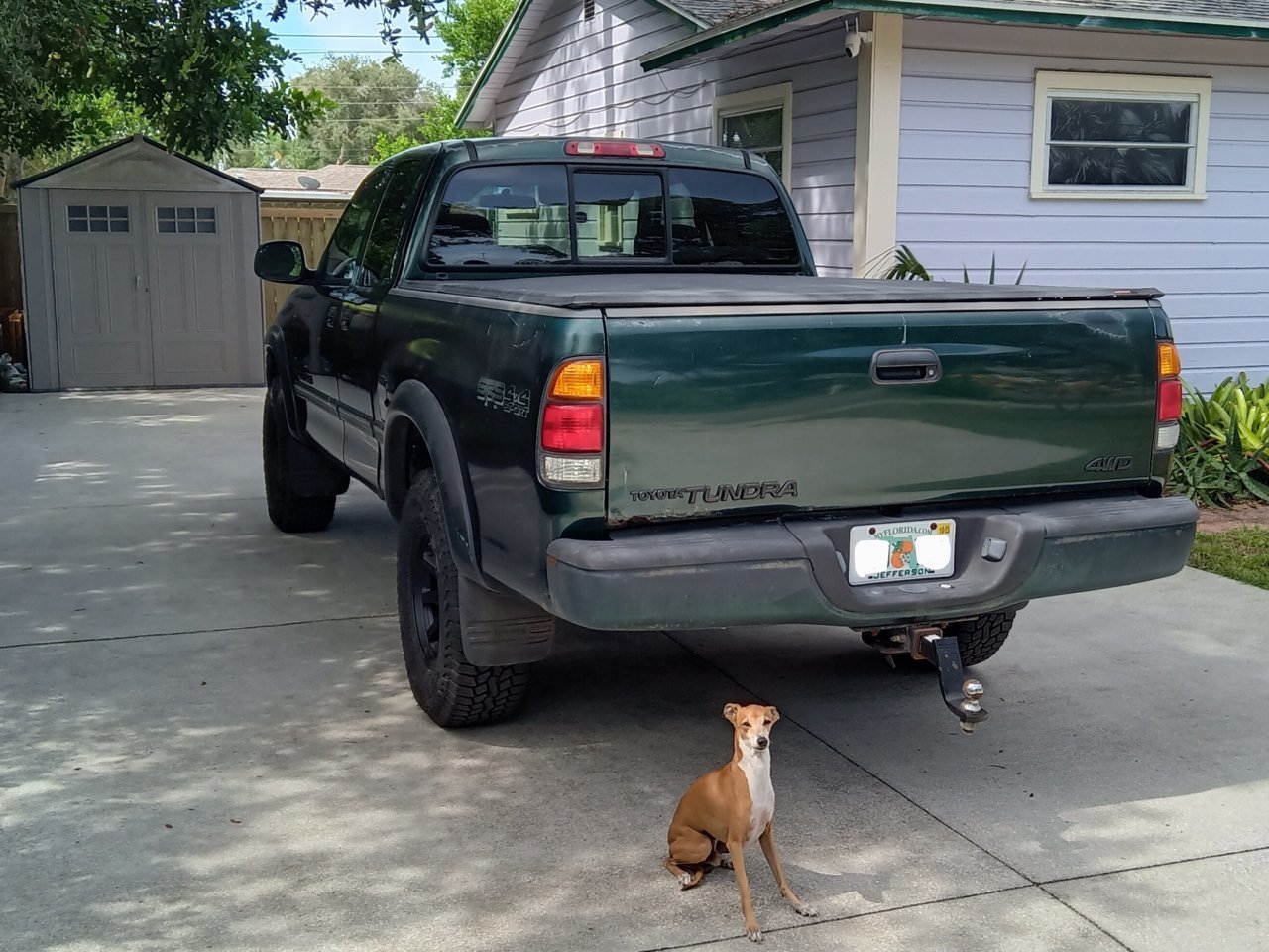

    Isn't it about time you introduce us to the pup, formally?

    Chainsaw cracks me up. He looks like a baby deer.

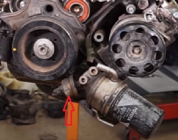

    Roughly where is this sensor? Easy to install?

    It's right in the front under the thermostat neck

    By the oil filter

    Well hot damn. I was just in that neighborhood yesterday. Amazing how much room we have to work once the radiator is out. Have your readings got more accurate since you replaced yours?

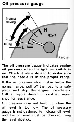

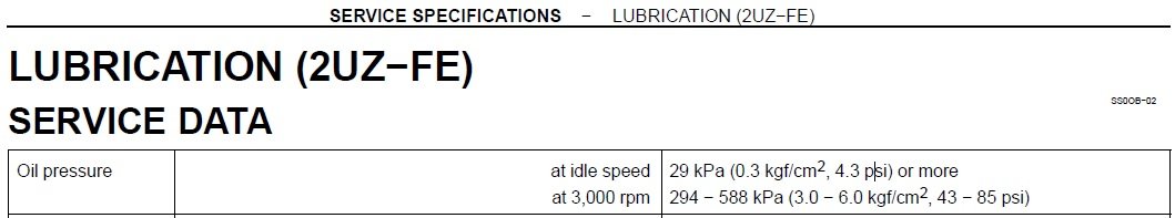

    As I mentioned initially, "when I change oil next". That said, I'm not sure I'll see a difference since mine has always ran at 1/4 mark at idle/warm and hangs about 1/2 way when driving.
    Pretty much what the owners manual and FSM specs shows....

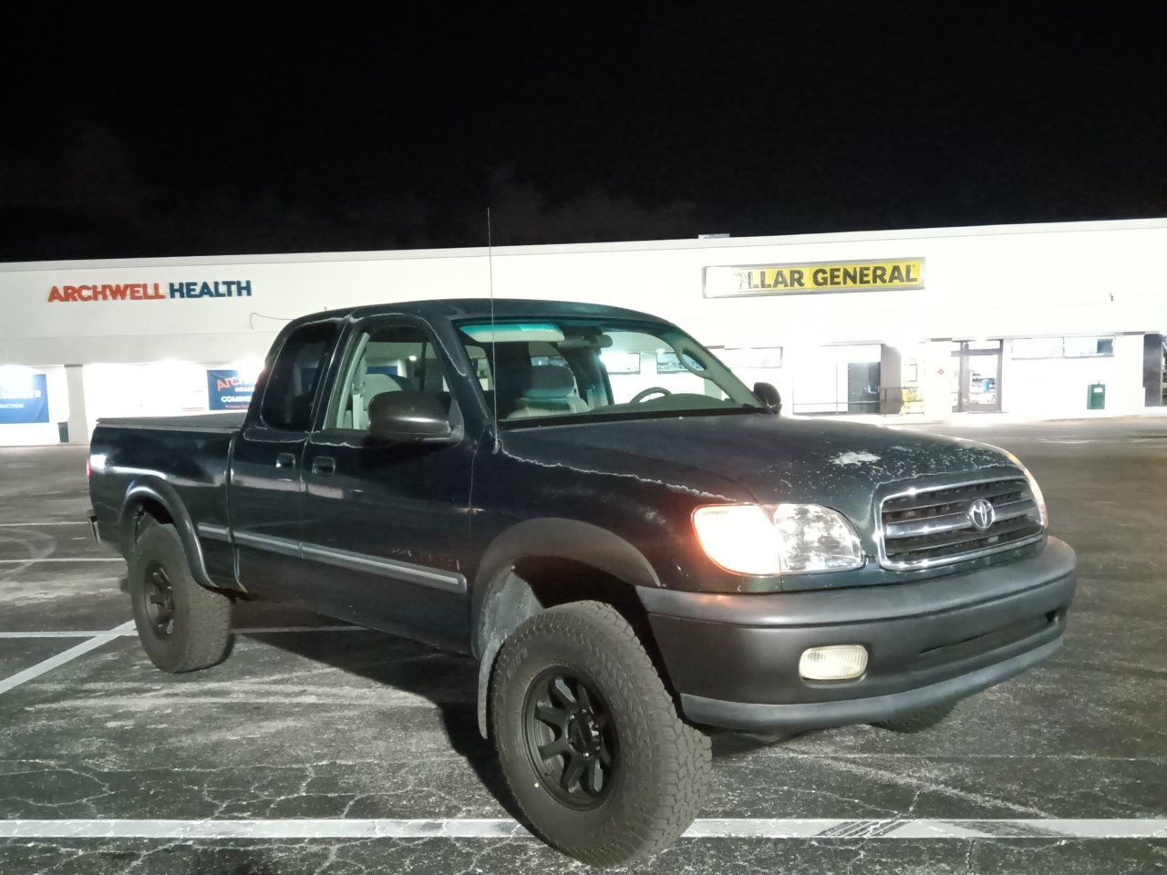

    You should paint the rest of your black trim. I did it to mine years ago and the fenders still look pretty good.

    Any plans to paint the hood and roof or just line-x the whole thing?

    "line-x"?
    I want to get the matching paint in the rattle can and fix the small spots as soon as possible...

    Just gonna leave the trim that's already black alone. Maybe get some back-to-black restore and hit it up with that...

    I'm thinking of doing the same to my mirrors. How did you prepare the chrome part before the Plasticote? And how many coats?
    Handy as you are, you might want to try a light sanding (~ 800 grit) on one of the small areas where the clear coat is burned through, and then a few coats of clear on top. If it works out, then you can tackle the larger areas like the hood and roof. Not only will it make it look better, but it might help prevent the color coat from burning through to the primer.

    To prepare the chrome on the mirrors all I did was scrubbed really good with soap and water with a sponge. I put one light coat, waited :30min , a second light coat, waited :30 then a heavy coat :30 and the last heavy coat :30 then removed all the masking and pealed the edges. Was really easy and turned out pretty nice.
    As far as painting the truck I have a rust spot on the roof that's through the paint and primer. Im thinking of doing what you say to that one spot and maybe a little to the hood. Not sure how much further I want to go with this cab and bed because it's so rusty so I'm kinda embracing the worn-out look here
