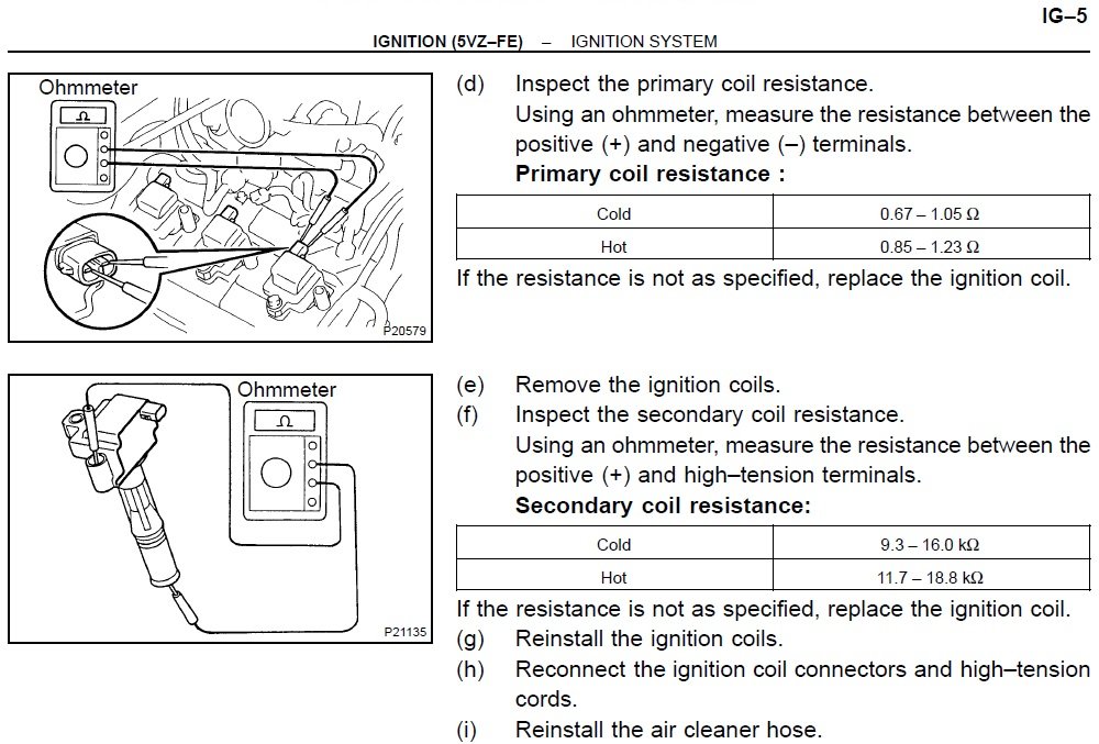

    Been awhile in catching up but kudos for where you are considering where you been....sweet job so far.
    Possibly moved on from this position but suppose you could test by having ignition coils in place and not replace 2 of 3 bolts and see result. According to EWD, that bolt passage does not appear to be used for a gnd connection.
    What you could do if you haven't already is to measure the primary/secondary resistance of the coils.
    Note to self: be cautious when pressure washing the engine bay !

    Okay so the bolt does not ground the coils...
    I have since thrown the old coils away but it's still good to know how to check them with the ohms meter. Thanks.

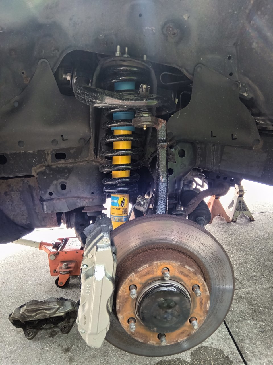

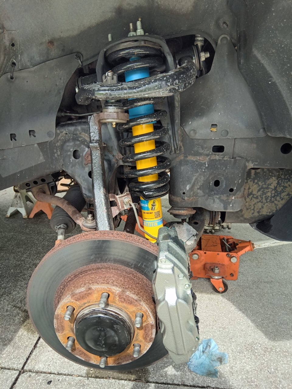

    The passenger side brake caliper was not releasing so I got two new calipers, pads and hoses installed.

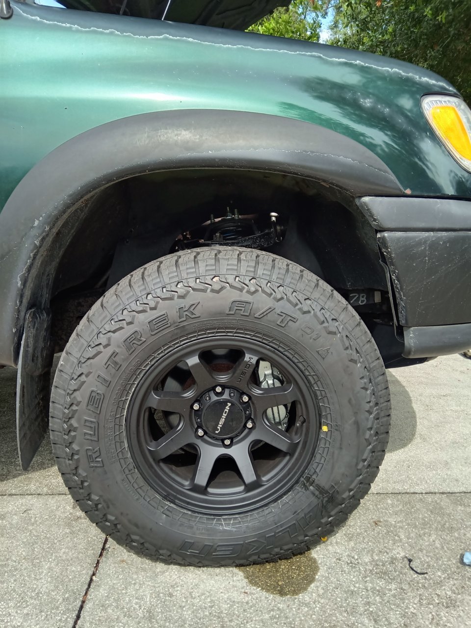

    Thats a low tire. I mean, you do you, i see the value of wearing the corners, then airing up for the highway, but damn, might pull a vacuum at dead center.
    dont mind me, the tires i want are gonna let me run 60psi.

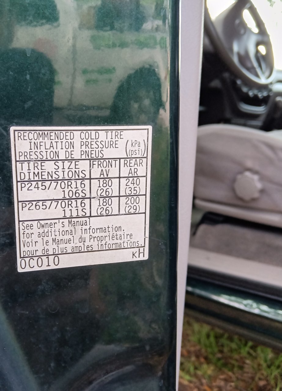

    I set them near what the manufacturer recommended @30psi front and rear
    I just got back from testing the truck on the interstate. Went 75mph was as smooth as can be. The rpms were at 2,500 @70mph in 5th gear.

    Just my input with those tires, assuming they’re P rated not LT, I would set them at 34psi. You can always do the chalk test to see what’s best. And like others have said, it’s been awesome watching your progress! Stick around, you could help out a lot of the folks with v6/manual questions.

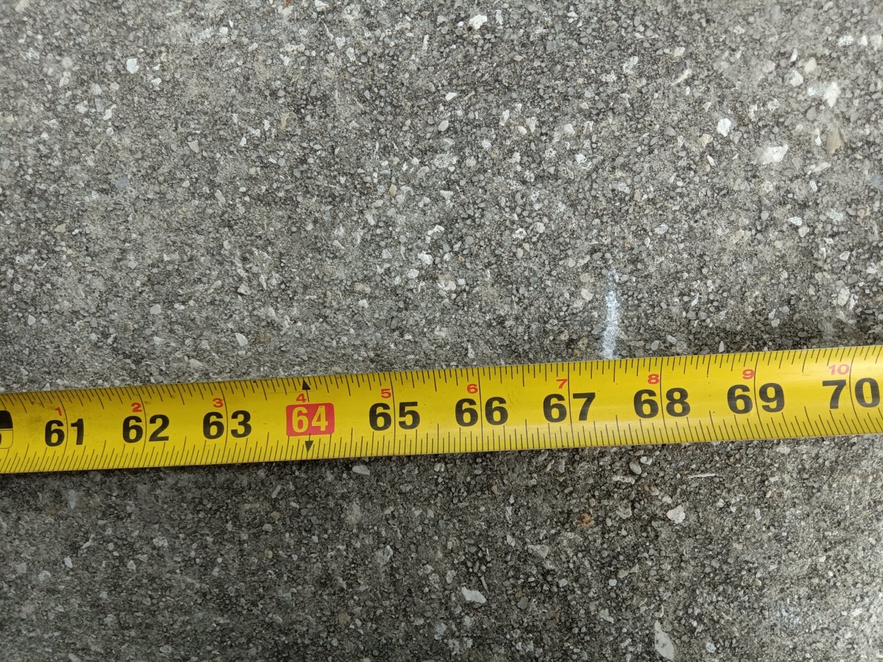

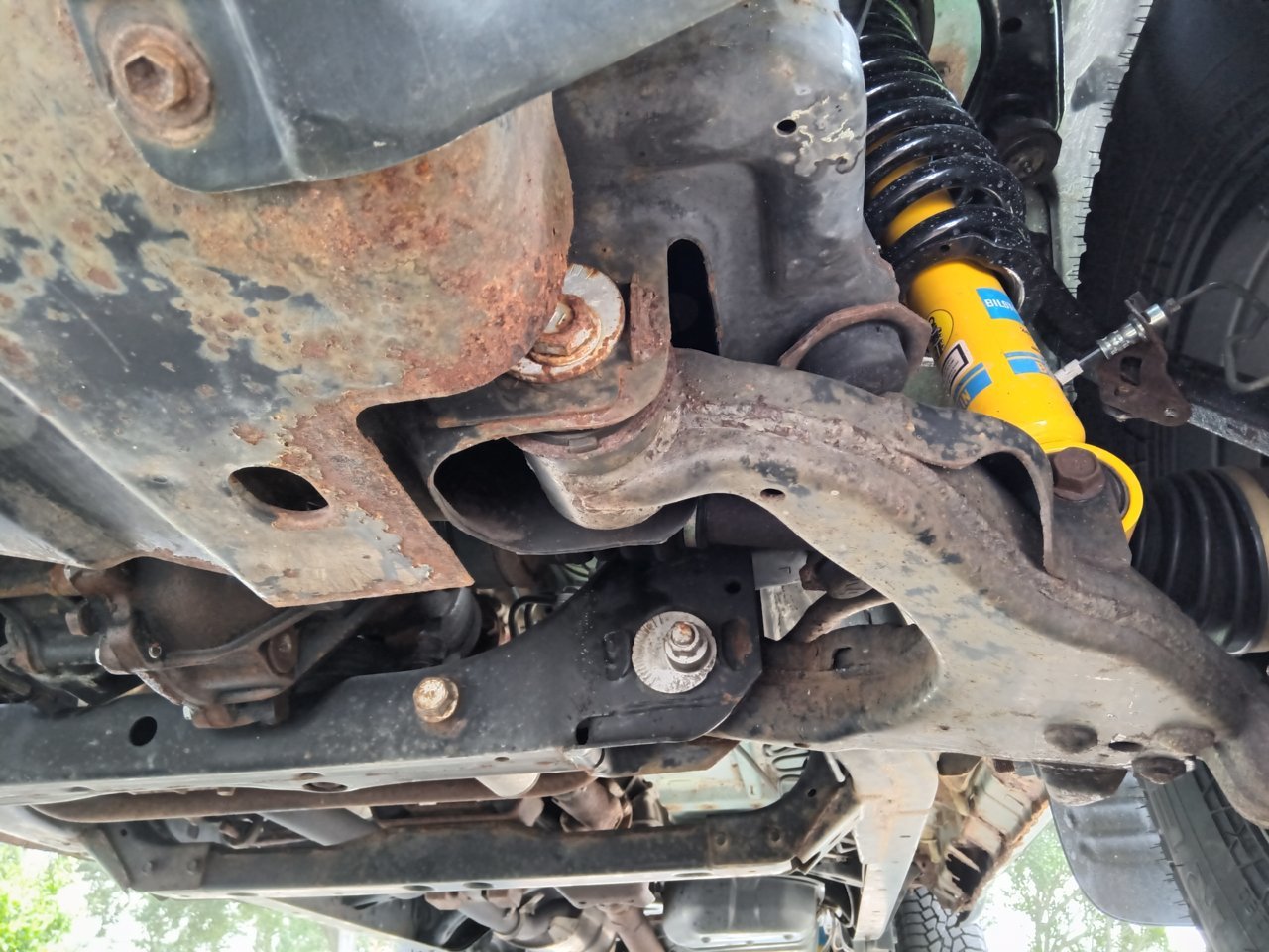

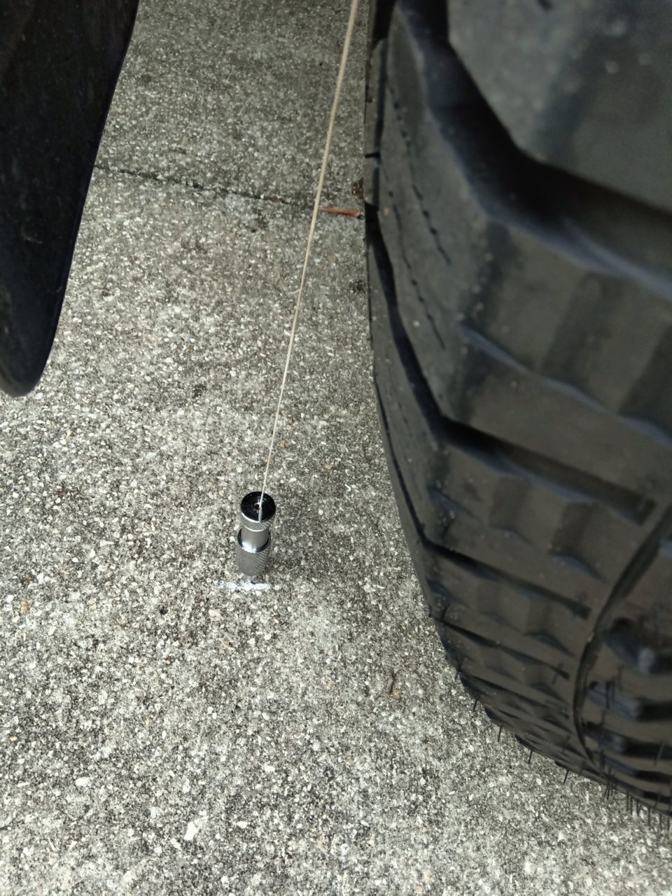

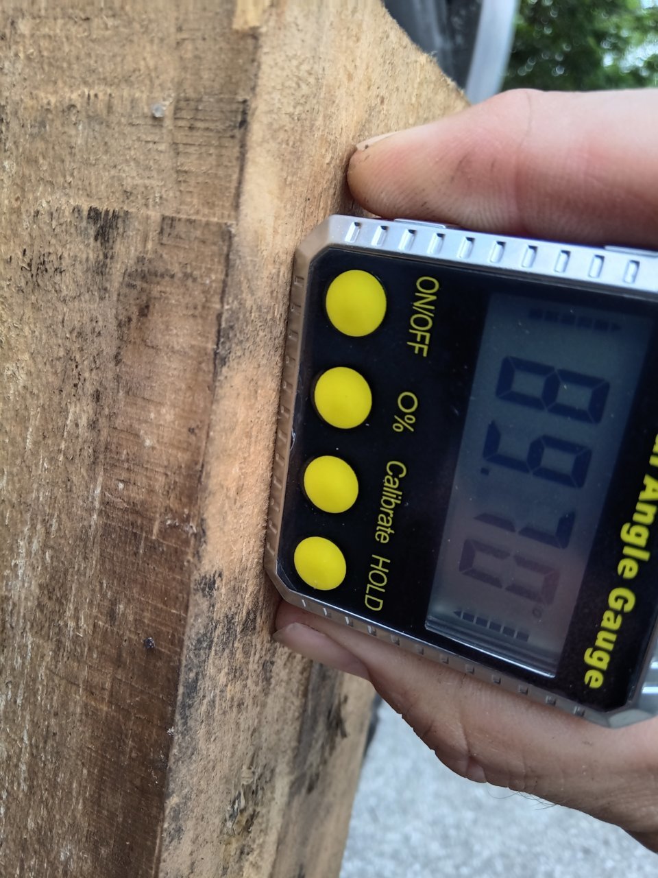

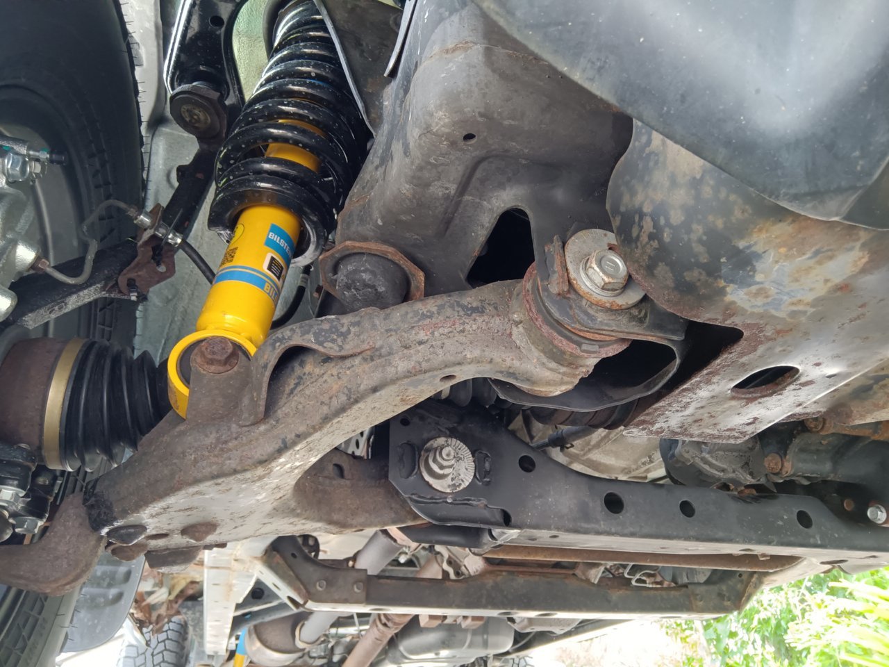

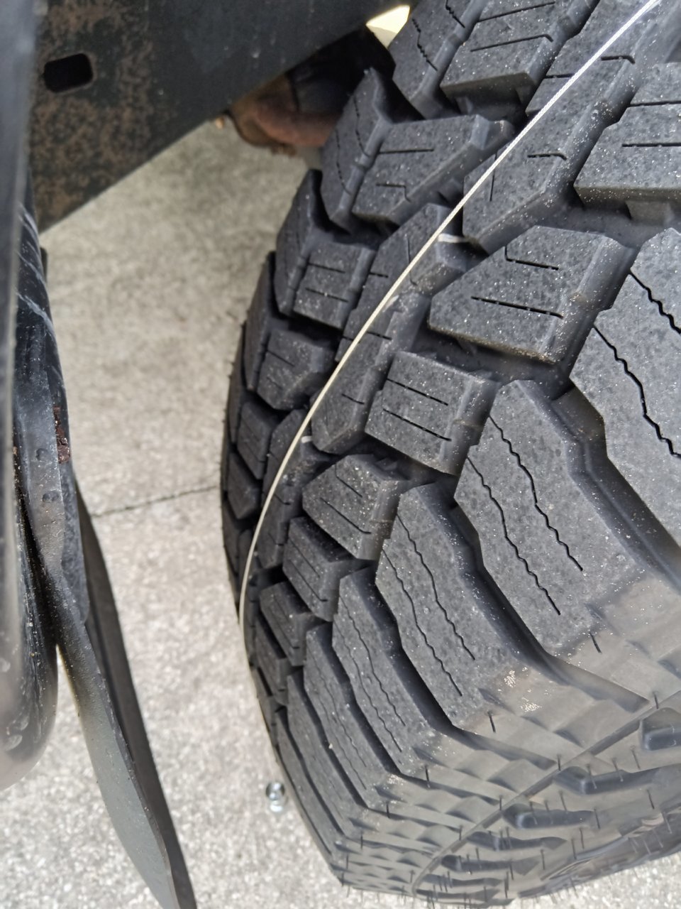

    After two visits to the Toyota service center they said my truck was too rusty and bent and the lower control arm bushings are bad, the truck is lifted and needs new lower control arms installed and that they could not do the alignment. They gave me my money and truck back with the passenger side camber way positive.
    Thanks to JBerry's write up and even though I ended up doing it slightly differently from him, I decided to take on the task of doing the alignment myself.
    Here's how I got the truck back from the alignment. With a positive camber on the passenger side:
    First thing I did was equal out all four eccentrics. (They had them all over the place)
    Once the eccentrics we're equaled, the wheels fell into a good camber. This truck is very straight:

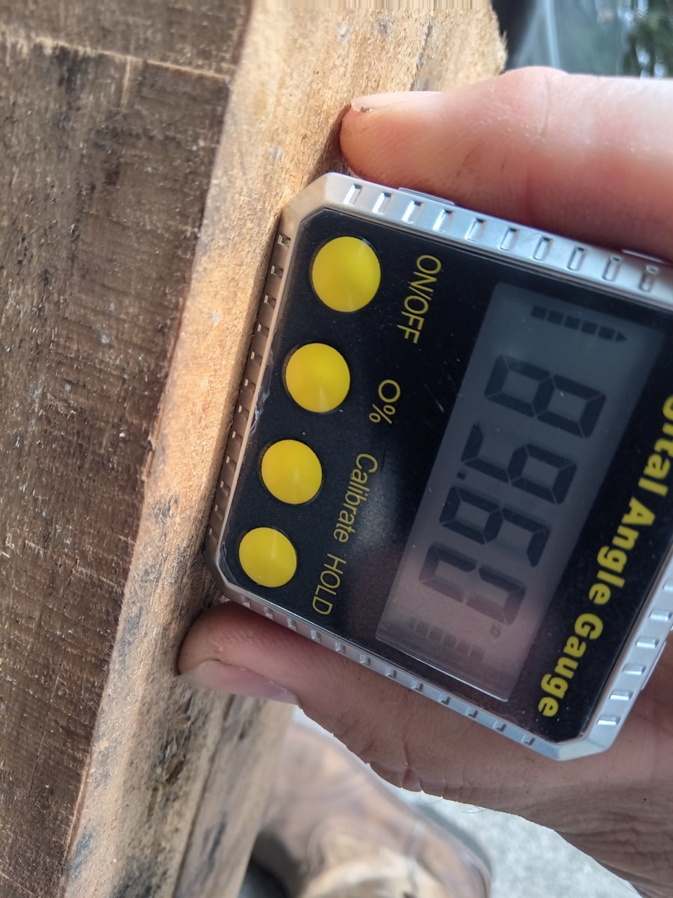

    With the digital angle finder, I was able to set the camber to a -0.3 - -.04 for both sides which I was very happy with
    Next I made sure the wheel was straight then used a plumb bob, positioned on a center line printed on my new tires to make chalk marks on the concrete front and rear to get the toe
    I ended up with a 67.5" front and rear and was happy. The threads on the rack also equally spaced on the tie rod ends.

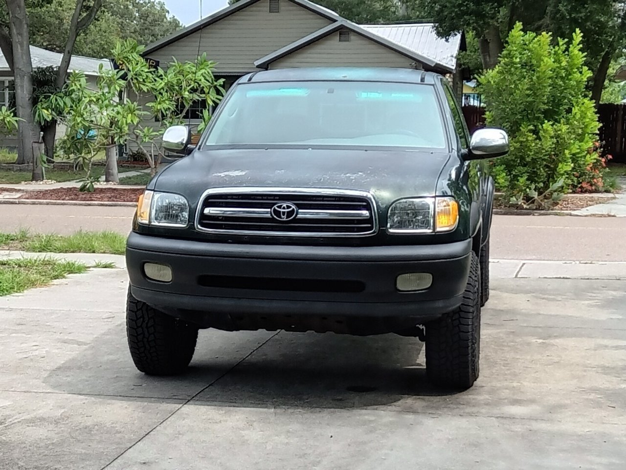

    This is how it ended up. I am happy with this:

    Just an fyi. You want about 1/8-1/4" toe in when doing it this way.
    Also, when evening out the camber I would recommend only pulling the front two cam adjusters inward and leaving the rear ones (near steering rack) fully outwards.
    Bmktw2[QUOTED][OP] likes this.

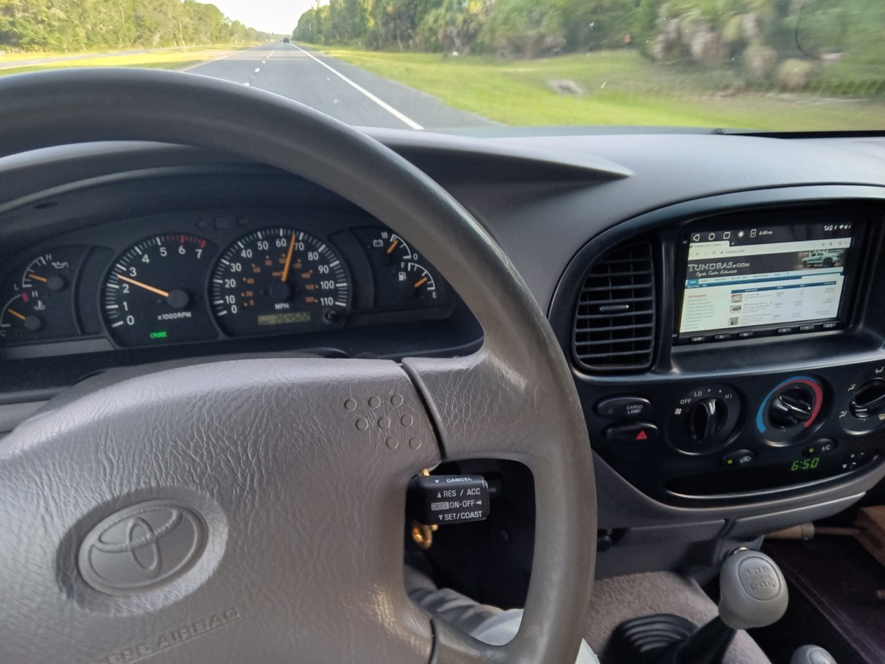

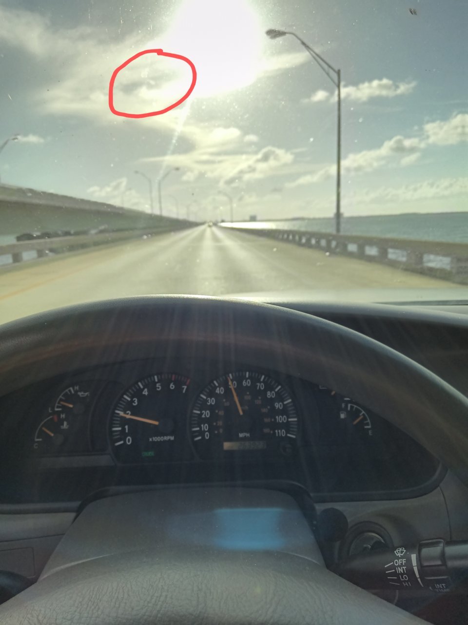

    Coming back from a road trip to north Florida and back. Got it in 5th with the cruise set and tundras.com on the screen. Check out the RPM.
    This truck is sooo much more comfortable than my old single cab 1995 4cyl 5spd ranger with no ac or cruise
