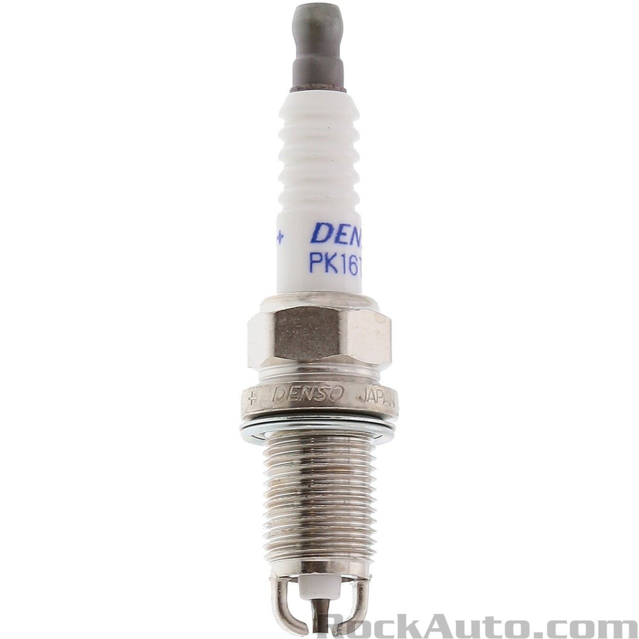

    I know that the v6s call for plugs like this
    I'm not sure why or what the difference really is but that is what it calls for.

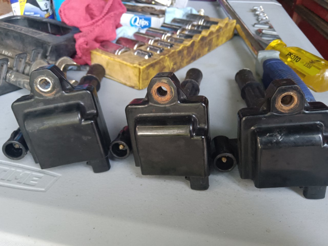

    So I examined the 3 coils. The two on the right were misfiring and the one on the left was working.
    The metal ring that bolts the coil to the valve cover is extremely corroded on the right two. I think that is a ground for the coils. I think that the rusty ground and the rusty bolt and the corrosion also on the valve cover could have caused a bad ground for the coils leading to the coils not firing. When I swapped the coils for the junkyard ones, I also grabbed the bolts to go with it. Less rusty bolts and no rust on the coils now everything working. I think the ultimate test would be for me to sand paper the rust off the "bad" coils and retest them to see the result.
    What do you guys think?

    I tend to agree with your hot take, and like I said earlier, the symptoms you described harken to bad ground.
    However, @assassin10000 is also correct - if moisture gets inside your coil pack while it's firing, they have a penchant for self destruction. I think it would all depend on whether or not that metal part is corroded enough to compromise the seal of the coilpack plastics. When something steel is running thru plastics, and the steel starts to corrode, I usually find it compromises the integrity of the seal of the plastic.
    Could be a fun/interesting test, and I don't see a lot of harm, but I'd stick to testing with the far-right coil pack in your picture because the other one is pretty far gone.

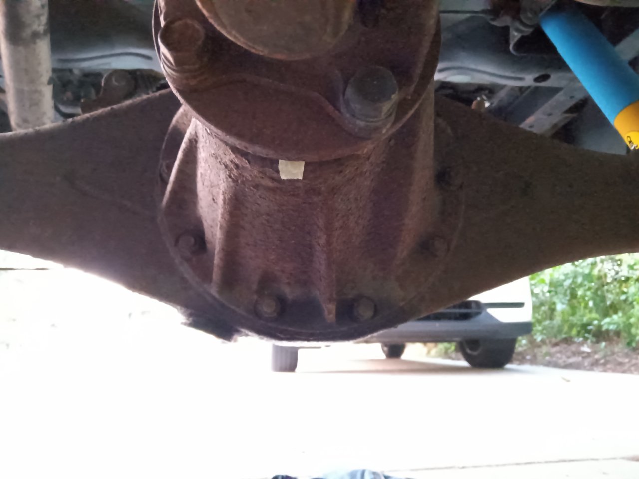

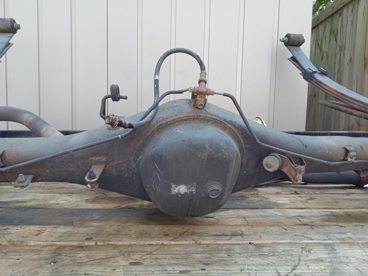

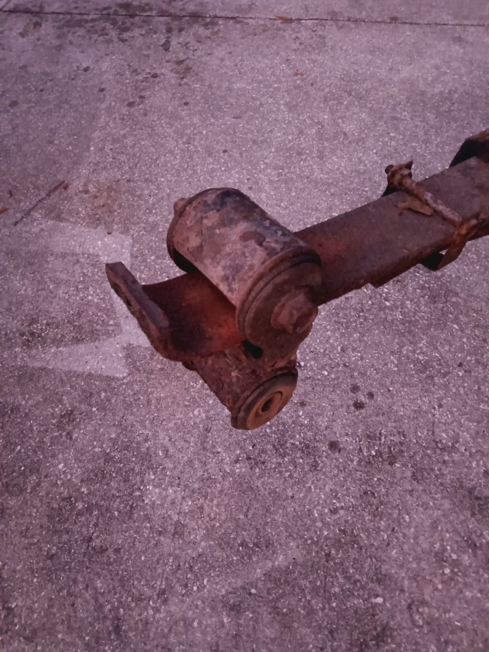

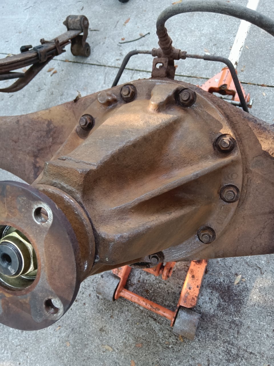

    Just got back from the yard...
    Scored big today. Pulled these gems:
    Muffler, pipe, O2 sensor, and rubber hangars, axle with brakes, lines, bumpstops and leaf springs with no rust!
    To replace this axle which is completely rusted through and leaking through the rust hole:

    Nice! CLEAN! Are your current ass-end parts toast, I don't remember?
    Also, do you know what gearing is in that rear end, and if it matches yours? Ratio in front diff needs to match rear, unless you're planning to only swap the housing. You may already know this, not trying to preach to the choir here...

    I'm going to check the gear ratios as soon as I can

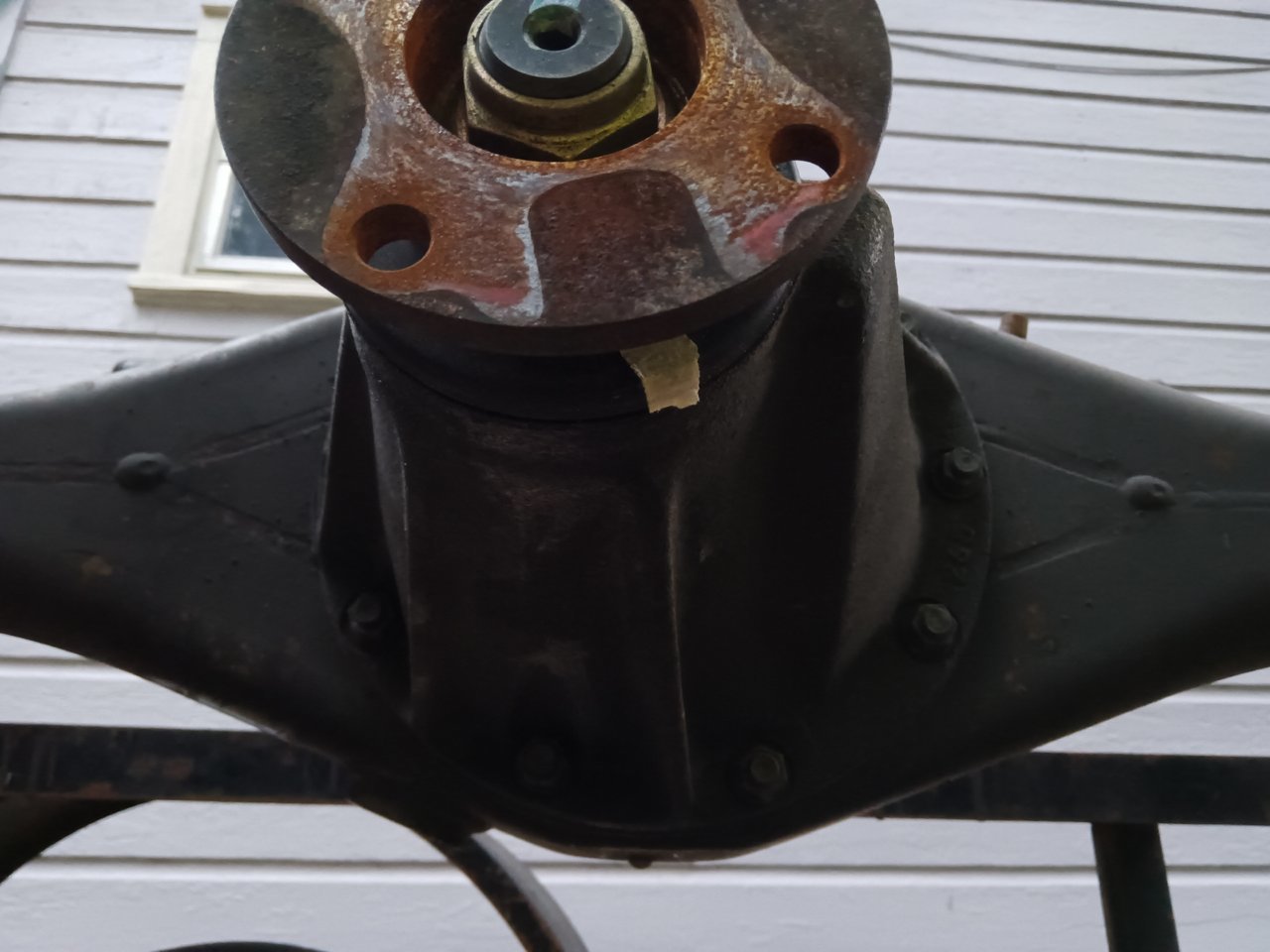

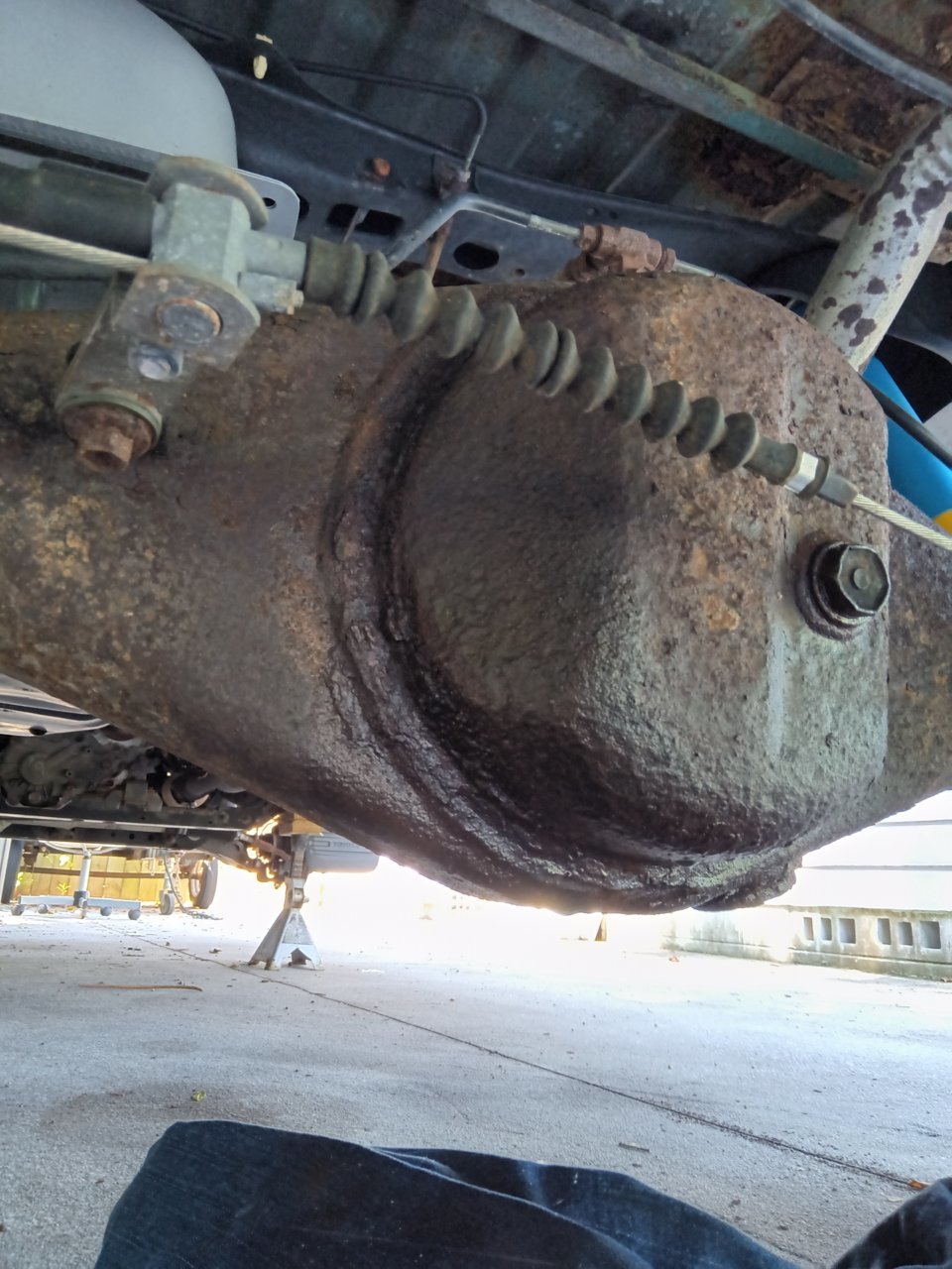

    Looks like my original axle gear ratio is a 4.10 and the new axle is a 3.90
    :facepalm:

    On the plus side, you've got a great new housing. Just might have a little extra work to getting there. The bonus is, you've got all the time in the world to get it prepped and a bike to get you by during downtime :D

    Get a sequoia 3rd member if you want a less rusty one... or swap your current one to the new housing.

    is there a different in diff, why not just change the ring and pinion

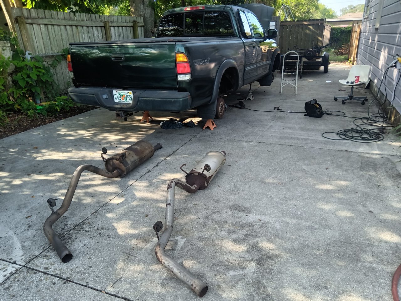

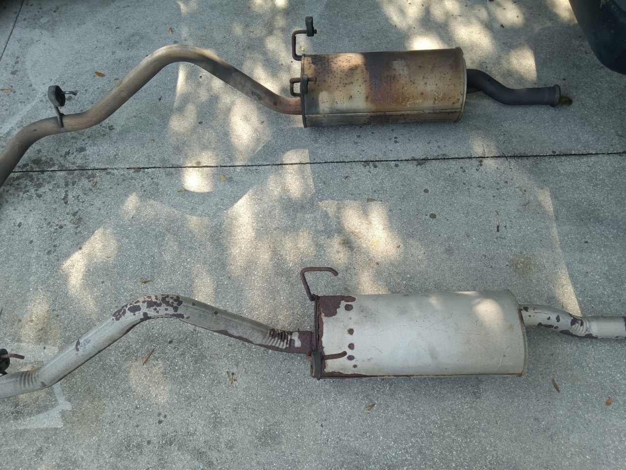

    Replacing the cat-back exhaust with the rust free OEM one I got from the yard

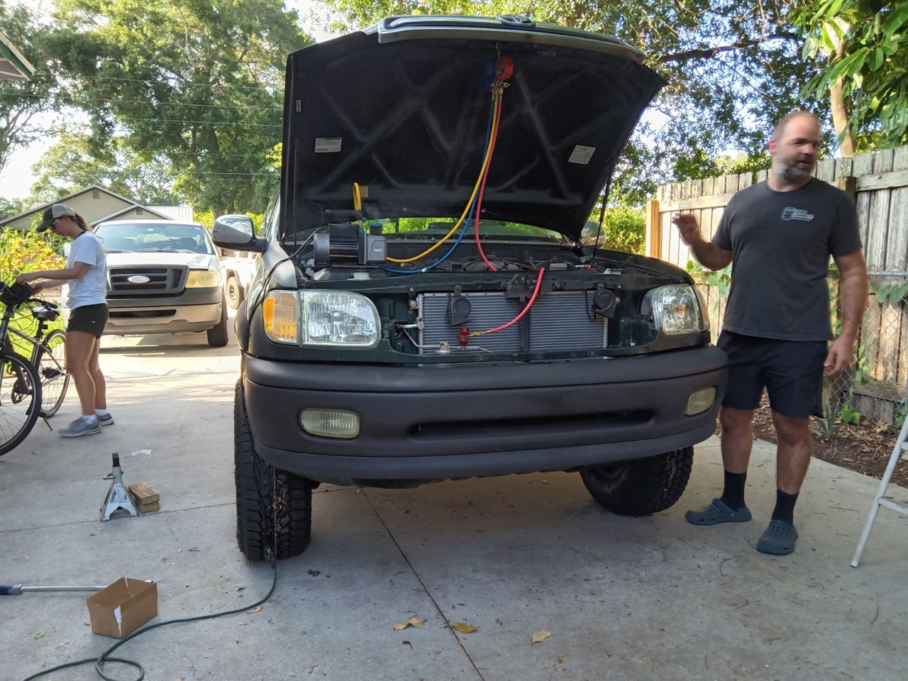

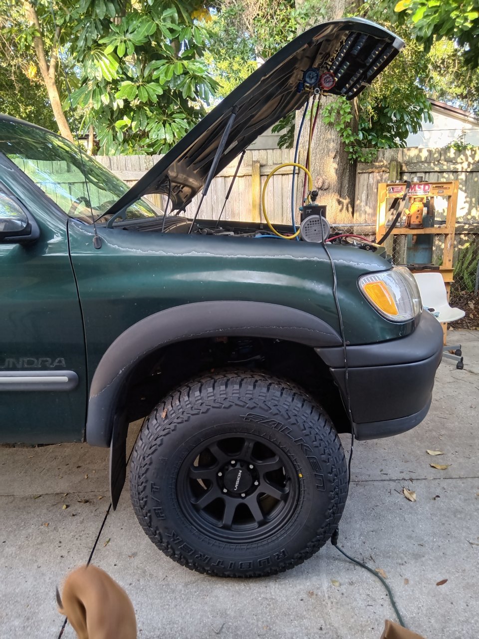

    Front wheels on!!!
    Brother helping me pull vacuum on the AC system with his AC kit.
    It held vacuum for :30 min no problem so we charged 2 cans of freon in the system until the sight glass went clear. Now there is ice cold air!

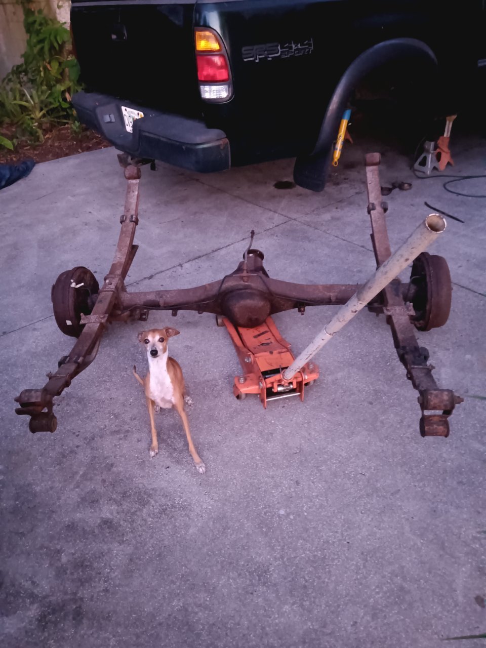

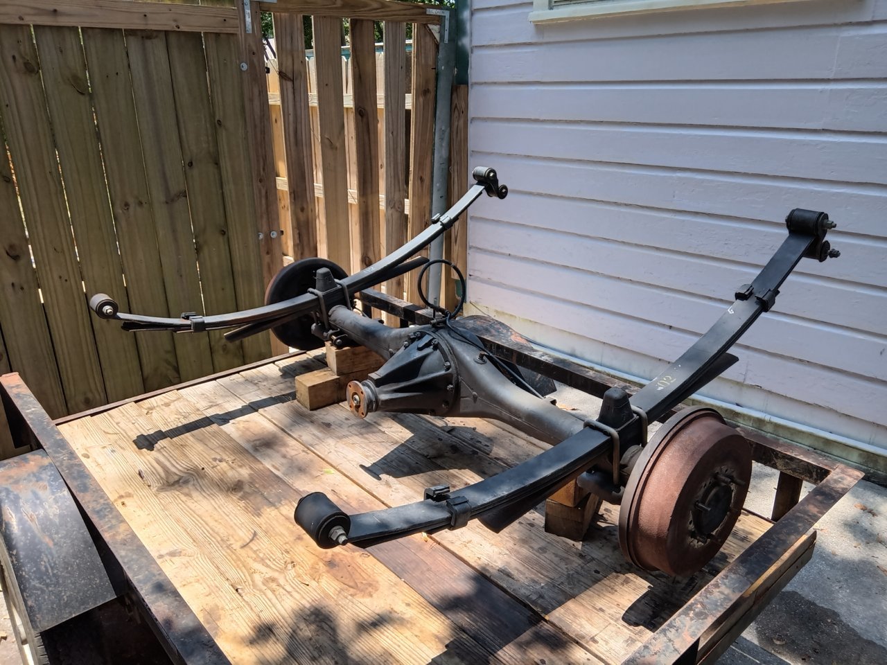

    Got the old axle out:
    Was mortified to find a leaf spring broken:

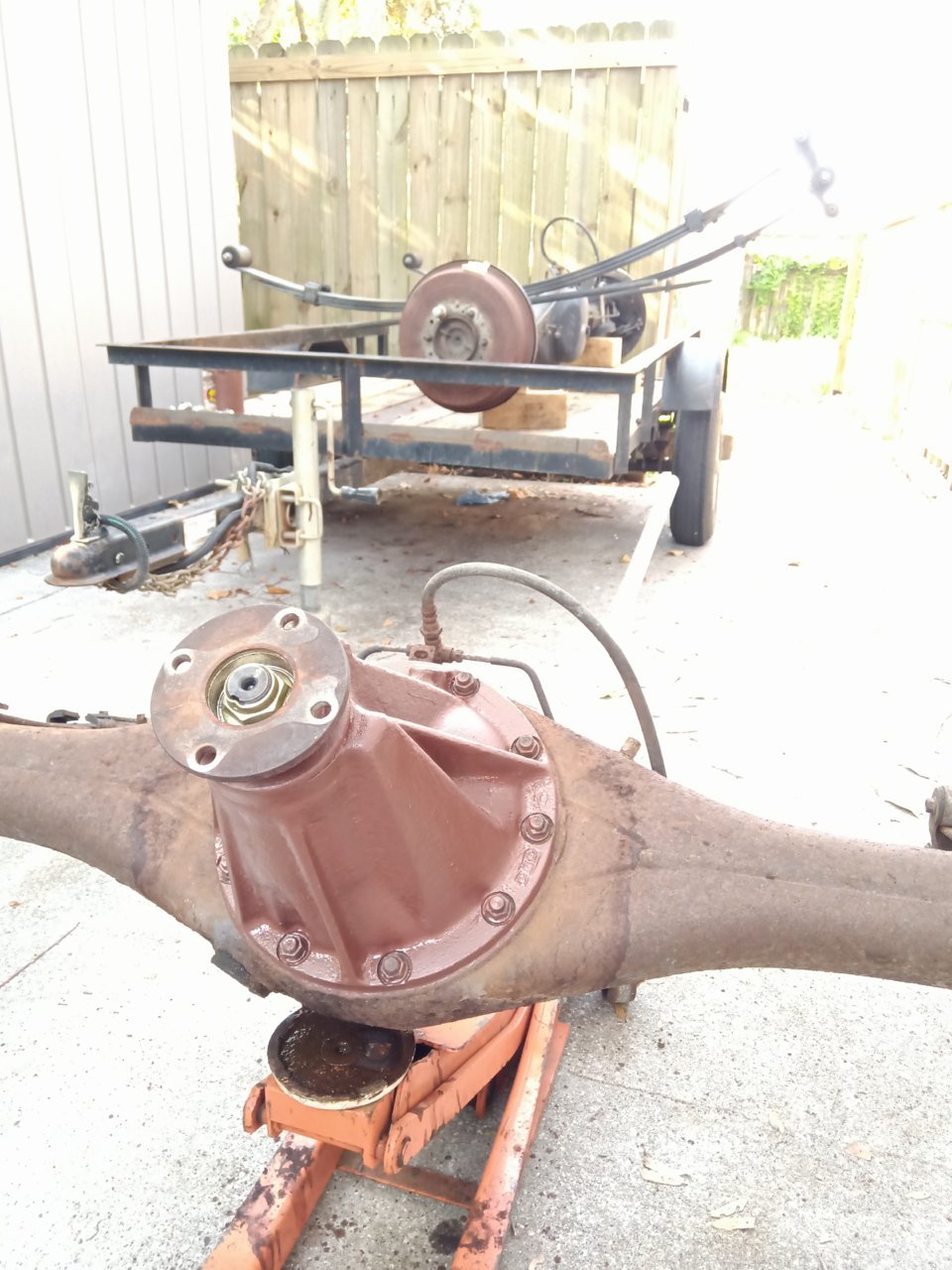

    Scraped, brushed and cleaned:
    then rust inhibiting primer:
    Coat of black paint and then will remove and install in new housing...

    How are you going to install that if the gear ratio is different? Or are you just using the new housing?
    Bmktw2[QUOTED][OP] likes this.
  30. Jul 2, 2023 at 6:50 AM
    #420
    Bmktw2
    Bmktw2 [OP] Yard Dog
    May 16, 2023
    #97109
    474
    Nic
    AC 2001 5spd 4x4 V6
    Just swapping 3rd members between the axle housings. Have keep the matching 4.10gear
