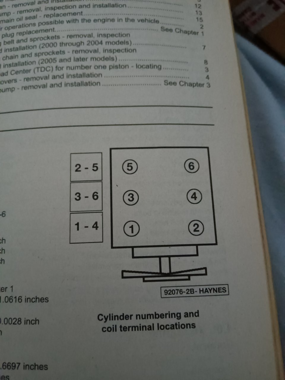

    In your previous post with your pic of the codes, only 2 and 5 didn't have misfires. 2 and 5 are on the same coil pack. I'd start there.

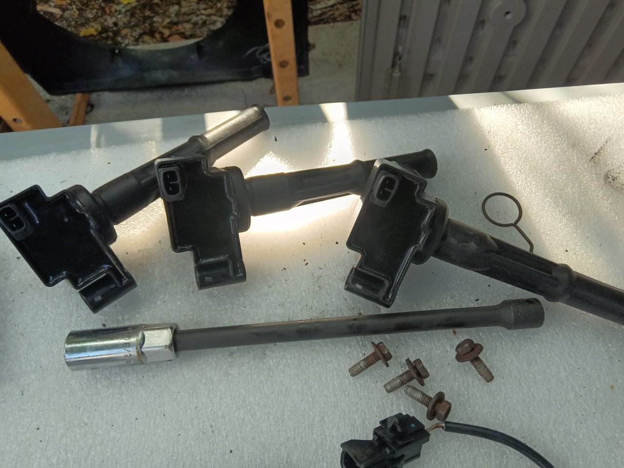

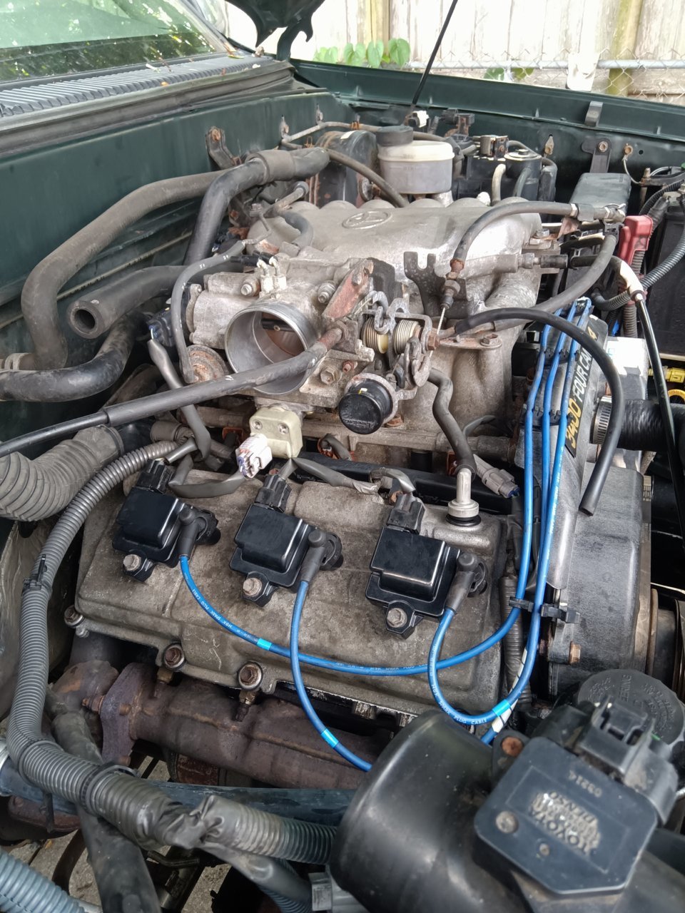

    Went to the junk yard got three new coils:
    Installed them:
    Truck is fixed and running like a sewing machine!!

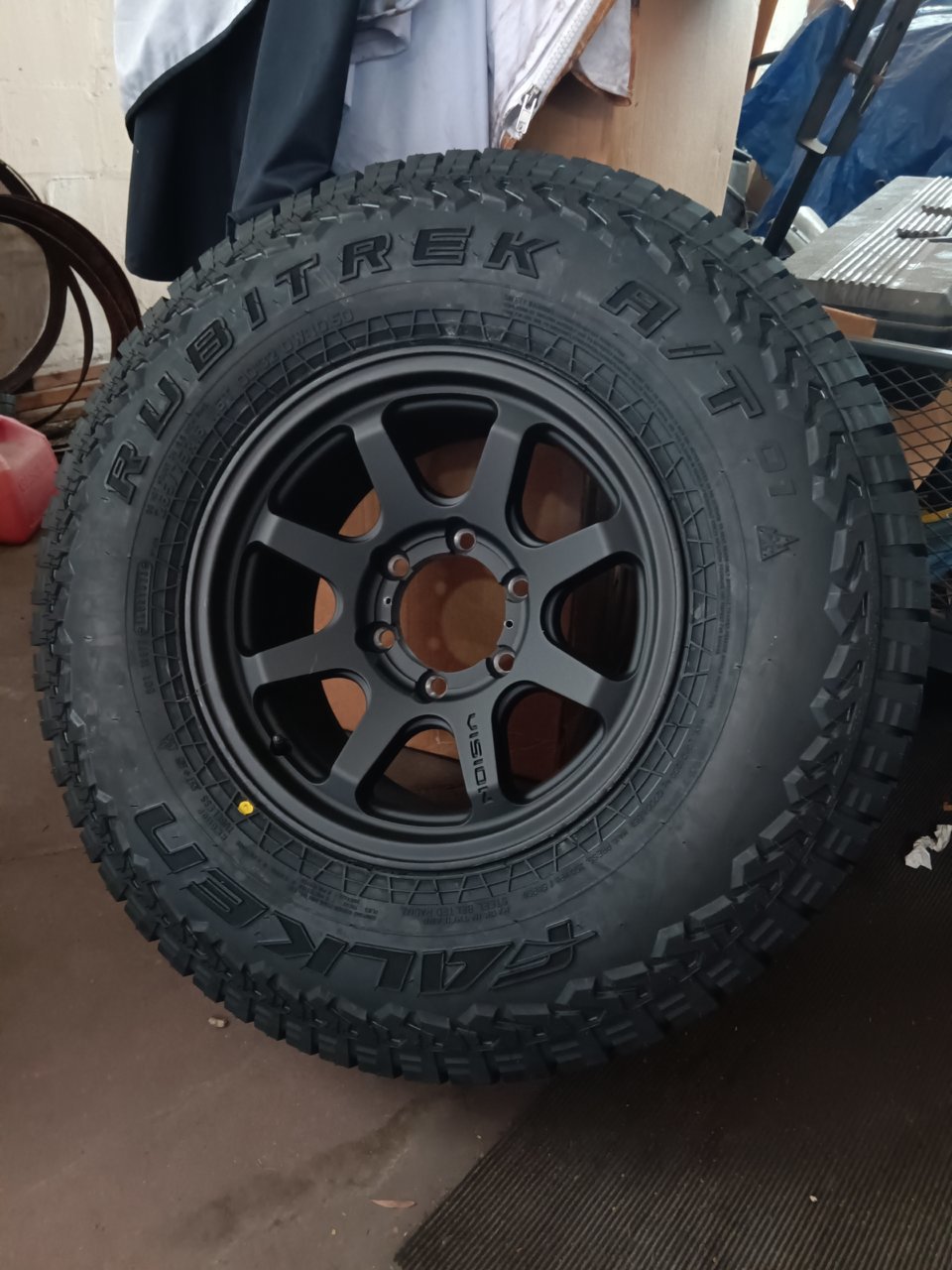

    My brother is now installing the tires on the wheels

    Wheel/tire choice looks good! Look forward to pics with it all buttoned up.

    5vz's only have 3 coilpacks.
    Bmktw2[OP] likes this.
  30. Jun 29, 2023 at 12:40 PM
    #390
    shifty`
    Jun 20, 2020
    #48239
    29,447
    ATL
    '06 AC Limited V8/4WD
    Ah shit, you're right. I forgot that's what all the wires are spanning to the other side. Such a weird design. Still odd to see two go at basically the same time.
