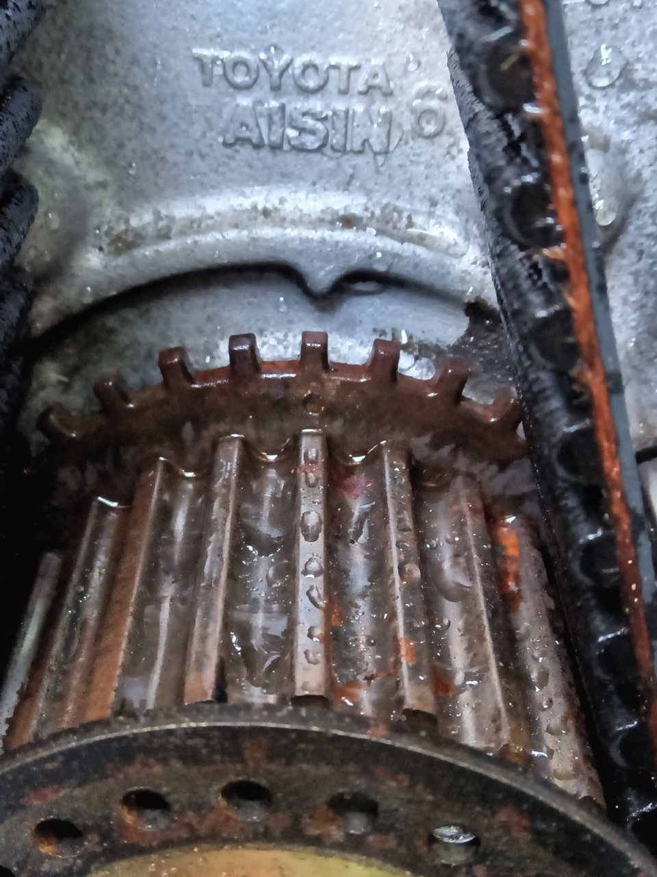

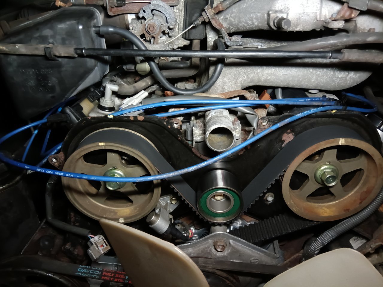

    Took off the front cover to double check the timing belt position. Turned the crank over many times matching the timing marks over and over on it's correct position. There's nothing wrong with the belt

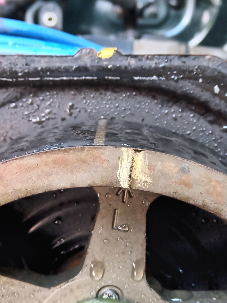

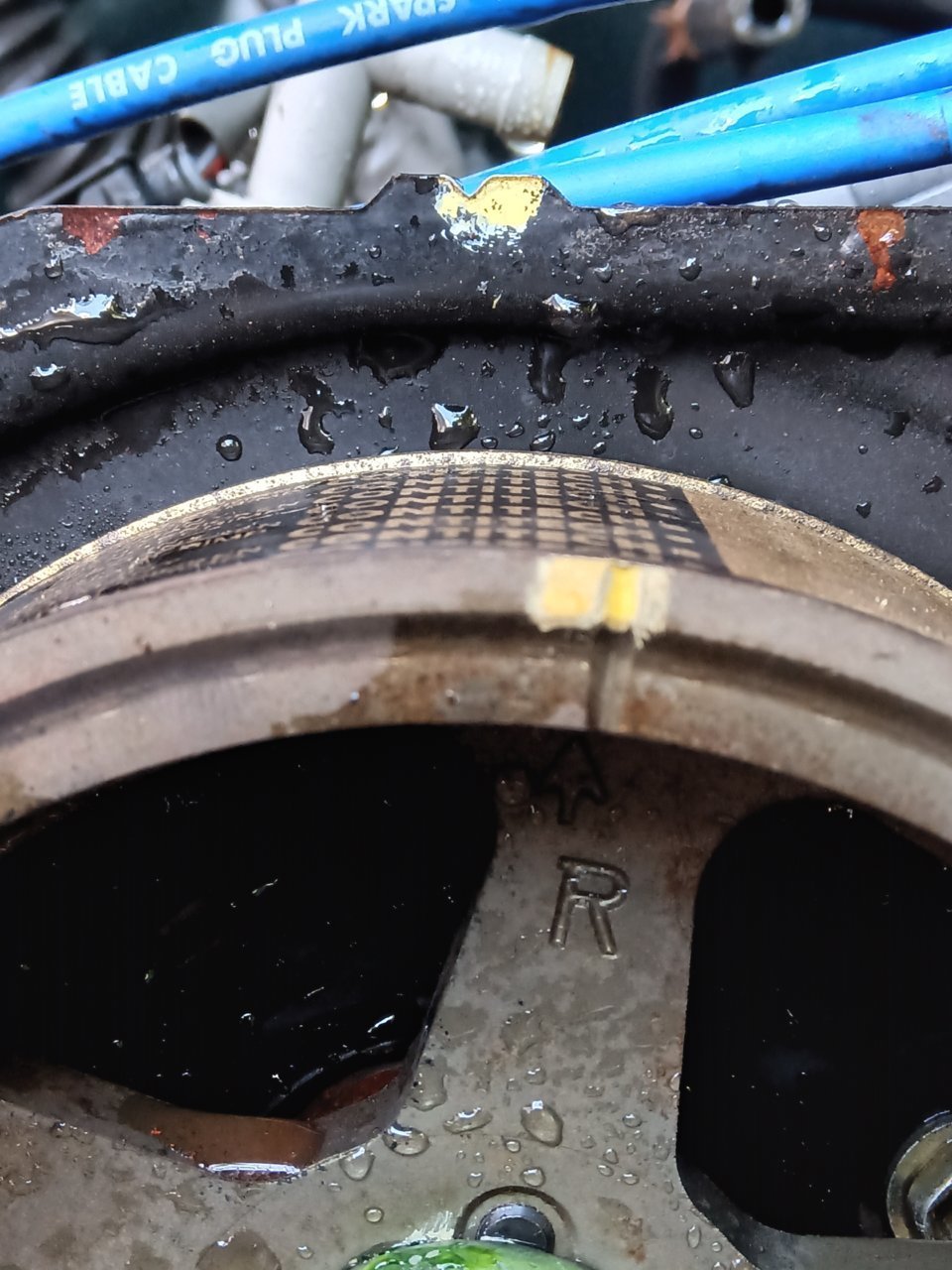

    Its always hard to get great perspective from pics, but did you align the cams the same way the belt was installed when you bought it? In the pics you took a few weeks ago, it definitely looks like the cams are off a tooth on each bank. How did the truck run when you initially bought it?

    The truck seemed to run okay. I just purchased the truck and only drove it once on the way home so I don't really know. I rolled the cams back one cog and installed the belt. The belt has indications of where it must land so it's a no-brainer. I just double checked and everything seems fine. I'm thinking it's a crank sensor or something electronic I'm not going to go around circles on the timing belt it is in the only way it can go on unless they printed the indications and made the notches incorrect on my block

    Belt only goes on one way. The marks on the belt are all in position. If this is installed incorrectly I don't know my first name.

    As long as the cam pulleys and crank align properly, you're good to go. They weren't in those first pics. If you're satisfied you have it right, we can move on and hopefully help you figure this out.

    I dont like that the left pulley is marked 'R' and the right pulley is marked 'L'. Its probably correct if it's never been messed with before. Just makes me cringe, & i'd have chased that rabbithole for at least a day.

    I know. Just bugs me when the marks are on the fronts of the pulleys.

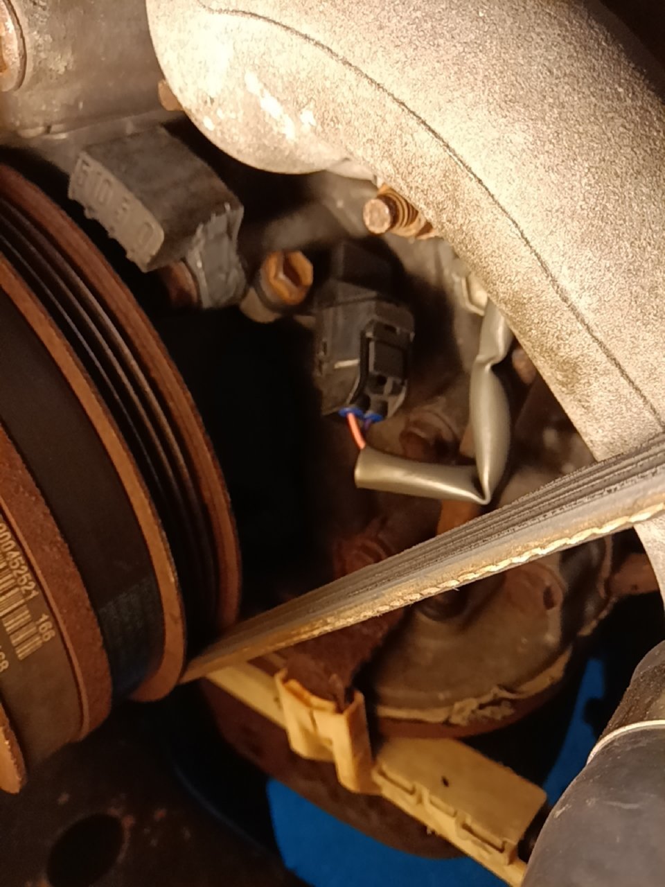

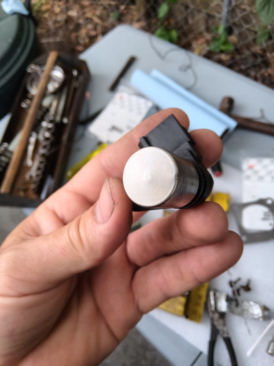

    I had the crank sensor out and on my work table. It magnetized itself to my wrench just as I grabbed to use it and caused the crank sensor to fly and hit the concrete. It put a small dent in it. I don't know if that may be affecting anything but tomorrow I plan to make a trip to the junk yard and get another crank sensor, ignitor and maybe cam sensor. I'm at my wits end

    That could do it. It's a hall effect sensor, which has a magnet inside. If that cracked it may no longer work correctly.
    Bmktw2[QUOTED][OP] likes this.

    I removed the crank sensor to have another look at the small dent in it

    I doubt that's going to make a difference unless it's breached. It's just a simple Hall Effect sensor.
    shifty` likes this.

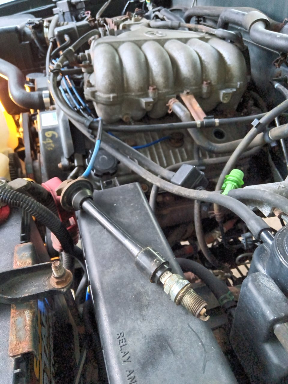

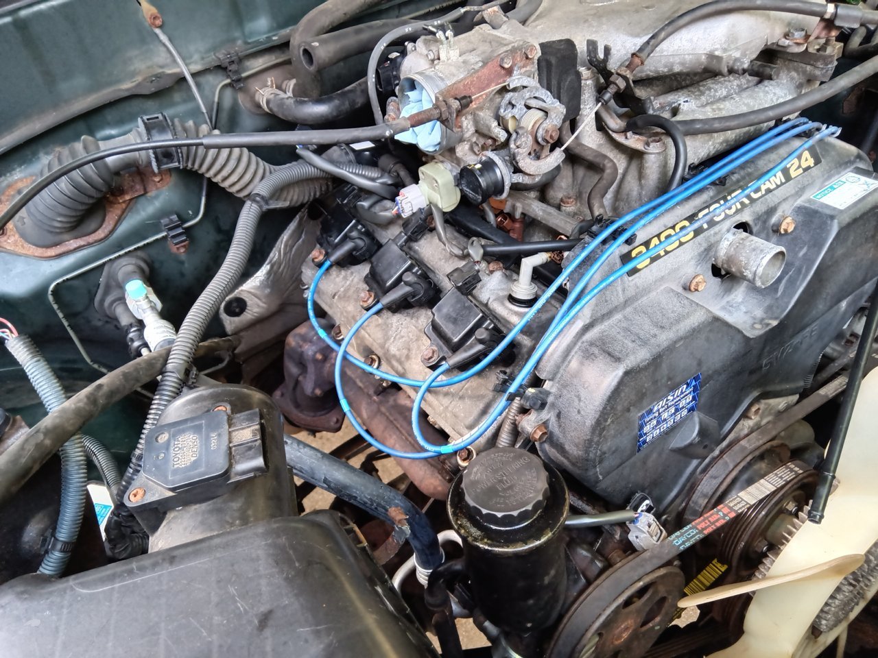

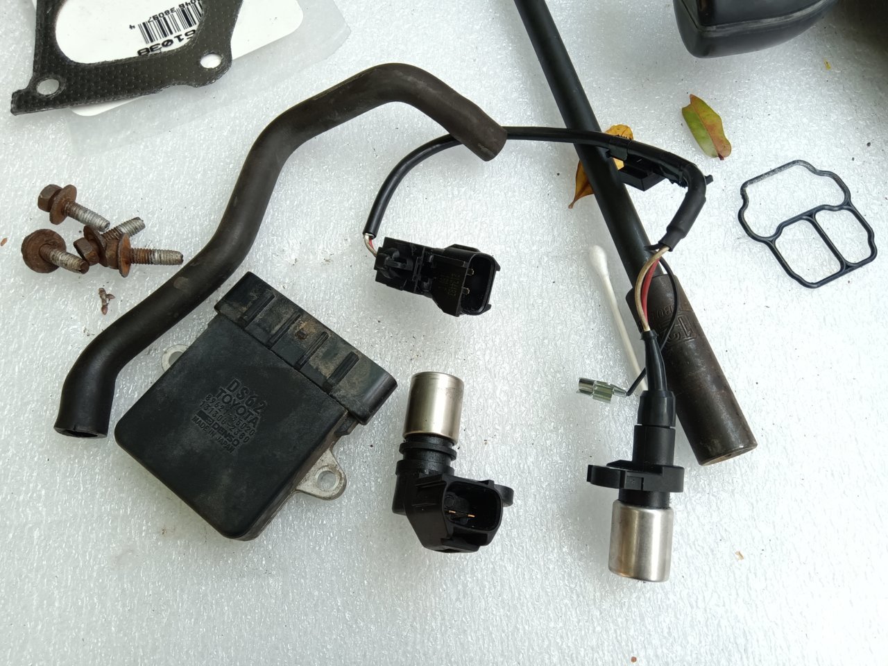

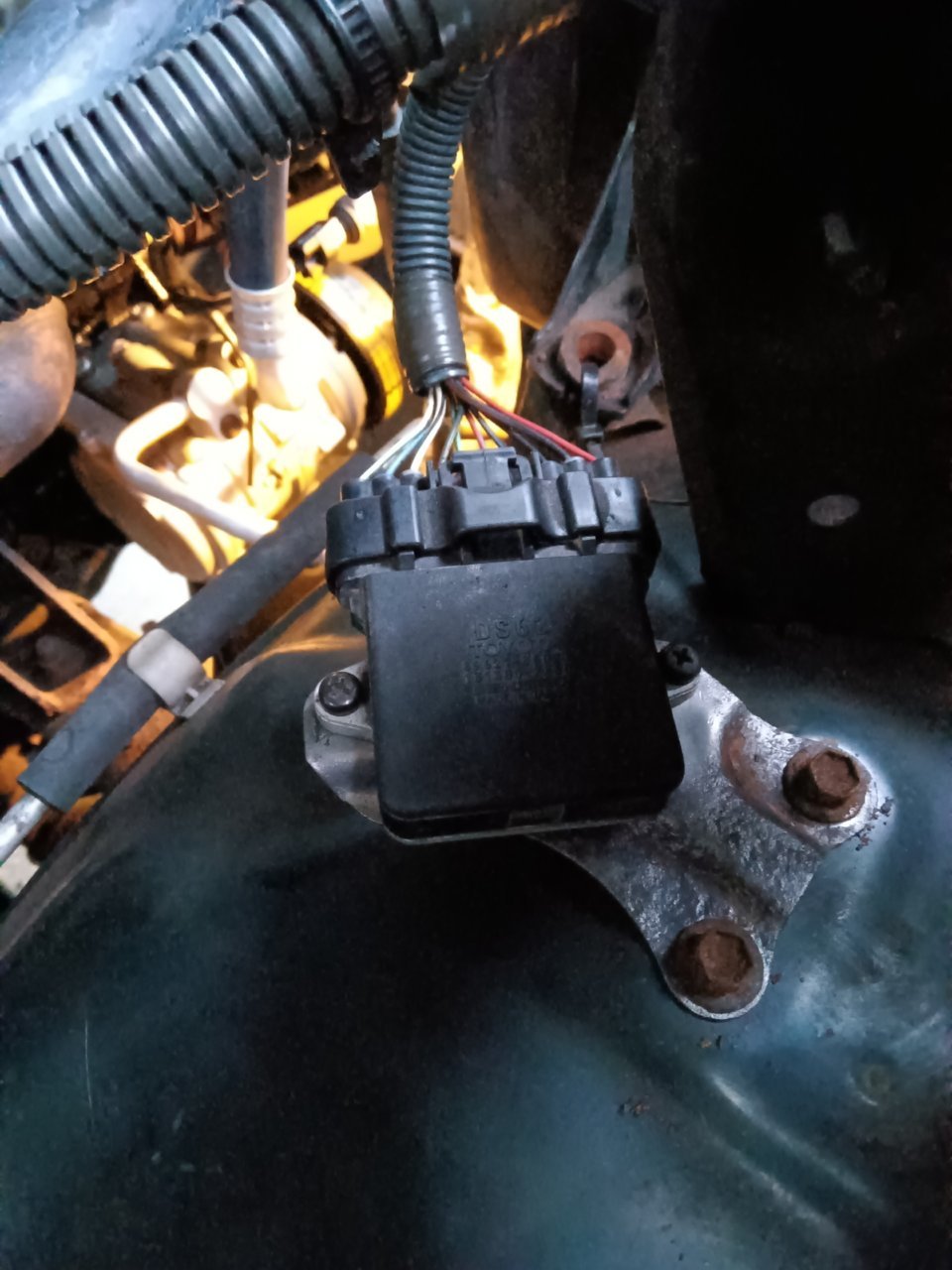

    Last night I unplugged all the connections to the fuel, spark and sensors. Today was a hot dry day so if there was any moisture in the plugs they could have dried out. I also left the battery unplugged over night.
    Picked these parts at the yard.
    Crank sensor, cam sensor, ignitor ICM and a newish pcv valve hose.
    Going to install the pcv valve hose and try the crank sensor first.
  27. Jun 28, 2023 at 4:52 PM
    #357
    Bmktw2
    Bmktw2 [OP] Yard Dog
    May 16, 2023
    #97109
    471
    Nic
    AC 2001 5spd 4x4 V6

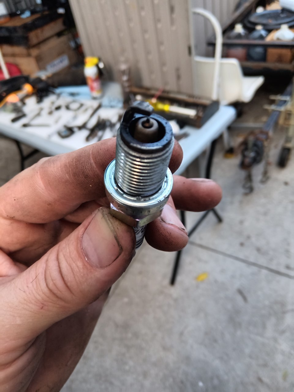

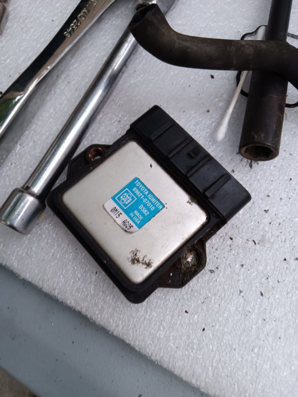

    Installed the crank sensor, no change...
    Then drilled the screws out, cleaned the bracket and
    installed the replacement ICM, no change....
    Decided to look at the brand new spark plugs...
    Looks like there's unburnt fuel on this....
    I put an extra spark plug on cyl #6 (which reported misfire) and started the truck. Not once did the spark plug fire.
  28. Jun 28, 2023 at 5:17 PM
    #358
    Winning8
    Winning8 New Member
    Jul 4, 2019
    #32819
    2,039
    Da Bay Area
    2019 MGM DC 4x4 SR5
    Mumba 18x9 ET 12, BFG KO2, FOX suspension, diamond back HD cover w/ rack, LED head & fog light bulb, TRD rear sway bar, timbren enhancement, RAS helper spring, avs auto shade, Carhartt front seat cover, bench seat cover
    you need to ground the spark plug for them to spark
    Jack McCarthy and Bmktw2[OP] like this.

    I grounded it and tried again it was firing Intermittently with a weak looking spark
