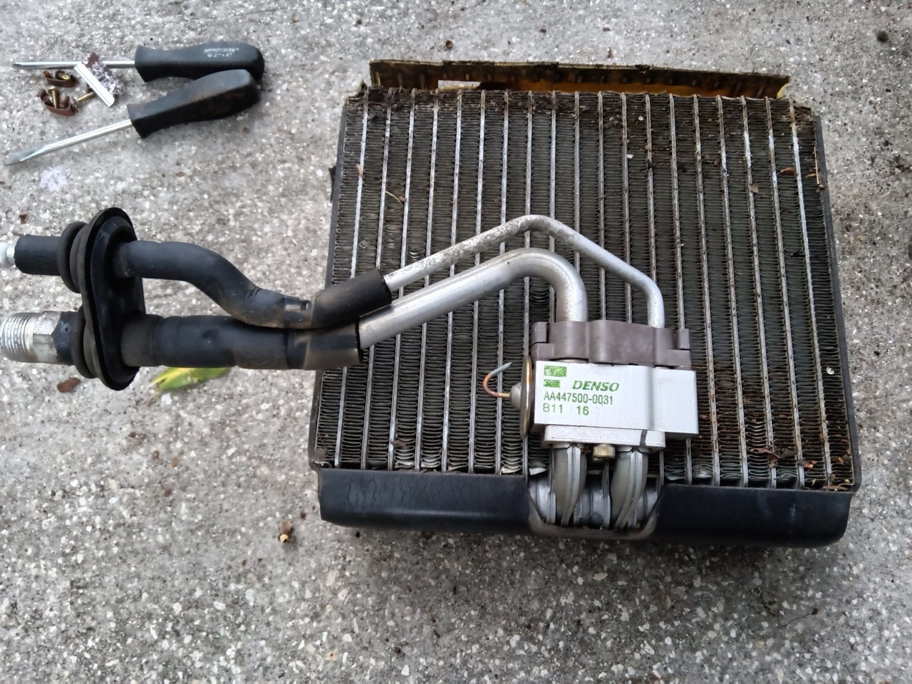

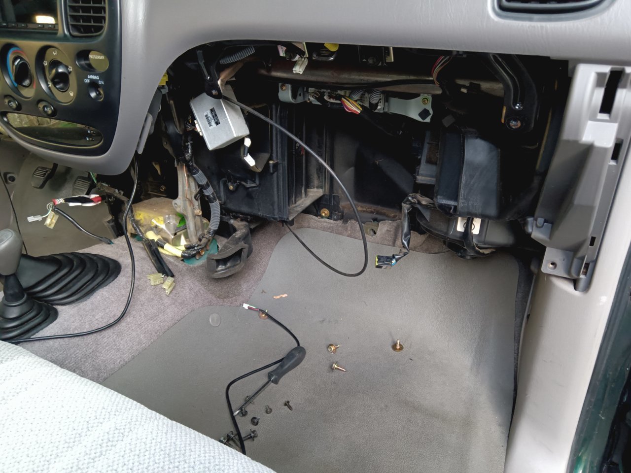

    Riding back with the tool:
    Removed from dash
    Good thing I went this far with it because there was a disgusting rats nest right on the evaporator
    Evaporator and expansion valve

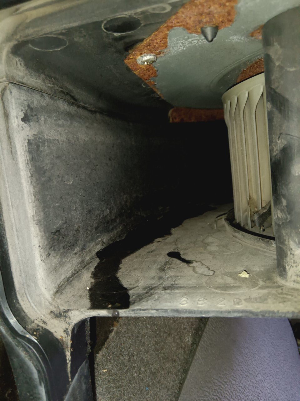

    I also noticed the last couple days it's been raining really hard and I had a small puddle of water on my passenger side floor mat. When I removed the evaporator box from the blower motor box I found where the water was coming from.... But I can't see and further back than this...

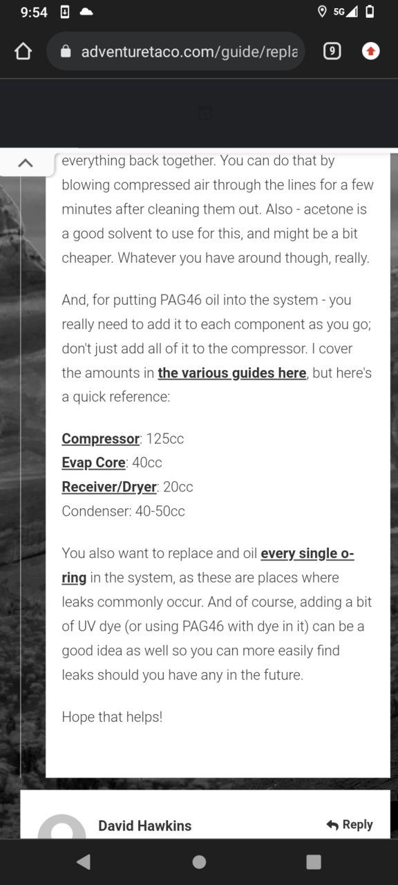

    Does the air compressor take 7.75floz of oil?
    Also do I just pour all the oil in the compressor or do I pour it in elsewhere? Thanks
    8oz bottle

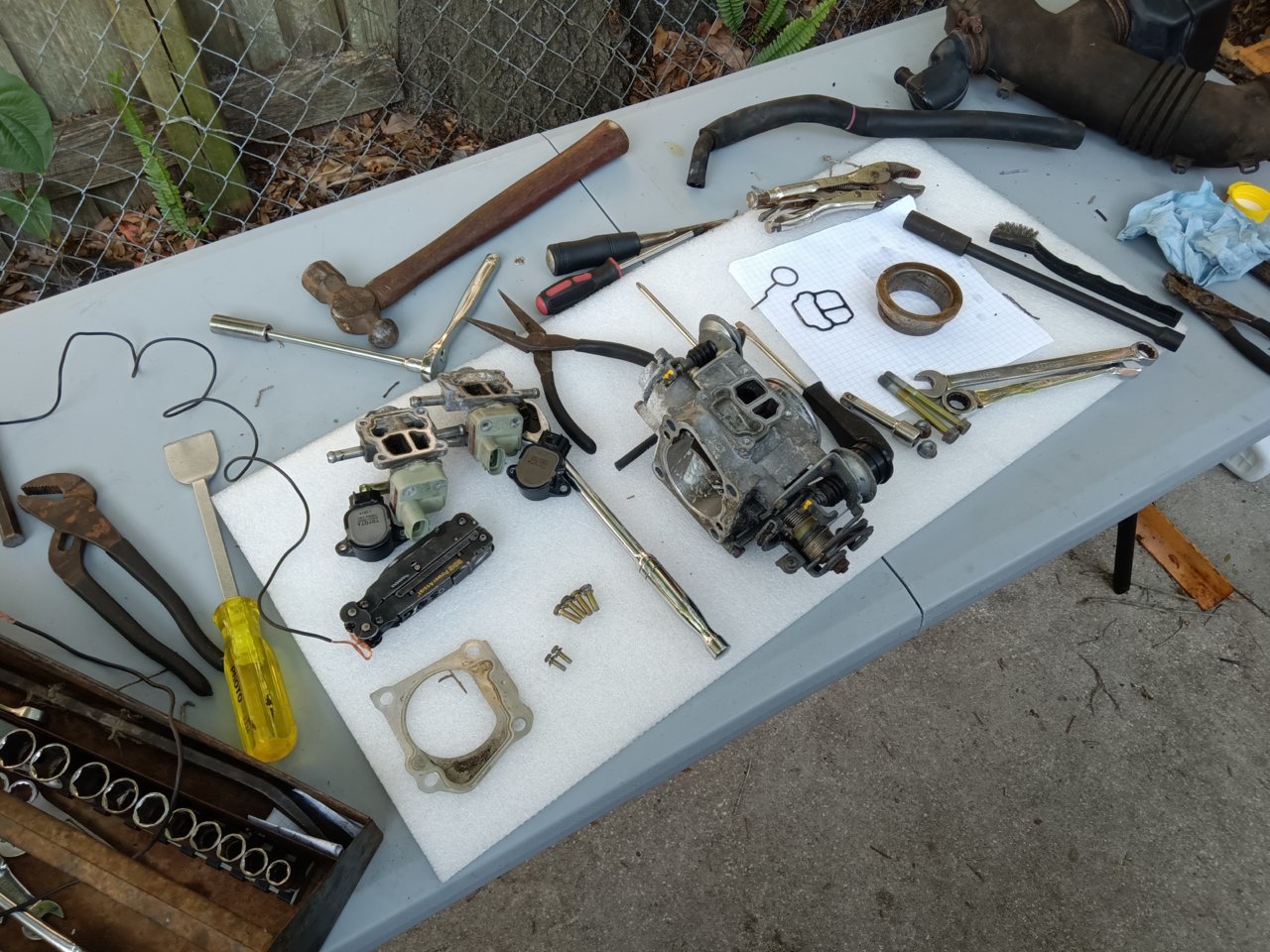

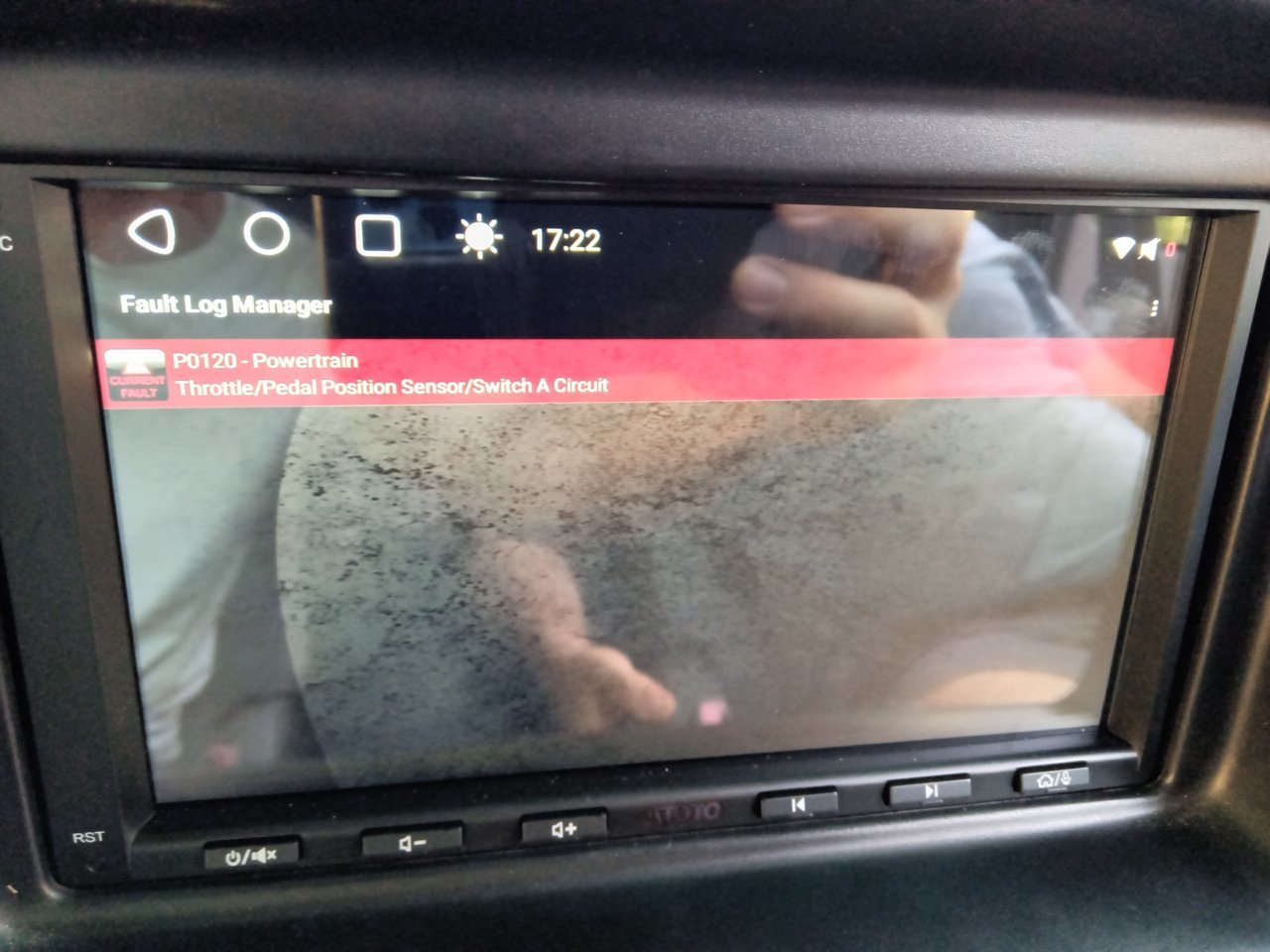

    Got the truck put together and started it up for the first time. Truck is running shitty and it threw a code 120 throttle position sensor
    I think something went haywire when I had the intake off and decided to pressure wash the throttle body. Maybe I shouldn't have done that... Going to the junk yard tomorrow to get a new TPS sensor

    Yeah, it’s a sensitive part. They don’t even like the cleaning spray applied directly to them. The liquid can seep into the electronics through the shaft the butterfly sits on.

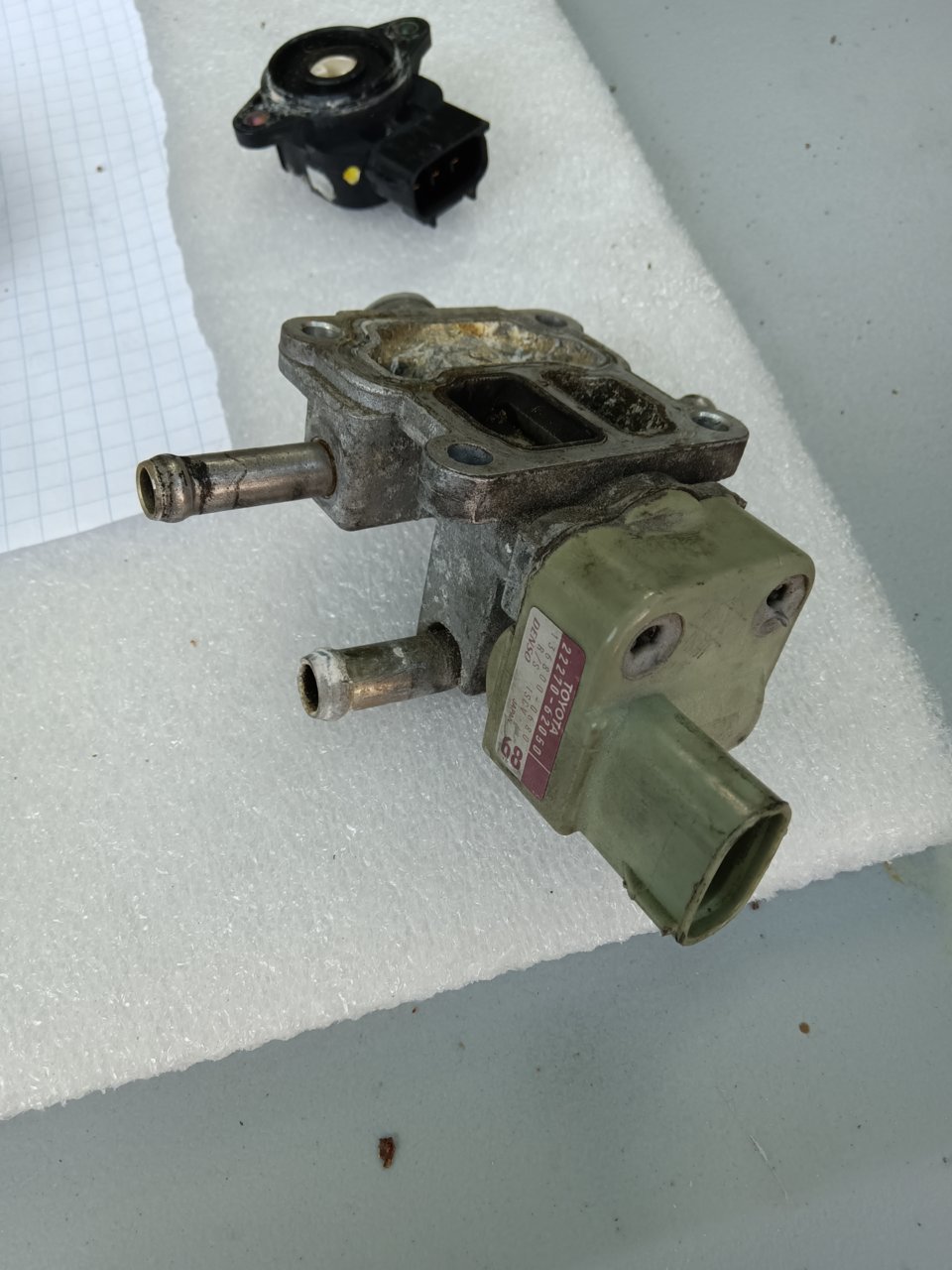

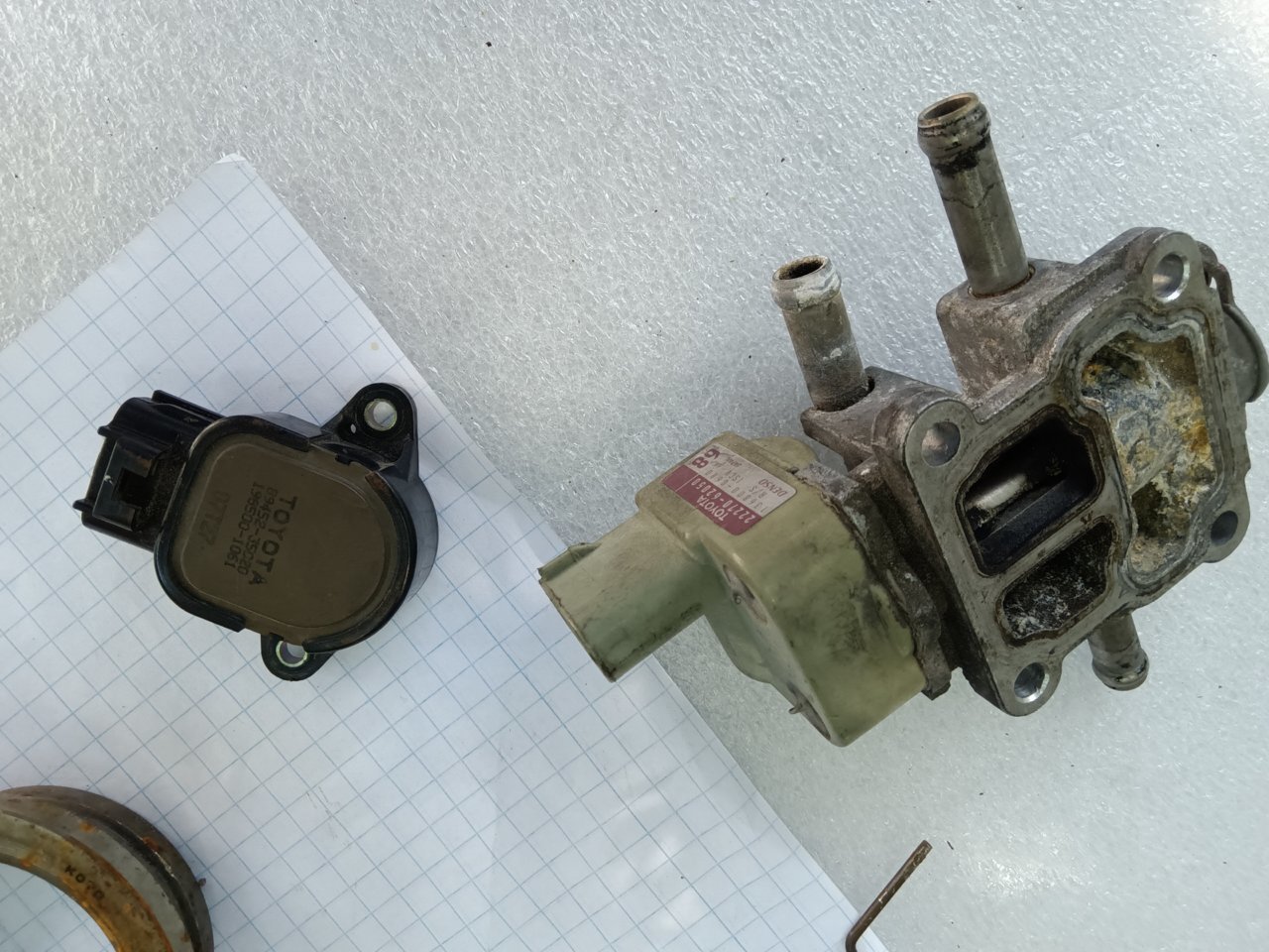

    Went to the junk yard and got these two parts
    Going to first try just the TPS

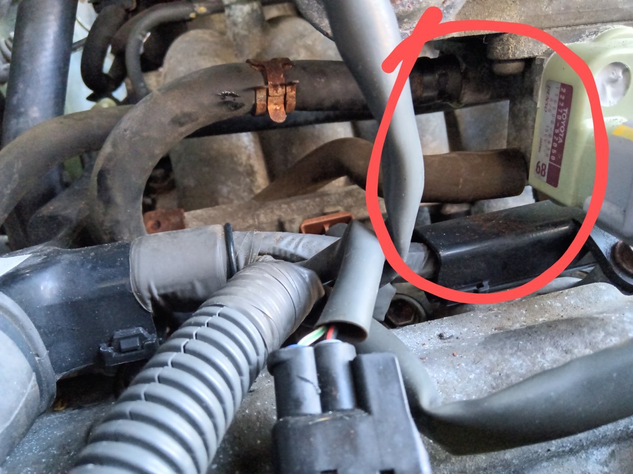

    AC 2001 5spd 4x4 V6
    I'm wondering if these two hoses are connected to the right ports or do I need to swap them around?
    Dam! Never mind, that's a coolant line not a vacuum line....

    AC 2001 5spd 4x4 V6

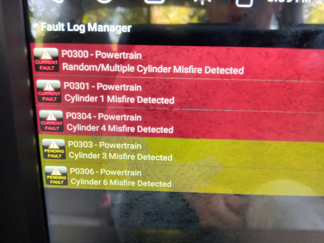

    Went to the junk yard got a new TPS sensor and IACV idle air control valve. Cleaned up the IACV with throttle body cleaner and got it free moving smooth. I cleaned and oiled the throttle body. I got some MAF sensor cleaner and cleaned the MAF. I left the battery unplugged over night. This morning I put everything back together and the idle is now very low (≥500)
    The TPS fault code is clear. But the engine is running very rough and I got 5 new codes. P0300, P03001, P03004, P03003, P03006

  21. Jun 27, 2023 at 4:01 PM
    #321
    Mr.bee
    Mr.bee King Turdra
    Jun 4, 2022
    #79178
    6,423
    SATX
    '02 AC TRD
    Maybe sometimes it wants to identify as a harley. Any signs of corrosion on any of the coil plugs?

    AC 2001 5spd 4x4 V6
    I put new spark plugs in it I don't understand what's going on with it

    AC 2001 5spd 4x4 V6
    I checked the firing order, the plugs, hoses everything. Ever since I changed the timing belt there's been issues with the motor not running correctly but I don't understand I put the motor at TDC, removed the belt, never spun the motor or moved the positioning and reinstalled the belt in the same spot it stopped at. I'm baffled

    #97109
    474
    Nic
    AC 2001 5spd 4x4 V6
    Yesterday the engine ran like shit and idles at 2000+rpm and the only code was tps fault
    Today the idle is low (under 500rpm) , the engine runs like shit and the p0300 codes appeared no more TPS fault
