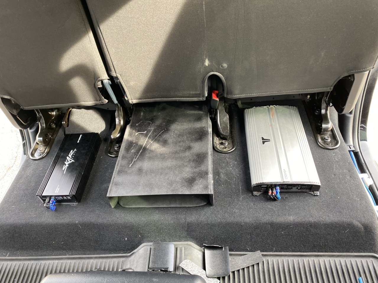

    You have a CM. You can recess mount the amps into the bottom more to hide wiring
    vegas4x4[OP] and Rica25 like this.

    Im planning on doing this later on. For now i just want to get it running asap

    Looks good. I like the idea of the external port. How many sq.in. of port do you have? I have 4 skar 6.5's I'm going to install sometime.

    Its 24 in^2. 12 per cubic foot, right in the standard range.
    4 6.5s should really sound great. Great response, with the ability to still get low depending on where you tune it.

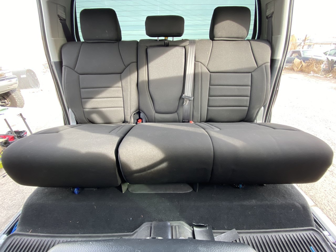

    2016 Black TRD CM 4x4
    I got it going late last night. It sounds great! It get louder than i was expecting. Sounds great throughout most of the frequency range. Didnt quite hit the 25-35 hz as cleanly as i would like at mid-high volumes, but that is expected from a ported box at one 1 cubic foot per sub. I didnt really get a chance to tune anything or even clean up my wires so i have a 3 hours this afternoon to tinker with it. Im hoping some tuning can clean up the lower frequency response.
    the got it running with the seats out. Then when i put the seats in, it baffled the sound a little. It wasnt as in-your-face loud, so im assuming i lost some decibels, but the port facing forward was still crystal clear and loud.

    I added about half a bag of poly fil, and used poly batting as a barrier to keep the loose stuff from shooting out the port. I know theres mixed reviews on whether or not polyfil actually works, but it sure made a difference for me.
    It’ll never hit like my sequoia (2 15s in a 10 cubic foot box tuned to 28hz), but i couldnt really ask more out of this bass setup. Cost me under $450 for the subs, amp, materials, wiring... and it sounds freaking sweet. The port shooting out the front really helps the sound fill the cabin.
