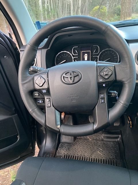

    The wheel looks great! Will be interested to hear your thoughts on how it holds up. I like the perforated leather.
    I went with the Tufskins carbon but chose the domed version. I thought I was the only one who doesn't care for the AGT stuff. :) The nice thing about Tufskins is its actual carbon fiber, as many aftermarket overlays are just printed CF look. A side benefit of the domed is its soft touch, which helps soften the hard plastic feel a bit in that area. I went back and forth as well, the matte felt a bit one dimensional, like just a sticker. You can see the difference in the domed pic below.

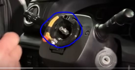

    Followed the video and got to the 5:18 mark. "You're basically going to pull and wiggle...and there's your steering wheel."
    Except mine had a jack in the box. Any idea how recoverable this is (as I'm frantically googling)?

    I didn't pull and wiggle for that reason. I bought a steering wheel removal kit from AutoZone for $35.
    That's going to be a pain since you'll have to figure out how to place the plastic ring back on and have enough slack on the ribbon cables to turn the steering wheel to the extreme left and right without putting stress on them.

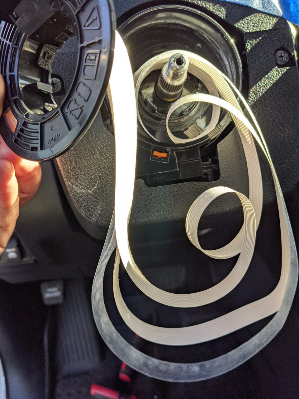

    Oh, it's not so bad. I do wish to cross-post a bit (correct me if inappropriate). My current position, as indicated in another post, after rewinding what I thought was still a operable clock spring:
    While removing the original steering wheel on my 2021 to replace with a leather steering wheel, I inadvertently popped open the clock spring cover and of course unwound it. It looked like there was not damage and I was able to wind it back and finish installing the new steering wheel.
    However, now I get errors on almost everything possible (BSM, TRAC, PCS, LDS, Headlights, Trailer Brake, etc). Any ideas on whether or not a damaged clock spring could be responsible for all of these errors?
    I would assume it would have to be the clock spring as I didn't touch anything else. I have left the battery disconnected for at least 30 minutes, removed airbag, steering wheel and check all connections to airbag and clock spring and they look good.
  12. Feb 7, 2021 at 10:11 AM
    #42
    Elduder
    Elduder New Member
    Apr 11, 2017
    #7206
    1,399
    Its possible, yes. The clock spring is just wiring to all the steering wheel buttons, so an open on any of the circuits to the wheel may cause a sort of bulk alarm signal. The LDS, TSS both are in that circuit and could cause what youre seeing.
    Do you happen to remember if you unplugged the center plug before pulling the wheel, as thats the only way I could see it pulling to cover off the spring itself. Otherwise, you may simply just have bad luck.
    I would purchase a replacement and replace it. Easier that troubleshooting it really.

    I did have everything disconnected. Dumb/bad luck. Had I used a steering wheel puller or just left the center nut on by a couple of threads, the whole problem could have been avoided.
    Good news, is that a new clock spring resolved all of the electrical issues!
    If you're considering replacing your steering wheel, don't let my mishap deter you! It's a simple process and with a bit of precaution you can easily avoid how it went for me.

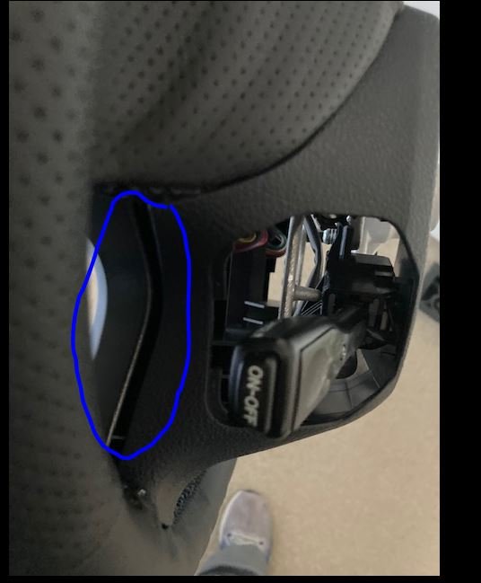

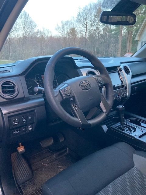

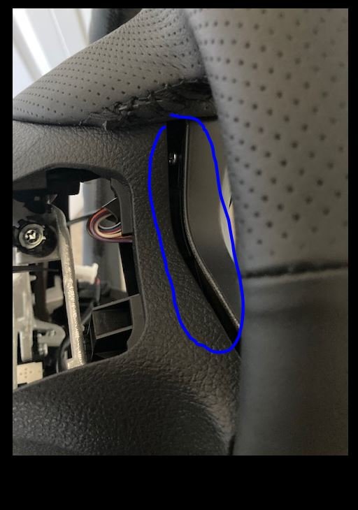

    Western Mass
    2019 Tundra Sport DC
    6112/5160 , SCS Ray 10's, Cooper Discover AT3 -295/70/18, Dirty Deeds 8inch, N-Fab Podium
    So the needle nose pliers did the trick, got the airbag out. Decided since I got the controls out might as well do the steering wheel swap with the one I got from @Elduder . Was a bit of a learning experience but I got the old wheel off ( used a steering wheel puller thanks to @nowdeprecated experience) painted the controls and then put them on the new wheel. One question before I put it back on as I didn't think to look. Is the space below on each side normal between the back plastic and the control pieces? There are only 4 screws and they are all in to attach the controls back and I believe I have the back panel on correct so I am not seeing a way to get them closer.
  21. Apr 3, 2021 at 1:56 PM
    #51
    1UP
    1UP Truck Gang
    Oct 21, 2020
    #53887
    2,547
    2019 Red CM TRD sport 4x4
  22. Apr 3, 2021 at 4:18 PM
    #52
    tundrasportinMA
    tundrasportinMA New Member
    Nov 7, 2018
    #21428
    174
    Western Mass
    Decided the spacing was normal or close to it so went ahead and put it on. Think it came out pretty decent.

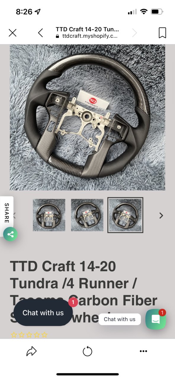

    Looking to do this as my stock 90k wheel is looking used. Found these on FB- anyone have one?
