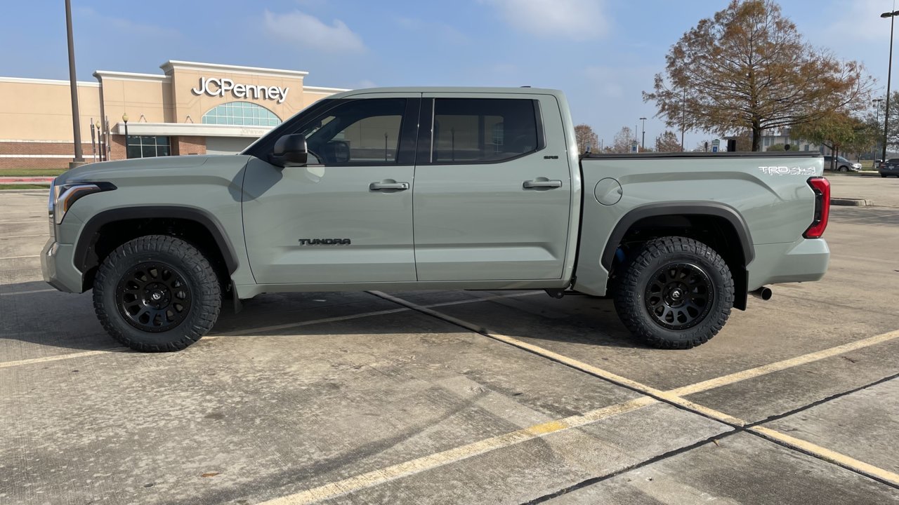

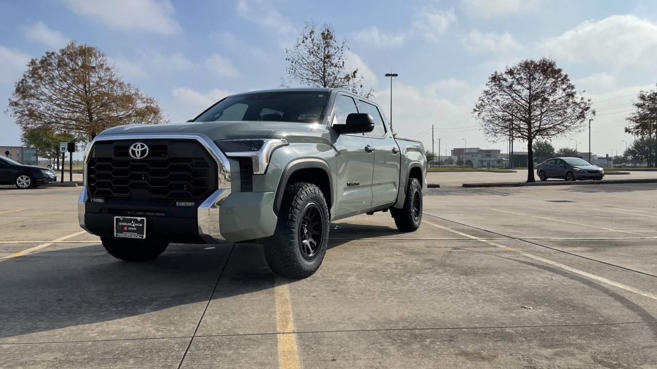

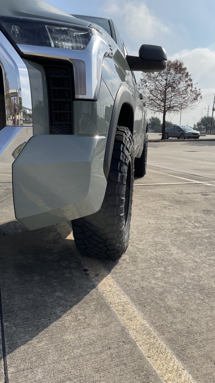

    Love that color. Wheels look great. Did you have any issues with the wheel sensors and/or valve stems? Discount Tire said they weren't able to transfer to the new wheels.
    Also, for some of the other questions I saw posted here, I put 285/65r20's on the stock 20" TRD wheels and there is plenty of room. I have an SR5 Sport Premium. On the new wheels (+18 offset) they cleared by 1/4 inch to the felt. If I pinned that back a little I could get about 1.5 inches. This is without a leveling kit. Here is the link to my other post for more details.

    Any pics of the +18 offset on the truck? Been trying to figure if I can run 285/75R18 18x9 +18 on stock TRD sport. Afraid it'll rub on TRD sport lowered suspension. If they can fit. I can at least run the wheels until lift kits comes out.

    I don't. We put one on with a 285/65r20 Ko2 but they couldn't transfer the sensor so I had to put the tires back on the stock rims. Your tires would be about the same size if not slightly bigger so you are right at point where a leveling kit might be needed. As I mentioned, I only had about 1/4 inch clearance. Although actual tire sizes labeled the same can differ by brand.

    I had no issues with the wheel sensors, they were able to move it over and everything is good :)

    that looks very nice

    New shoes looks good.... Nice stock Rig..

    Truck looks incredible, great combo. But you really need to work on your parking, you are taking up 4 spaces.

    LMAO! That was on a good day, usually it's 6 o_O

    Man that looks killer. Congrats.

    Great color combo

    Where did you find the mud flaps?

    it came with my truck
