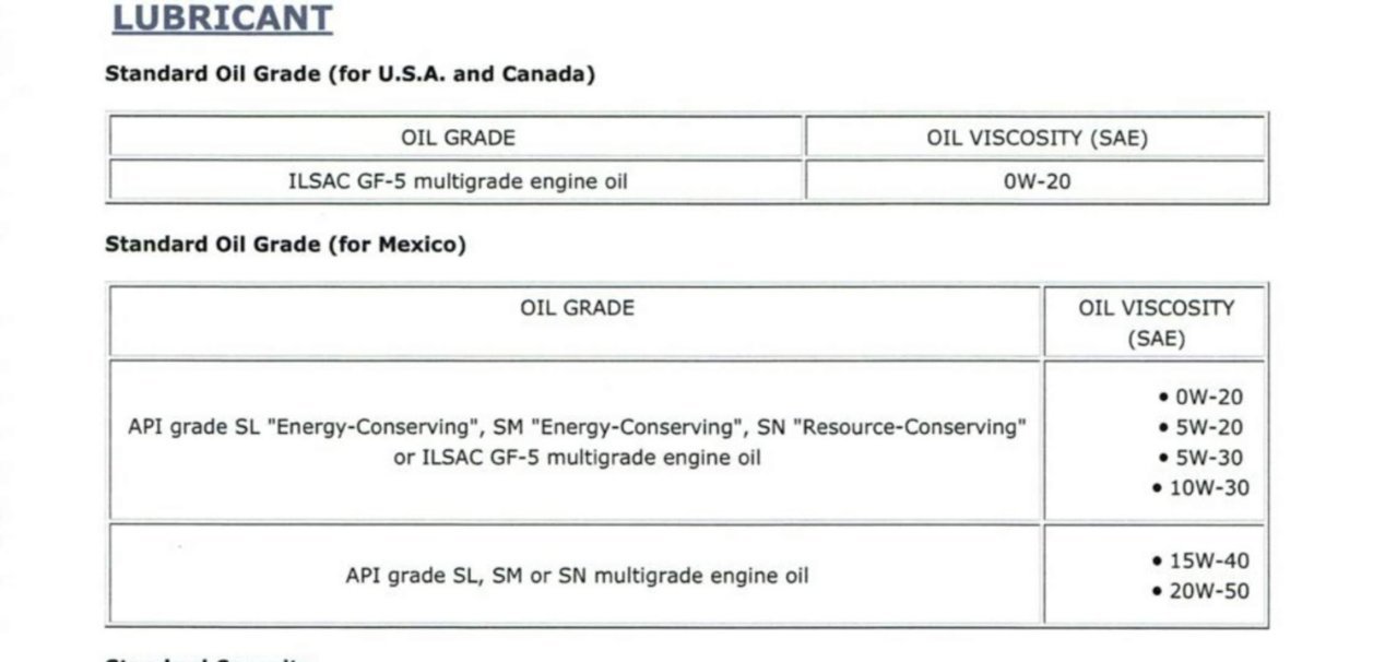

    Oil clearances? The 5.7 3UR-FE can run a many different oils. Its just only spec for 0w20 in the states for the EPA. The Tundras sold in Mexico with the same engine can run all these, and this is straight from Toyota.

    So what's the downside of just sticking with 0w20?
    That is interesting about the Mexico manual.

    Down side of 0w20 is it does not protect well in higher temps and because its so thin it has a higher chance of blow by. The easiest way to understand the difference of 0w20 vs a higher viscosity oil is the sound of the engine. Many people know of the tick sound the engine makes, well that basically goes away when you run 5w30. Also you get better oil pressure with the heavier oil according to my oil pressure gauge, when I run 15w40 it will tend to sit dead center rather than just below like it does with lighter oils.

    Well would you lookie here:
    I am going to go 5w30 in all my Toyotas next change. My truck only gets used for truck stuff and towing our 30ft trailer.

    Yup, the manual for the 1UR-FE in my Lexus is explicit that it must be 0W-20. They even say that if you are in a bind, you can run 5W-20, but must switch it back to 0W.
    But then you look at the owners manual for the Australian Land Cruiser and the 1UR will take anything up to xW-50 I think.
    I personally run 10W-30 in mine. It doesnt get super cold here in Utah and even then mine is always in a garage and so it usually doesnt have to start much lower than 32F
