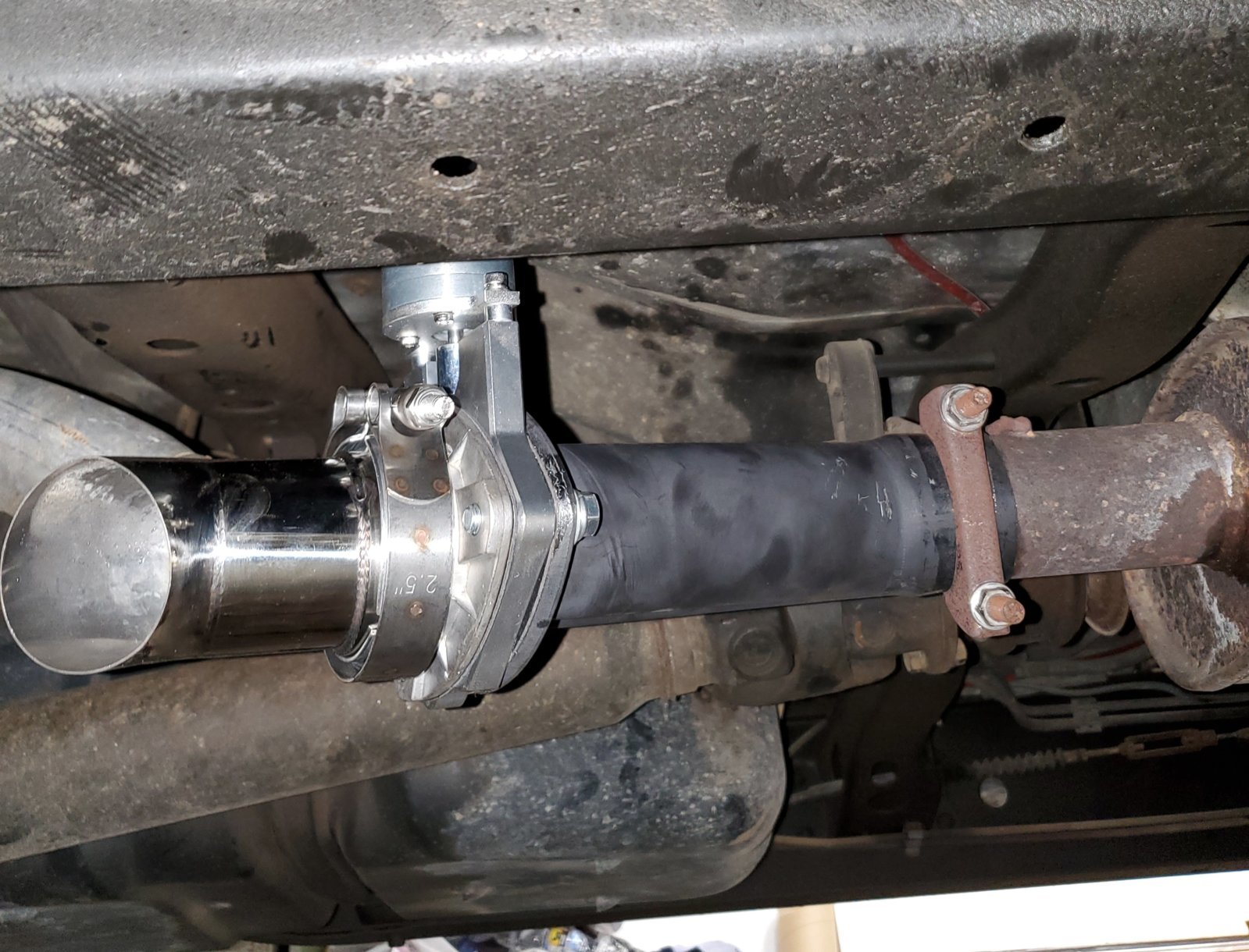

    I went with an electronic exhaust cutout after the resonator before the muffler. Minimal drone when open and completely stock sound when closed. Gives you the option of what you want at the flip of a switch.
