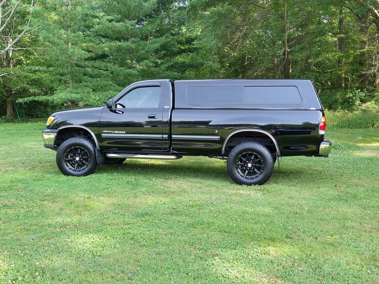

    The rancho leveling setup is only 2 years old so I am going to keep it for now. Intent is to replace worn front suspension parts with new. Ball joints tie rods control arms, brakes. I was looking at the Moog brand parts the reviews I read were favorable. Truck never goes off road really. The truck just turned 100K miles, I purchased from the original owner /w 77K 7 years ago. no real rust to speak of, they had already replaced the frame. I will check into OEM parts.

    Truck looks great!
