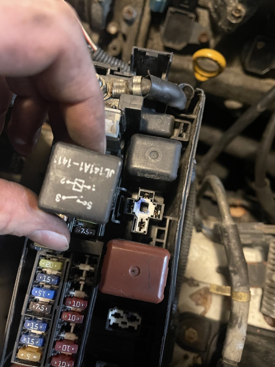

    So I’m just poking around with the multimeter again. The only leg of the starter relay that has connectivity to the starter, is also grounded….
    So as it’s sitting now…. No.3 on the relay is both grounded, and trying to send 12v to the relay….
    I really really don’t want to start unwrapping the entire loom, but I just can’t wrap my head around why that is…

    But I just rechecked all the contacts at the starter solenoid, since I couldn’t quite remember what was going on there.
    Leg 3 goes to the starter, and is also showing some resistance to ground.
    Legs 1, 2 and 4 are all hot with the key in the start position.
    So…. Tomorrow I’m just gonna start tracing wires back through the loom as far as I can, and hopefully find some stripped wires shorting against each other.
    I really can’t imagine what else would cause it
    If I'm reading this properly, 1 and 5 should be switched 12v, 3 should go to the starter, and 2 should just be ground.

    Impressive work OP. Question, if you remove the starter relay from the truck can you get it to click? Are any of the pins labeled?
  13. Jan 17, 2022 at 9:49 PM
    #163
    RainMan_PNW
    Oct 27, 2020
    #54134
    16,985
    Casey
    Clark County, WA
    2021 Lunar Rock TRD Pro CM
    Yes, with the key in START, you should have power at pins 1 and 5.
    1 is your main power to the starter (though the switched/high load side of the relay) and 5 is the coil power to activate the relay.
    2 is, like you said, ground for the relay coil to complete the circuit to turn on the relay.
    3 is the power out of the relay to the starter.
    I would start by checking continuity from pin to pin on each individual leg.
    For example, Pin 8 on I23 at the ignition switch to leg 1 of the 5A ST2 fuse.
    Also Pin 8 on I23 to leg 5 on the starter relay.
    Leg 2 of the 5A ST2 fuse to leg 1 on the starter relay
    Leg 2 of the starter relay to the chassis
    Leg 3 of the starter relay to pin 3 on connector 1L(?)
    While checking those, you can also check adjacent connectors to ensure you aren’t seeing low resistance, but that is likely a needle in a haystack.
    I don’t really know much about the Gen 1’s, but I always start with confirming continuity from point to point in the shortest/most direct paths possible. Looks like a hell of a project!
