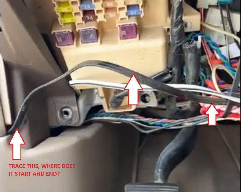

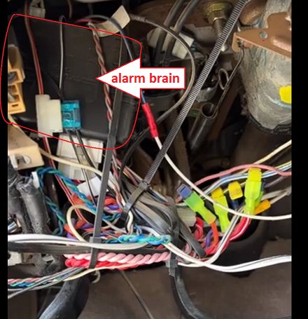

    • The birds nest of wiring is part of an alarm, it looks like to me, with the big black box at the core (brain, see pic below, please pull it out and get me some model numbers off the box and I'll fill you in on more details). And it's installed using the most heinous T-taps that mangle wiring sheaths, complete bullshit, whoever installed it is an asshole. If you're not confident removing, hire a shop, as it's probably hooked into the ignition circuit. They may've installed relays in the doors also, any trained person can restore this back to normal, paint over the wire casing breaches with liquid tape, or ideally re-cut/solder/shrinkwrap since the t-taps used compromise the wire integrity (I really hate people using those things instead of Posi-Taps!)

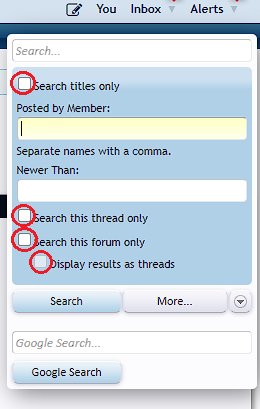

    Search works, but the thing is, if you just plug in keywords and click "SEARCH" you're doomed. It searches literally every subforum, for every generation, the sales forums, the audio, wheels, suspension forums, everything. That doesn't help when you need 1st Gen specific results.
    You MUST use the checkboxes provided or you're boning yourself. The middle two I circled here - especially "Search this forum only" - are super important to use. The others are just modifiers.
    Like, the main reason I was able to find @Hi06silver's Tuff Country thread is because I used the search term "Tuff", then put his name in the "Posted by member" box. then I checked off the "Search this forum only" and "Display results as threads" box to only show threads, not a bunch of replies.
    The key to using this forum's search is using the filters/options you're given, and always being aware of "where" in the forum you are (i.e. which subforum, so you're not using 'search this forum' while you're in the 3rd Gen subforum and getting non-1st Gen results)
