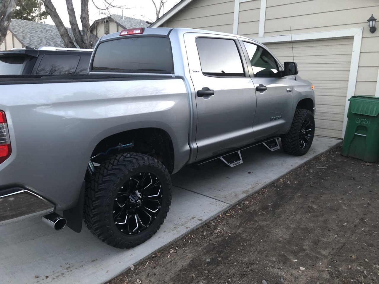

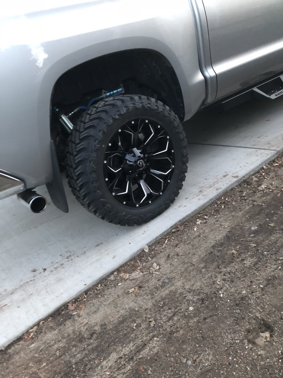

    nice ! looks like you have a pinch on the rear flexible though.

    What? Can you elaborate?

    maybe the angle of the picture. can you take us a close up ? between the shock and reservoir. the rear one. When I had my Kings on, it was straight. Looks like you have a slight pinch or angle. Possible whoever did the install didn't stretch it enough

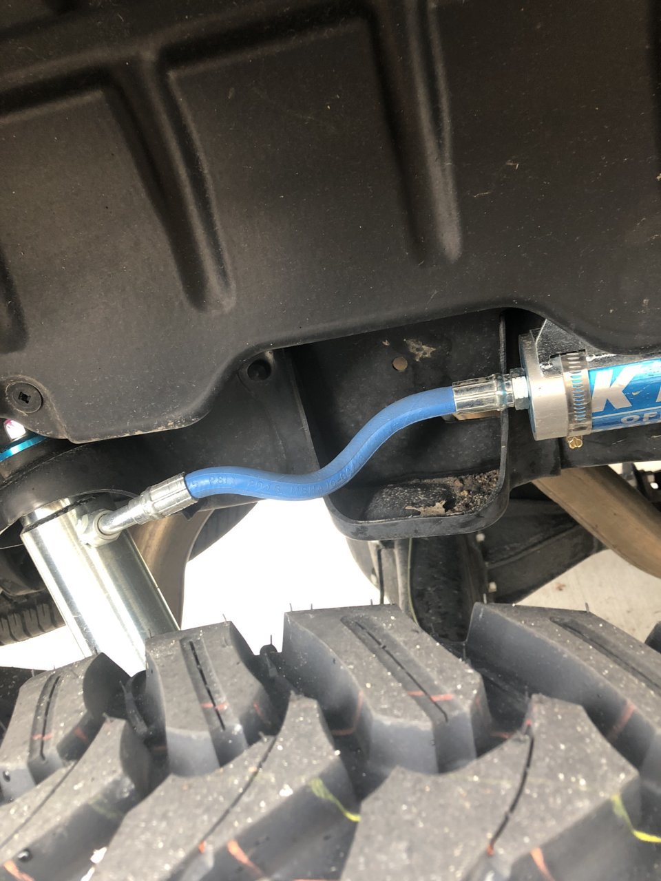

    It has slight bend, I don’t think it will restrict fluid. What are your thoughts?

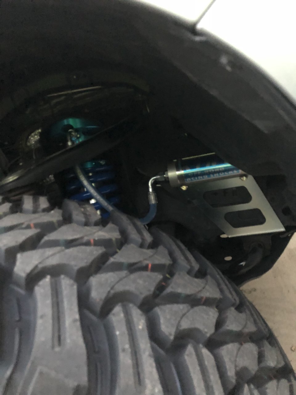

    oh ok it's not that bad. The first picture made it look worst. Maybe KING switched to a longer flexible. Can you snap a picture how the shop attached the reservoir ? I think you can probably move the reservoirs a bit more towards the front then tighten back the collars. should be good to go.

    I take another pic when I get home and see what you think! Thanks for the heads up tho I appreciate it!!

    It looks like the shock body just needs to be rotated away from the resi to straighten the hose out. Doubtful it will effect anything, but it would drive me crazy.
