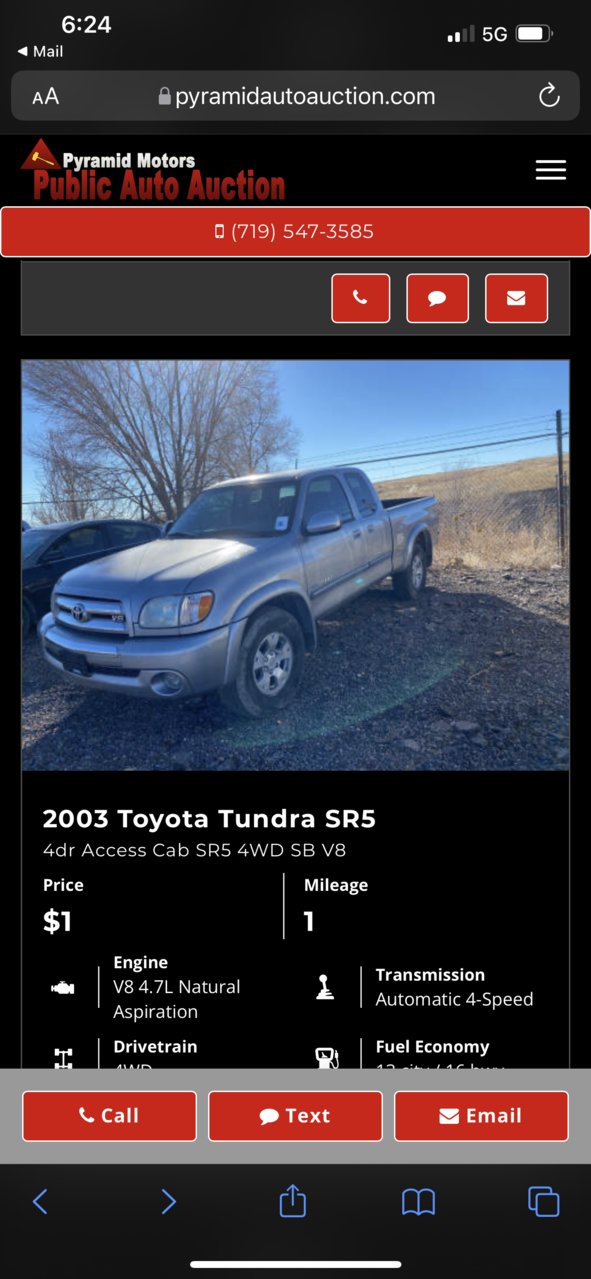

    Thanks for all the info gents!
    Looks like im off to the auction to see whats what. I see a couple options that may or may not be decent.
