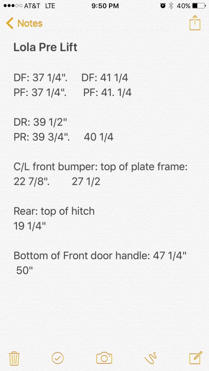

    I just put the Ready Lift 3/1 spacer kit on my Lola ('18 - 1794 CM)and couldn't be happier. Dimensions of change above....
    Went with a 305/55r20 and had VERY minimal trim to do with a +20 offset. Installed in my shop, after alignment it drives great.... Spent all my $$$ on the purchase so I had to go the poor' boy route for the lift
    Didn't know anything about lifts, offsets or Tundras in general until I joined here and the folks here helped me get thru it.
    Ended up with Bushwacker Extend-A-Fender flares and the tires are PERFECTLY FLUSH with the newly painted flares.
