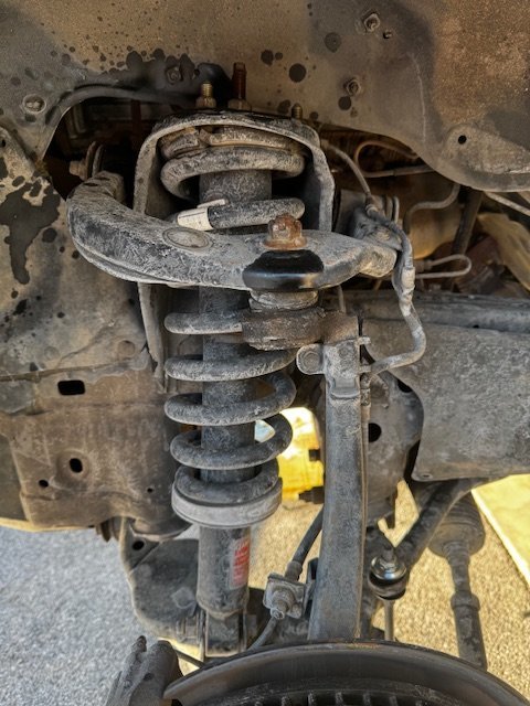

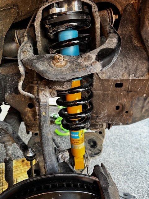

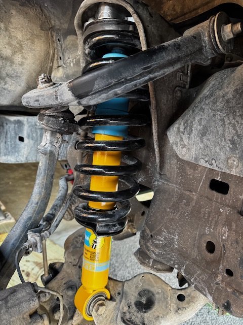

    I recently took upon the chore of replacing my shocks and struts, I went with Bilstein 4600s and added a 2" leveling spacer on the front. I know spacers are not the preferred method but seeing as this is a 2wd truck that I wouldn't take truly "off-roading" I figured it would be fine.

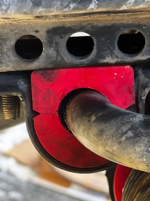

    I also installed new sway bar links and sway bar bushings, the bushings were from "the suspension dudes" and ended up not fitting right at all even though they said it was the right part for the truck. I have Toyota OEM bushings on the way.
    I am happy with the leveling and the upper control arm has had no limit issues when driving, although I will probably be replacing them with 2" to 4" lift capable UCAs in the near future.

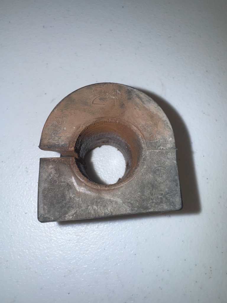

    I have attached pictures of the bad fit bushings, the old quick struts and the newly installed struts.

    The reason spacers are frowned upon is that the bumpstops wont reach to stop your shock from bottoming out, or coil bind…not sure which happens first. Coil bind isnt too bad, but bottoming out the shock could damage it.

    Watch that video ^^
    Ditch the spacers.
    And please, if you haven’t, read the sticky “so you just bought a 1st gen” thread, the Suspension section specifically. It’ll warn you about spacers, and more yet, why you never mix spacers and suspension lift. If you’re just leveling w/spacers, you don’t need new UCA, and probably don’t need extended links. And if you intend to add lifted suspension, you NEED to get that spacer out of there.

    Looks like OP has the 23mm sway bar and they sent him the bushings for the 27mm sway bar.

    you're upper ball joint hates you and is about to leave the chat

    In addition, if there was ever a case for OEM CV axles, this proves it to be true with great visual reference.

    That billet spacer should likely give that truck about 2.5" up front
    With that spacer AND the front end jacked up, yes the ball joints are at a pretty bad angle but when you put weight on the vehicle, it will get better
    The sway bar bushings you got are for the larger sway bar. There are multiple different diameters, a truck like yours got the smaller diameter sway bar. The double cabs got the larger diameter sway bar. Being that your 2003 was pre-double cab, the person selling the bushings should have known you would have a smaller sway bar.

    @GuiltySpark after seeing the photos Bubba posted, that's seriously fucked up.
    You need to get that spacer out of there STAT. What you're seeing is exactly why we tell people never to mix spacers and suspension lift. You're putting so much strain on the knuckle and UBJ, you're asking for a disaster, you don't want to be THIS GUY, he's lucky he only bent his shit up, only needed to spend a few hundred dollars on new knuckles.
    The angles on your CV axles are enough to kill them in short order, you can crack the UBJ provision on the knuckle, snap the UBJ, bent the upper part of the knuckle. On the CV axles, 'extended travel' axles won't help. Maybe if you spend $800/ea+ on the higher-end TrakMotives they'll hold up.
    Listen to the advice on here. Don't fall into the trap that you "know better" or "I'm not hucking it, so it's OK", or "it's only 2WD/street, no problem". You're dead wrong, and asking for an accident.
    If someone did that work for you, stop going to them, this is all basic shit they should know. If you did the work, pull that spacer, and let's use this thread to talk about how to correct your shit.

    Also it's not so much about the truck at static ride height. It's about when he goes over any bumps.

    Yeah, i agree, that is a tall spacer for sure, like i said probably good for +2.5" up front. Definitely too high for me.

    His UCA is basically sitting at the same position mine are at full droop. HE may have all of an inch of downward travel. Those 4600s are going to pop like a grape in no time flat.

    I appreciate all the information, and I am posting on this forum because I absolutely do not "know better" lol. Thankfully it is 2wd so I am not worried about CV axles. Also after I put the weight of the vehicle back on the suspension the angle of the UBJ was not too concerning, and I have not felt any knocking or bottoming out of the shocks.
    However, due to the very strong feedback on this post I will probably be removing the spacers and just riding stock height with the new 4600s. In the very far future (I imagine these new Bilsteins will last a good while.) I may look into lifting it slightly the proper way.
    Also I'm not sure what you mean by mix spacers and suspension lift, I thought the 4600s were OEM height?

    Yea I could tell almost immediately that they were not the right ones when I was putting them on, I have OEM bushings on the way from Toyota and I made sure to match the part number (48815-AF021) that was on my original bushing.
    Also the originals have a big "24" on them, would there be a 24mm version of the sway bar?

    You're correct, I was misremembering. Should be 24mm but you can always take a digital caliper to your sway bar to confirm. The earlier trucks have a smaller sway bar, while the later trucks have a 27mm and the Sequoias have a 28mm.
