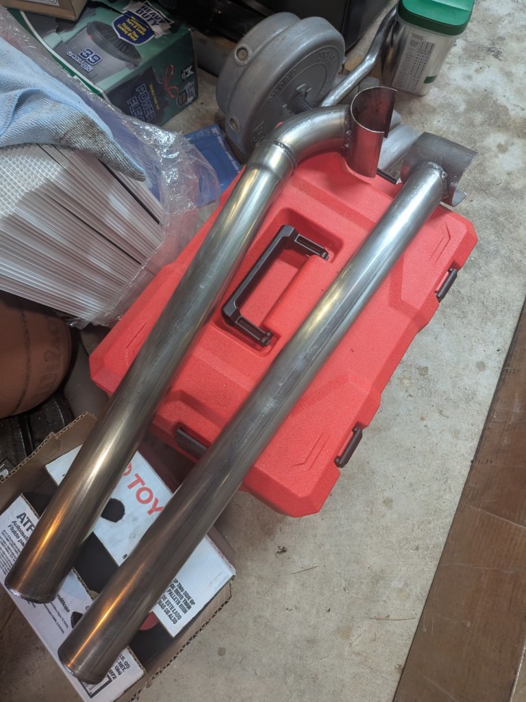

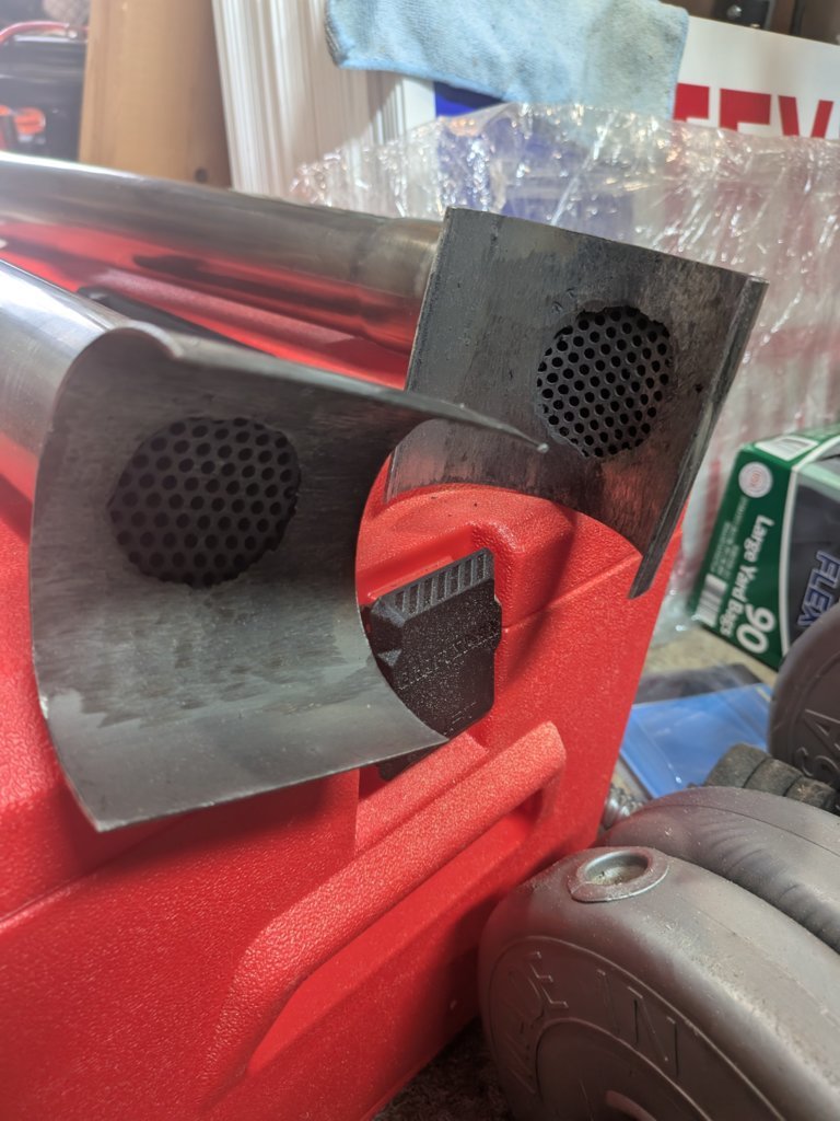

    Just got back home to find these puppies waiting for me.

    Intrigued, fer sure.
    Is this a pair of SD Hemholtz resonators that are fit for an SPD dumped system? Looks like one for the driver side that hangs flat and the one for the passenger side rolls up and over?
    Im really interested to see what this does for you.

    Keith made them for the SPD dump. I had a shop install some ARH cats I had laying around and that cut about half of my drone out, but I want even more snuffed out so I called up DD to see what he could do. You're correct in your assessment of how it will look.
    I will most likely get it installed next Friday.

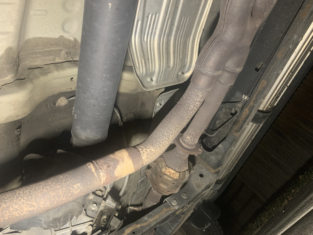

    You can see that the passenger side bank still has the existing flange. The driver side, however, was modified two different times. The first modification was done five or six years ago by cutting and extending the tubing just under the driveshaft in order to line up the midpipes with a Delta 50 muffler I had installed at the time. The second modification was last year when I had the exhaust shop stitch in my x pipe, y pipe, and single 3" muffler. Apparently they deleted the second flange and pushed the x pipe forward as possible.
    Even though I've crawled under there dozen times since then and I inspected their work before they even dropped it off the lift, I didn't realize they deleted the flange until a short while ago. Which means the SPD downpipes won't bolt directly to my existing setup; which is for why I was looking for those flanges - or at least one flange. Though, looking at it now, I think I would need to change the entire system and at least move the X pipe rearward. I guess we shall see...

    Hit up a scrap yard and scavenge what you need then have a shop weld it on.

    None available locally. I tried... haha. I'm sure the same part is available on other models, but I'm too lazy to search.
    I'm not opposed to having the muffler shop source one and put it on, but they will throw me out as soon as they see the Helmholtz resonator. For some reason, that part triggered the new owner last time and he pulled the truck off the lift, handed me the keys, and asked me to leave. Been going there for 15 years. Gotta find a new shop.
    I suppose I can arts and crafts time the flange from an existing flange, but since they welded the driver side on I can’t simply unbolt the mid pipes and slip a piece of cardboard between them. I guess I could do it with a new set of downpipes...

    A replacement flange, in mild steel, is Walker 31879 https://www.amazon.com/gp/product/B0015KWFAM/ The hole in the flange accepts 2-1/4 to 2-3/8 pipe. I ordered a couple of these to use with my system but decided to have some milled from stainless steel using my own design. I was gonna say if you want to let me know what diameter of pipe your catback uses, I can adjust my design and you can use it to order a flange... but it looks like your X pipe is too far forward to simply cut the pipe ahead of the X and weld on a flange. Here's the stock crossover on mine for reference, there's about 6-8" of pipe after that last bend to the flange:
