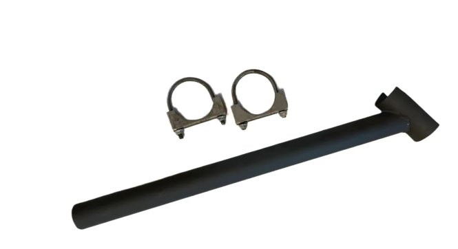

    Spoke to Keith yesterday and sent him pics of the pipe dump over the axle along with measurements. He is fabbing up a couple resonators for this particular exhaust similar to what he has available on his site:
    They will mount on the downhill slopes of both tailpipes and aim in the direction of the driver side. Will update with more info once they arrive and I get them installed. He estimates a 20-50% drone reduction.

    I dumped mine I put the hemholtz before the muffler. When I spoke with him he said he gets a lot better reduction after the muffler.

    Yep, and since there really isn't much pipe coming out of the muffler on this system, the best position for them is coming down from the highest point of the bend over the axle (per Keith). He even had Terry, his shop guru, in the background of the phone call discussing placement.

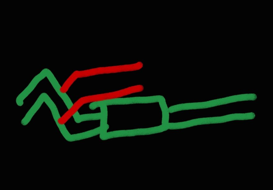

    That's about the only place you can put them and clear the spare tire when they are positioned 90deg to the direction the tailpipes are running. On the uphill portion, youd have potential interference with the driveline or fuel tank.
    I figured if drone was bad on my system, I'd tap into the uphill portion but run them forward the front parallel to the rest of the system using some elbows, similar to Magnaflow or TWC solutions.

    Initially, he was planning to put them there (on the incline). I don't have a spare tire mounted on the underside so I have plenty of room in the aforementioned placement. The resonator going on the passenger side pipe will have a "T" mount with the resonator bending 90 deg toward the driver side. It'll look pretty funky but no one will be able to really see it.

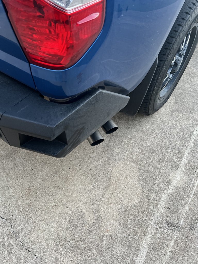

    What tips did you have?

    He'd need to know the angle of the incline though.

    He's built many systems like this before so he understands the design. The first idea he was bouncing around looked like your picture, but it got scrapped for the post-bend placement.

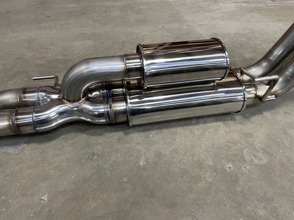

    You could run this with a helmz in the x-pipe like they do for other kits. And the direction doesn’t matter. We’ll be doing a straight pipe opposite direction on the old man’s exhaust
    JMGmanAZ, MVRCA, blenton and 4 others like this.

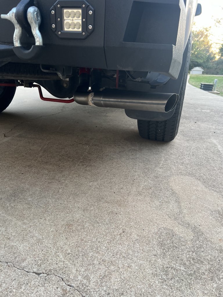

    Just some I built out of 3”.
    Mdl likes this.
