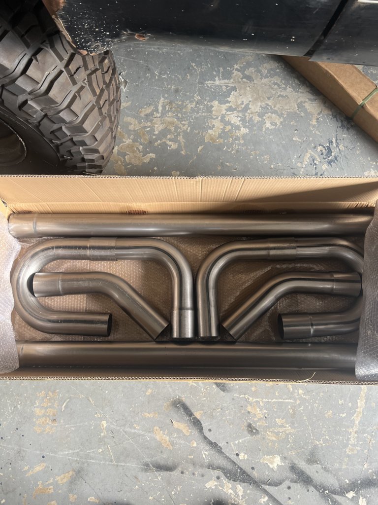

    Gonna see if I can come up with some type of exit for this system. Worst case I use this to build the exhaust for my k5 crawler.

    Two 45’s are about perfect. Got two more delivering tomorrow.

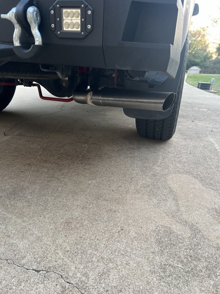

    My 45's just showed up. Looks like it'll be perfect. Gonna clamp everything together and see how it does and then order a couple of tips to bring it fully out past the fender.
    Silver17 likes this.

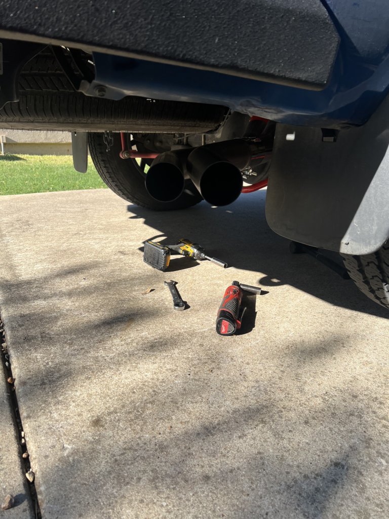

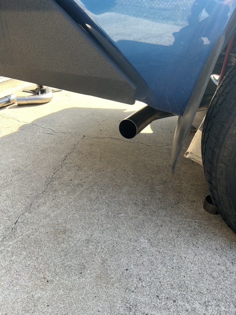

    Proof of concept right here. Initial start up and rev’s show it’s gotten the sound outside and not inside. If this works I’ll weld it up and make them even and get some tips on there. They look low but they are about an inch and a half below the fender. It looks like with some finesse from a hammer I can get them a bit higher.
    RobertD and Silver17 like this.

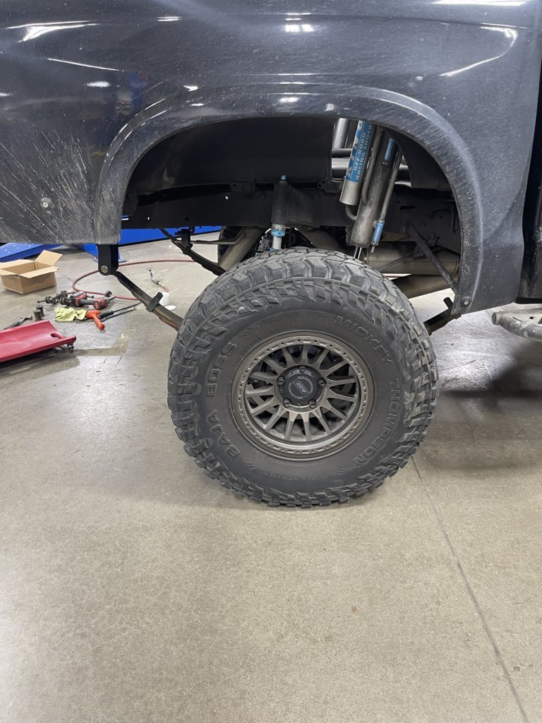

  21. Nov 11, 2024 at 1:40 PM
    #741
    reywcms
    reywcms [OP] New Member
    Dec 20, 2021
    #72040
    7,227
    Rey
    North Plains,Oregon
    2017 Tundra Platnium
    Too many mods to come
    Yes, with shocks through the bed. Actually moving to larger rear shocks, and bump stops along with reworking the bedcage.

    Got them tacked up. Didn’t come out as level as I wanted but look ok. Should be able to weld them up tomorrow and see how it works.
    RobertD, Torque and Silver17 like this.

    Nice. So no difference in sound with this setup vs without the tailpipes?
  24. Nov 11, 2024 at 5:25 PM
    #744
    centex
    centex New Member
    Nov 27, 2022
    #87464
    2,054
    Sound wise not at all. Pipes are all still equal length give or take an inch. I emailed SPD about it and they said the equal length only matters prior to the merge at the x-pipe. I’m just trying to get the volume down in the cab. It’s not bad but towing uphill or cruising at 85mph and it can get loud. Also, I like to tinker.

    Did the tailpipes help any with the volume?
  29. Nov 14, 2024 at 6:22 PM
    #749
    centex
    centex New Member
    Nov 27, 2022
    #87464
    2,054
    Mostly. Right about 1800rpm it gets loud inside but still the same 80db level it was before. Above or below that it’s dead quiet.
