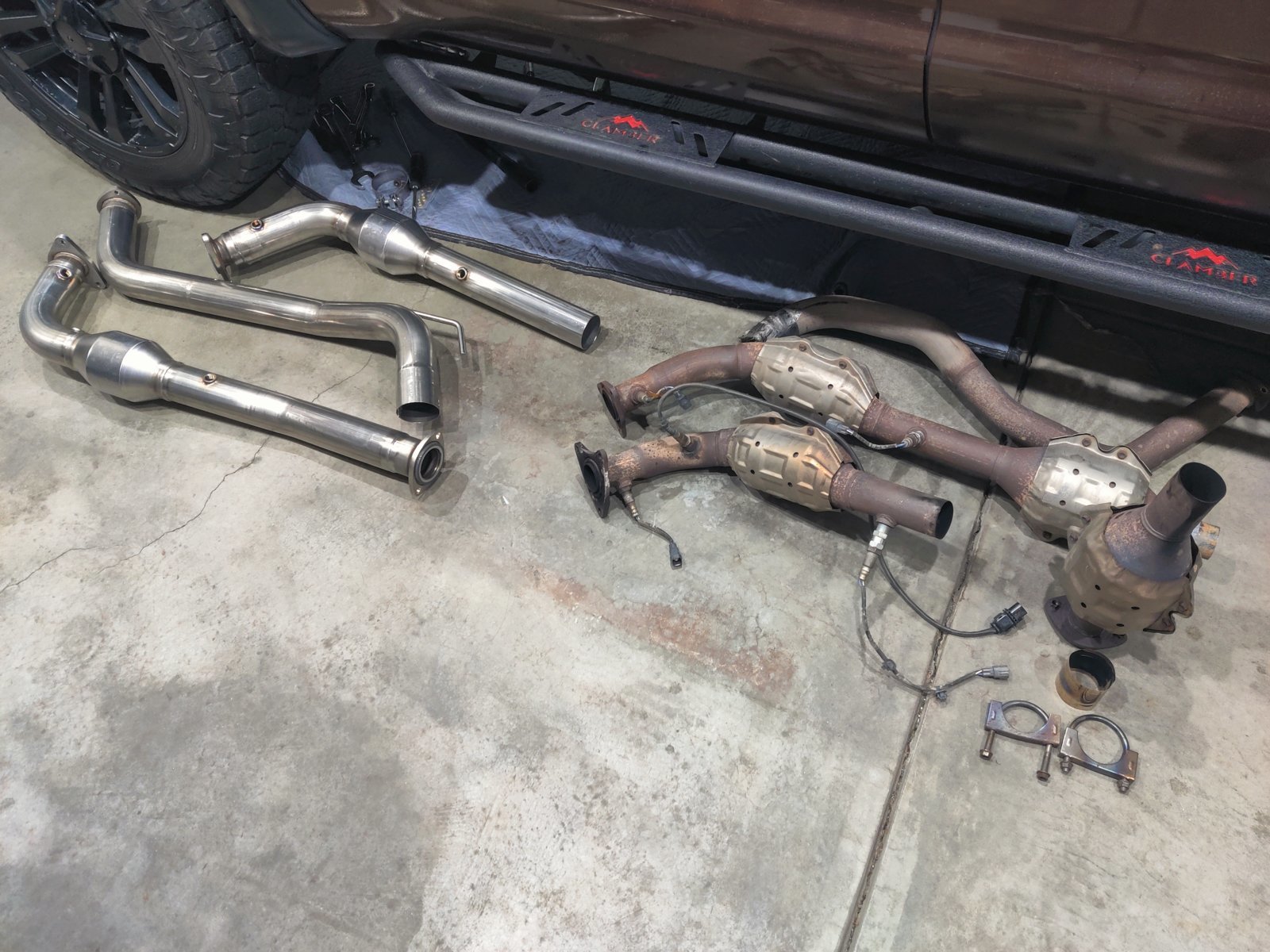

    Said F it tired of looking at the box. Old shit catted stocker vs SPD's

    DPs in was bitch because I stripped one exhaust mani bolt smh. This thing sounds gnarly ASF! And I'm running just the DD 10! Also notice mad amounts of oil smoke, DPs must have had a lot of oil in them for they're clearing out now.

    The pipes had oil in them probably from the bending procedure. It burn pretty damn good had me scared for a second but went away after long idle and some driving around.

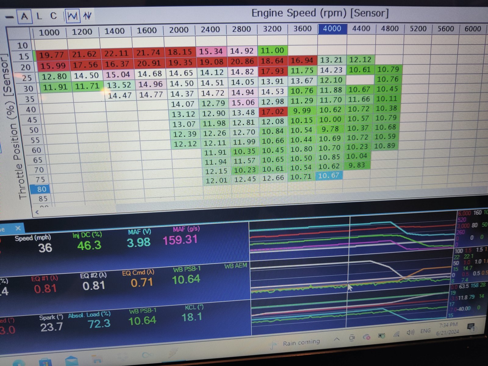

    Logged data around and it seems to be running a little leaner on WOT. Not much since I was running the stock 2 cats but these bitches flow way more. I'll dig into the data once I get a chance but I was seeing 10.6-11 on the psb1

    Correct oil from the fab procedure and it should lean out a tad since it's flowing more.

    Not bad overall but a bit off target when building boost off the start and a tad leaner up high. Granted only to 54% InjDC max I did not do a 4th gear wot log until I get to my dragstrip in Mexico tomorrow
