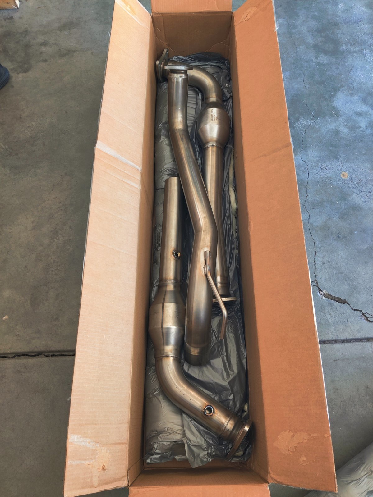

    Amazingly well packed, they look amazing. What do I need to look at to see if they will bolt in or I need a shop?
    Thanks Rey & SPD!

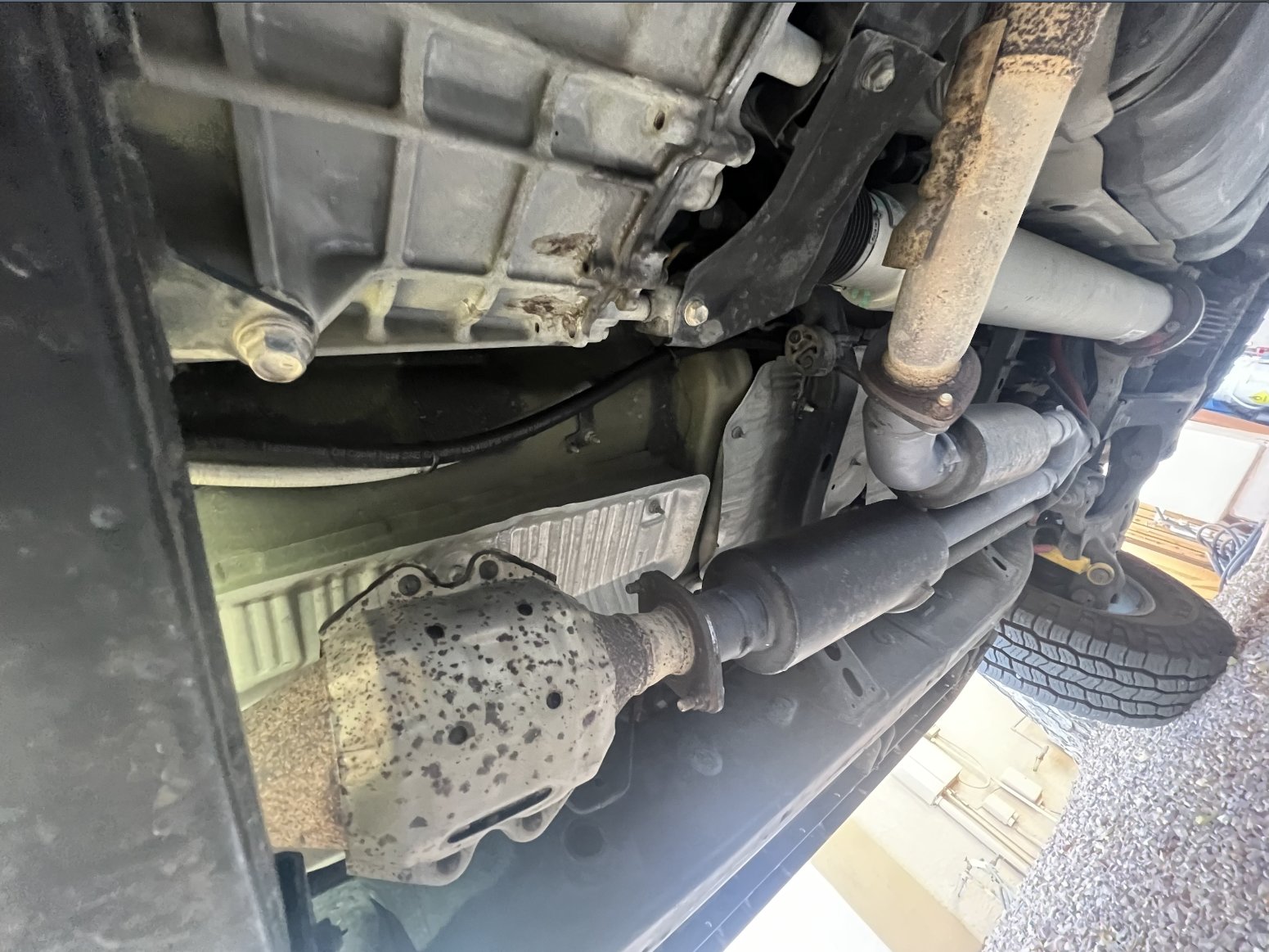

    Am I wrong thinking I need a shop?

    No, not wrong, your driver's side cat-back connection looks like it is a different angle than the new pipes, so will need some cutting and welding.

    Looks like Toyota kept the sequoia flange connections consistent with 07-09 tundras instead of changing it to the 2 straight flanges like 2010-2021 tundras.

    Nothing like uniformity between models...just have to wait a little bit longer.

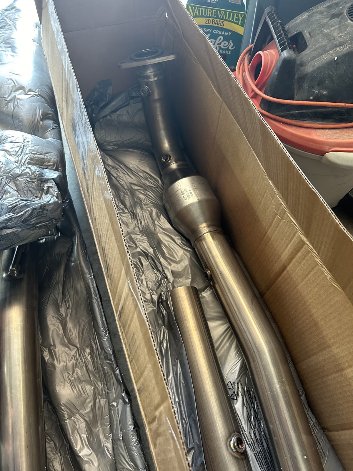

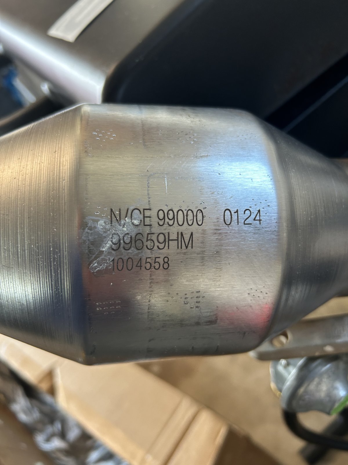

    After a five day camping trip came home to these bad boys! Gonna pop them in this weekend and see how she performs!

    They are ceramic cores. I believe 400 cpsi. I had 400 cells for a a little back pressure.

    I found em! Sorry to clog the exhaust thread lol
