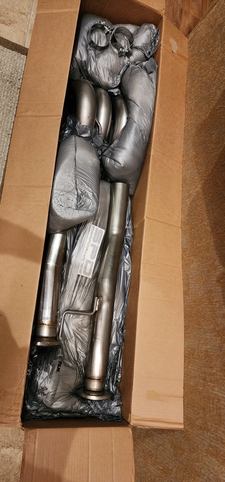

    I just got mine after 3 weeks, thank you reywcms for starting the forum discount.

    Received, excellent packaging. I’ll have to install this weekend when it cools down. 104 outside today.

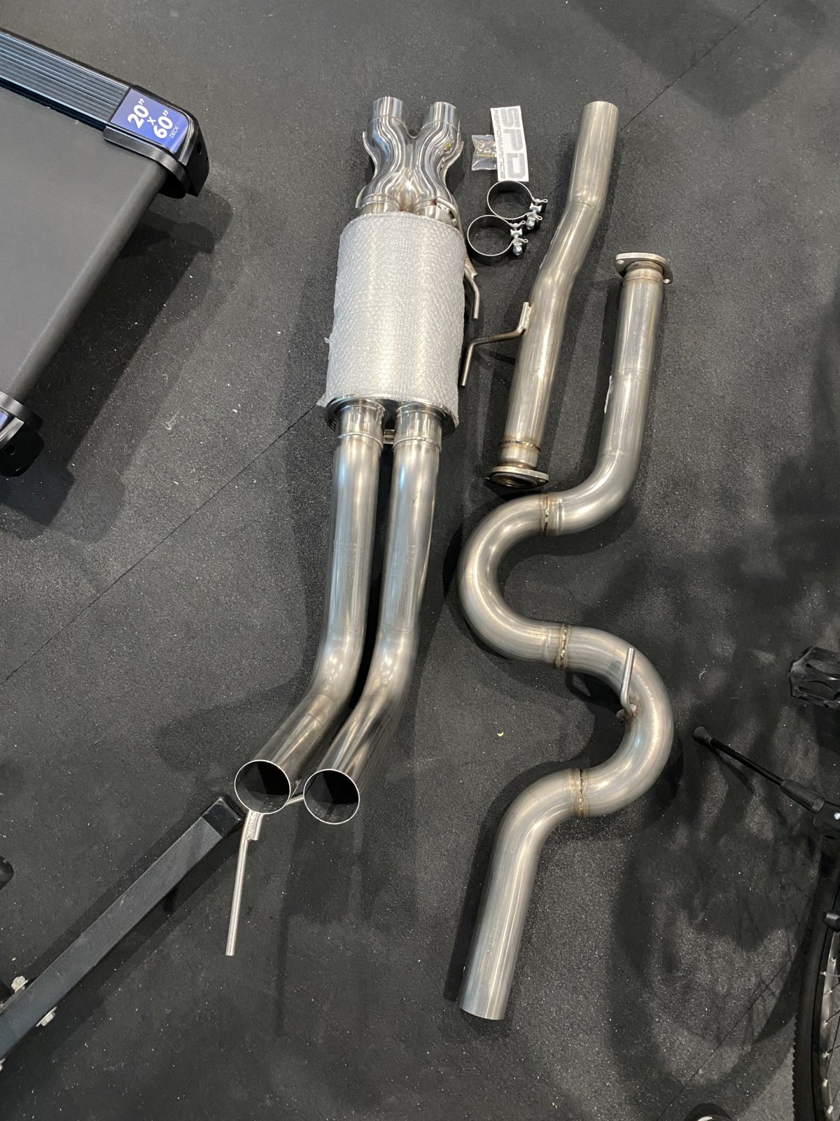

    The catback came with no instructions and I can’t see any online. I realize it looks straightforward but is there anything I should know before I crawl under there? @JMGmanAZ

    I used a small ratchet strap hooked onto the muffler to pull the x pipe into the pipes while everything was hanging. Used a rubber mallet and gently tapped the pipes until they seated completely into the X pipe, then tightened the clamps. Hope this makes sense.

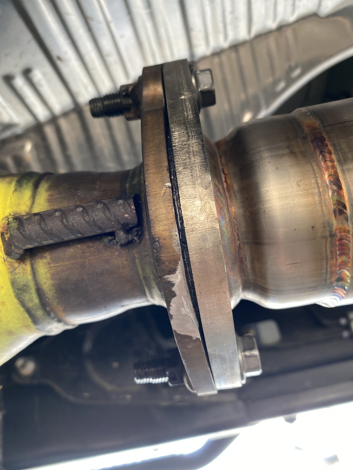

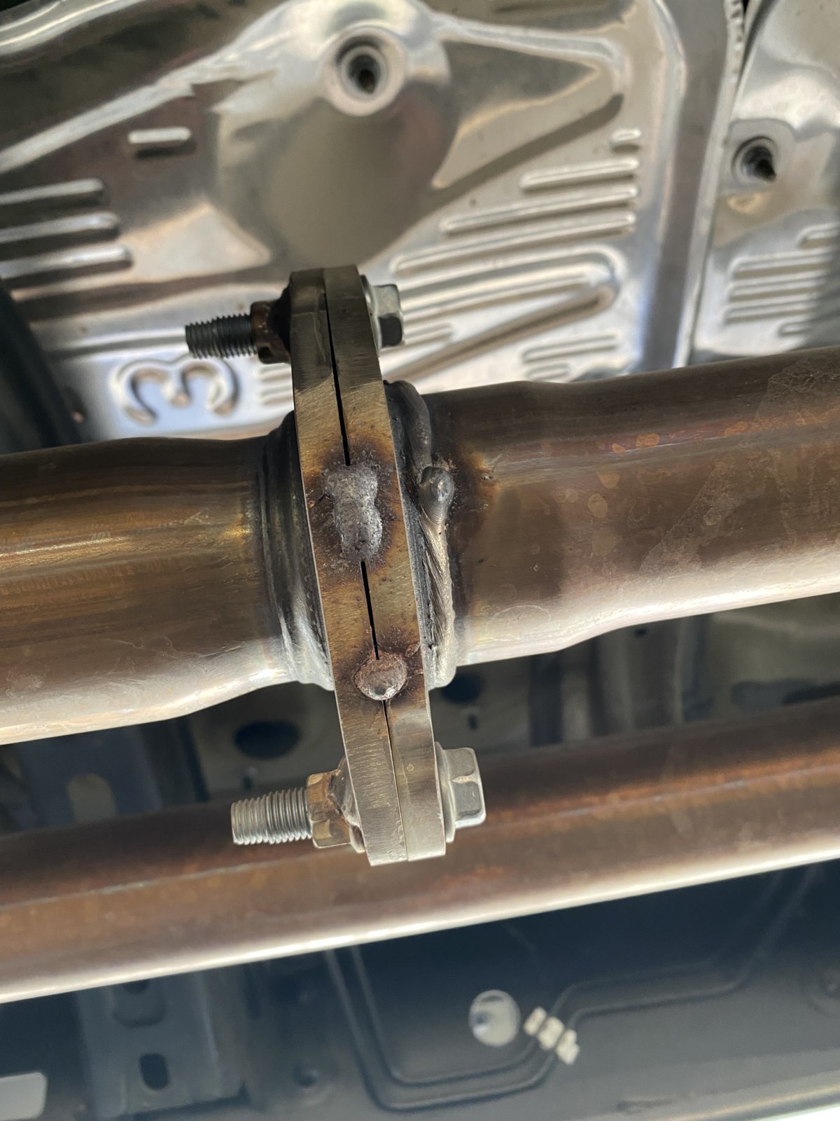

    Running into an issue. The muffler section is tack welded to the down pipes.
    e30cabrio likes this.
  18. Jun 8, 2024 at 10:56 AM
    #318
    B.Ross
    B.Ross New Member
    Aug 6, 2016
    #4106
    711
    Southern Utah
    2012 TForce CrewMax 4wd
    I hung the muffler first, then pipes. Sprayed some lubricant on the rubber muffler hangers as well.

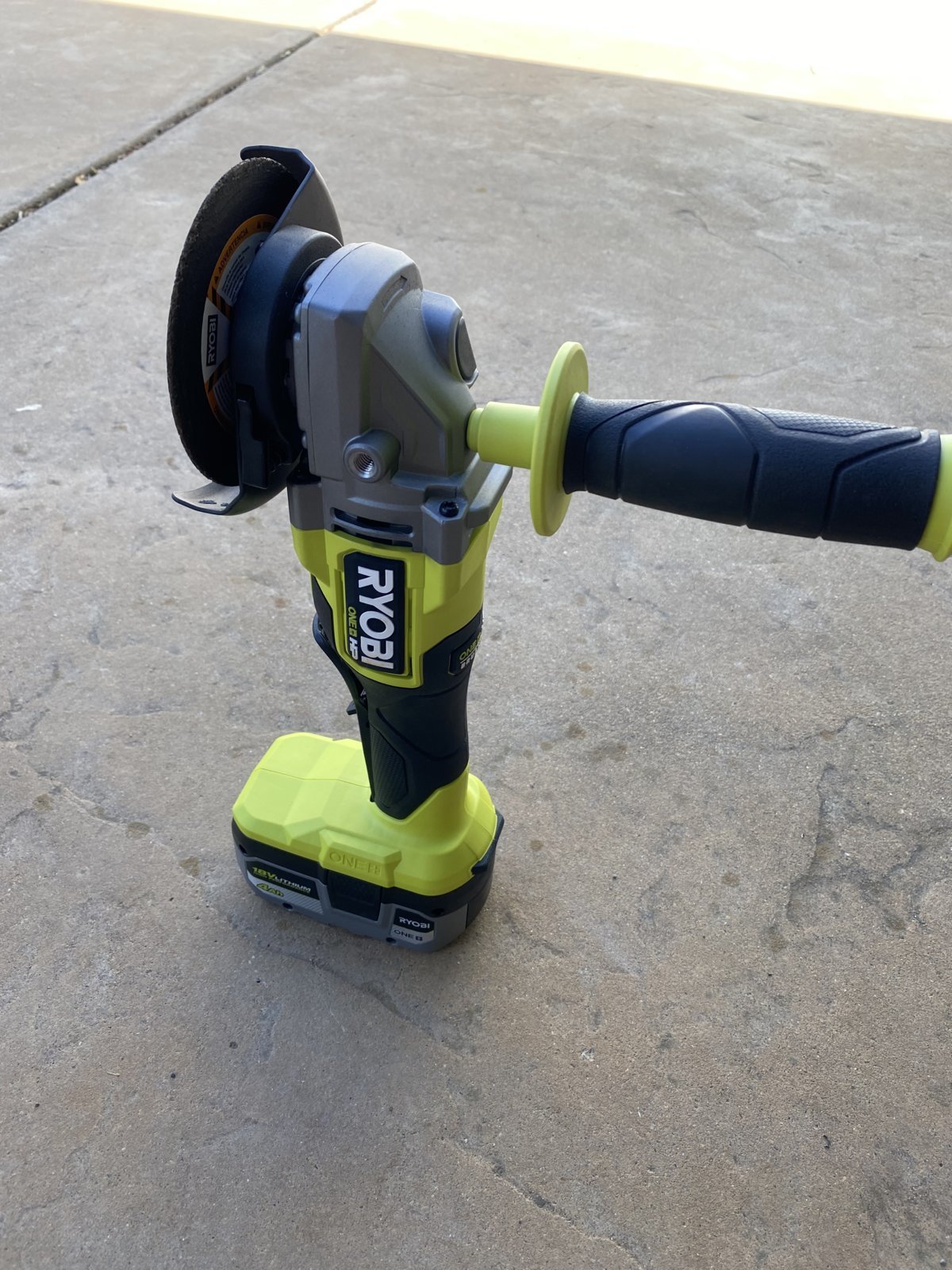

    Edit to add : looks like a grinder and cut off wheel is in your future.
    e30cabrio and 2TunGet1[QUOTED] like this.
  19. Jun 8, 2024 at 11:00 AM
    #319
    reywcms
    reywcms [OP] New Member
    Dec 20, 2021
    #72040
    7,229
    Rey
    North Plains,Oregon
    2017 Tundra Platnium
    Too many mods to come
    Grind those tacks off and continue

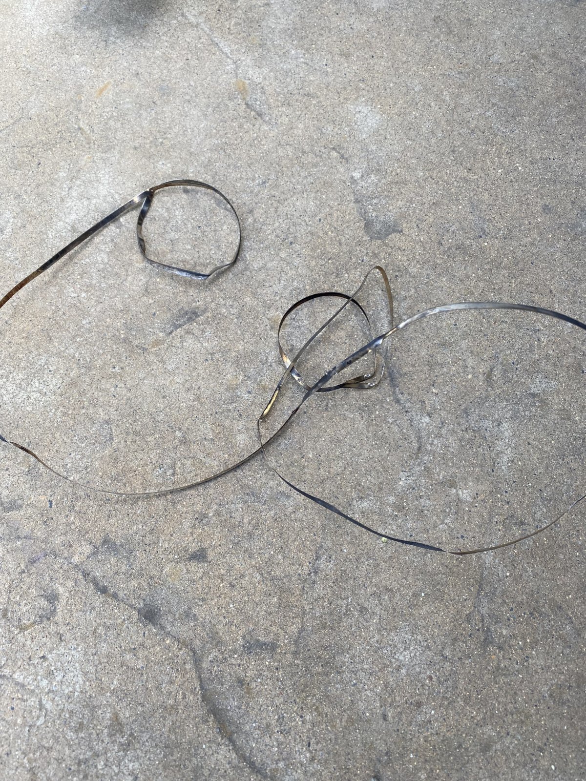

    Got everything off. I noticed this metal strip thing on the ground after I pulled the muffler off. I must have been rolling my creeper over it back and forth. What is it? Do I need it?
  23. Jun 8, 2024 at 12:15 PM
    #323
    reywcms
    Dec 20, 2021
    #72040
    7,229
    Rey
    North Plains,Oregon
    That’s the factory exhaust gasket. You shouldn’t need it as the new system has gaskets
    Mdl and e30cabrio like this.

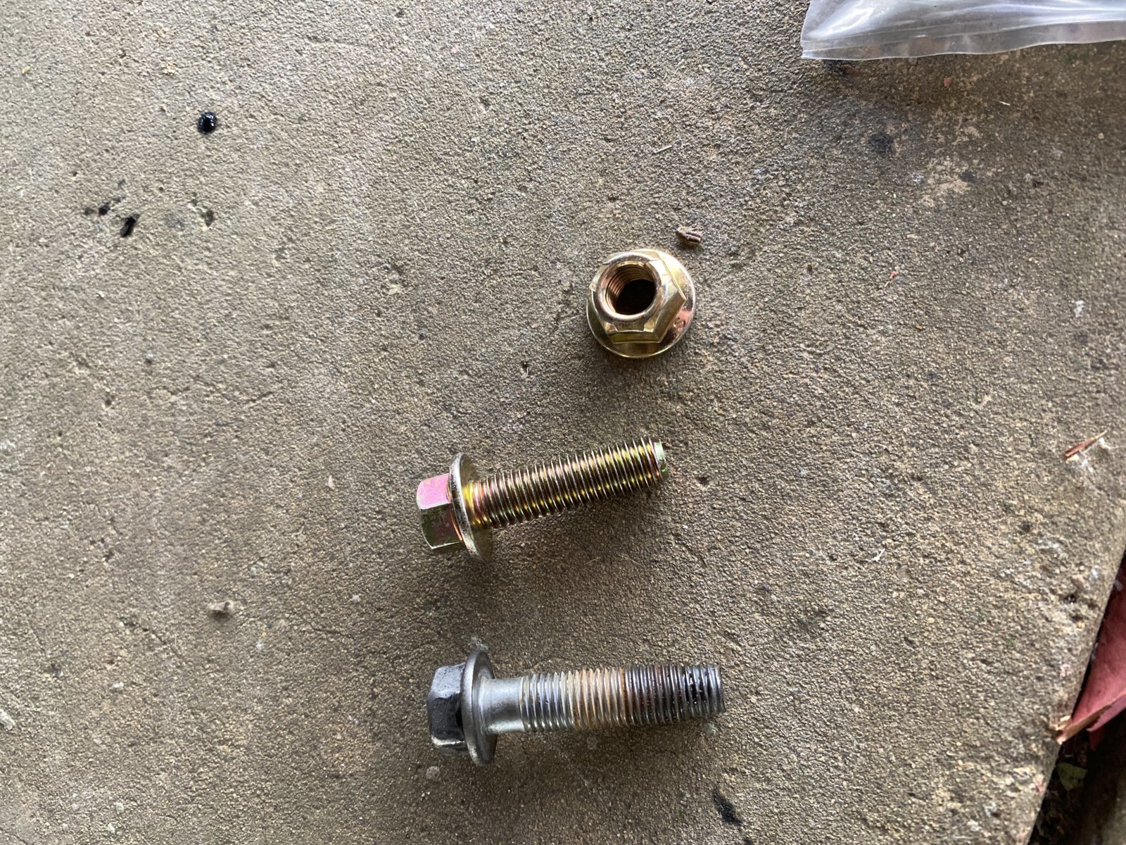

    Do I reuse the stock bolts or use the included gold ones? Why did they include nuts? The stock down pipes have threads welded on already.

    you can use whichever you’d like. They included them incase the welded units are no good. Also you want to hang the full system loosely and make its all in place etc then tighten all the hardware from the front to the back

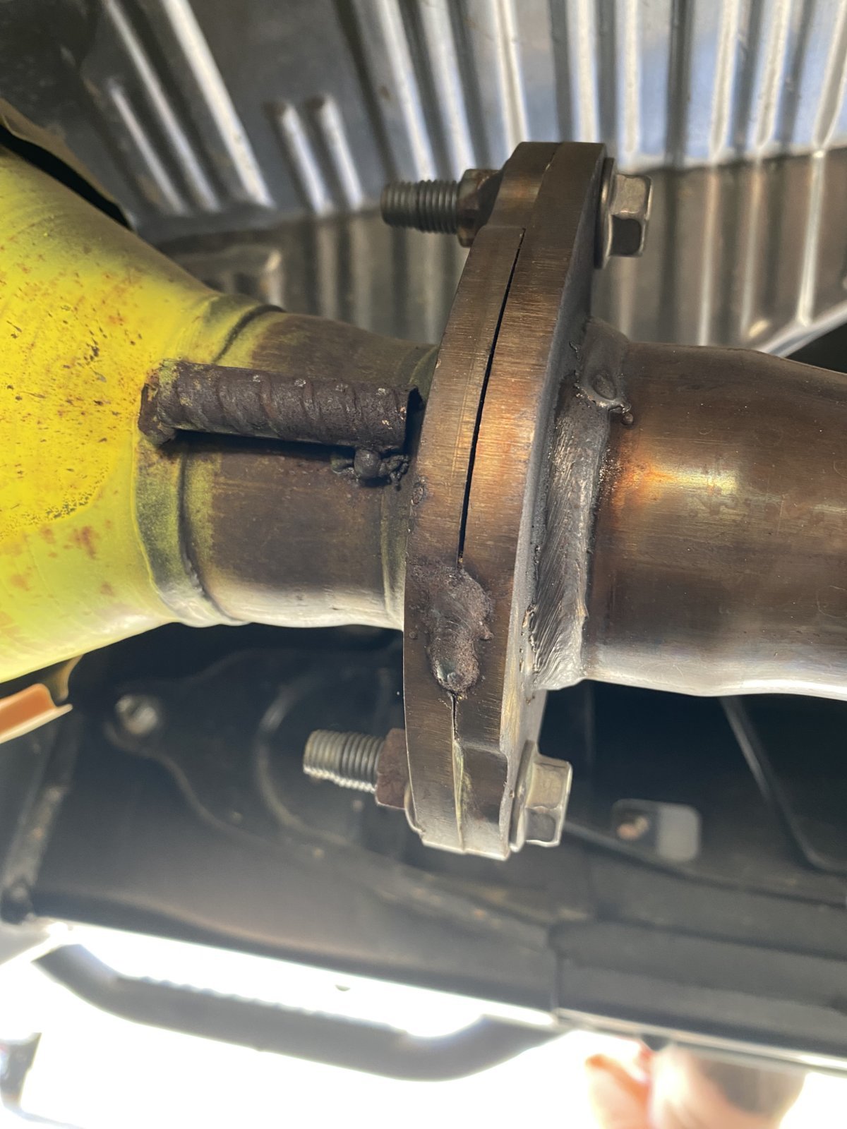

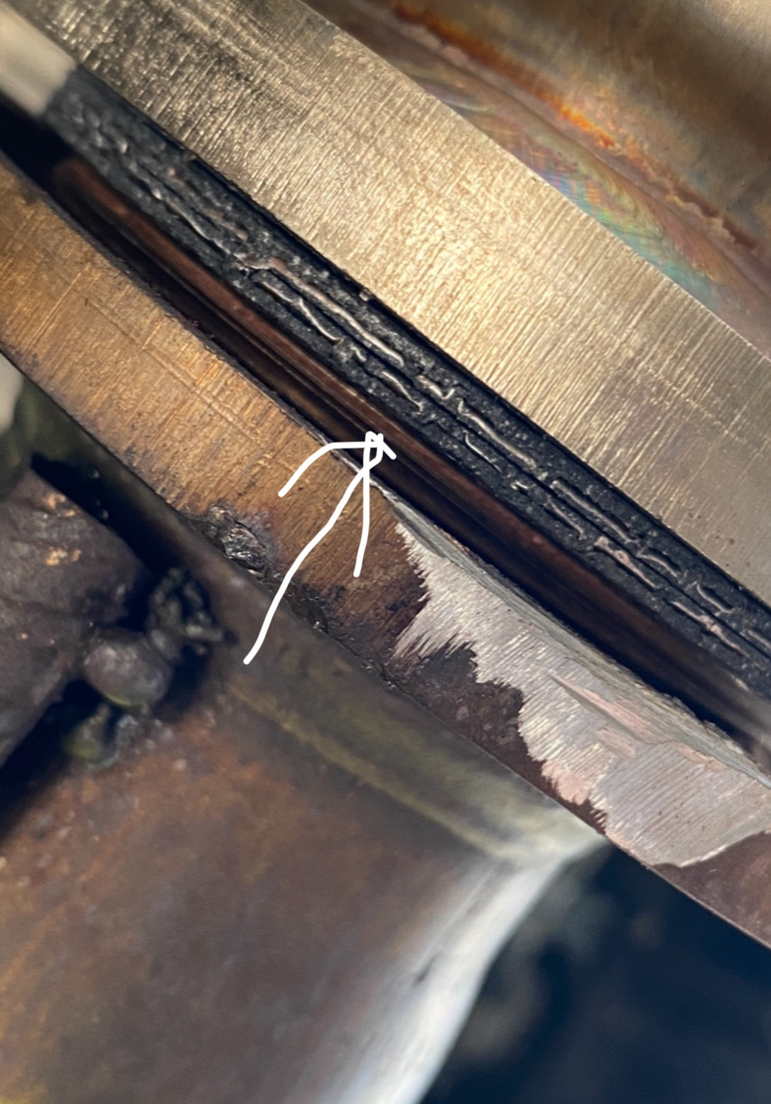

    Im tightening down and it seems like the flanges don’t want to seat together flush like stock. I can still see the silver gasket on the SPD side. Am I supposed to remove the gasket that was in the stock cat side?
  27. Jun 8, 2024 at 1:09 PM
    #327
    reywcms
    Dec 20, 2021
    #72040
    7,229
    Rey
    North Plains,Oregon
    Yes you remove the stock gaskets
    Mdl, ARES35 and 2TunGet1[QUOTED] like this.
  28. Jun 8, 2024 at 1:17 PM
    #328
    2TunGet1
    2TunGet1 Tundra owner since 2000
    Jul 7, 2023
    #99907
    330
    2020 Limited 4x4 CM QS / 2000 Limited 4x2 AC Black
    I tightened down as much as I could. I can still see a slight gap. Is this okay?
    SC_Mike likes this.
  29. Jun 8, 2024 at 1:28 PM
    #329
    reywcms
    Dec 20, 2021
    #72040
    7,229
    Rey
    North Plains,Oregon
    yes that’s ok
    2TunGet1[QUOTED] likes this.
