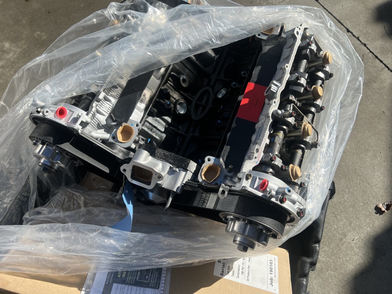

  14. Jan 15, 2023 at 6:21 PM
    Hotwire
    Hotwire [OP] New Member
    Nov 14, 2020
    #54894
    248
    Montana
    2008 Tundra SR5 double cab
    Freight coordinator called to schedule new engine delivery tomorrow :fingerscrossed:
