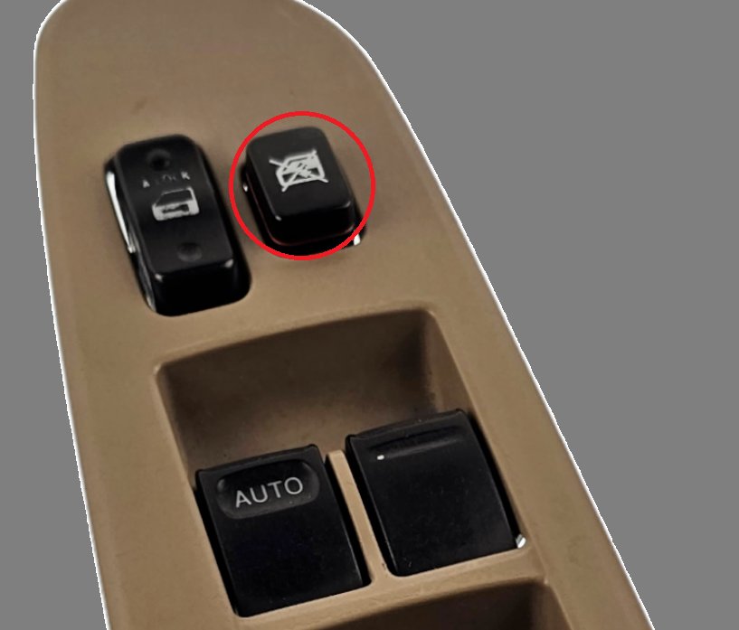

    Hey all, After a major Texas rainstorm, where my window was partly down, the drivers side window switch would only operate the drivers window, not the other three. Figured it was the switch so I called Toyota (what a laugh..750.00 for the switch). Ended up getting a known good assembly and installed it. Same problem, HUMmmm.
    What is the procedure for initiating a new switch?

    Just to be 100% positive, sorry if this seems like a stupid question:
    The symptoms you describe are exactly what happens if you accidentally tap the lockout button. Are you 100% sure the lockout button isn't engaged? (Believe me, you wouldn't be the 1st)
    Also, do the windows work on the other 3 doors using their dedicated controls while they won't work on the driver's side? Just trying to think through things that may be happening.
    I'm having trouble trying to understand why water inside would cause the issue you describe, based on how things are wired together under the cover plate. But if it happened with two, I guess it potentially ain't the switch...

    Thanks for the suggestion. The lock switch wiring may be the problem. You are right about the switch getting wet, my next guess is a short on the harness or where it goes out of the door. The other switches all work at each door. It is just this master that is messed.
    The quest continues...
