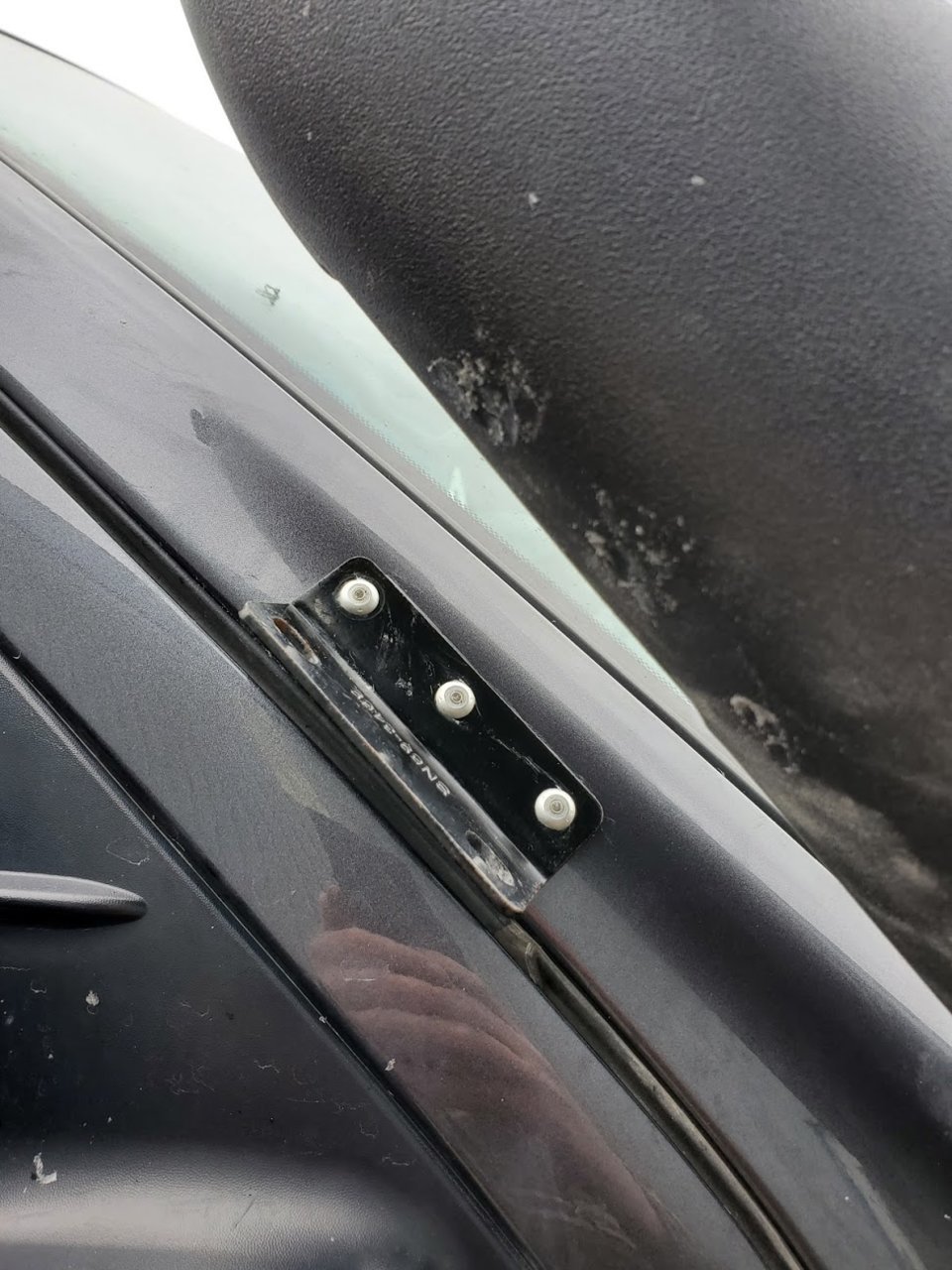

    Taking the advice of @crikeymike, I finally riveted on the upper mounting plate. I ended up using Cherrymax rivets which are solid structural rivets typically used in aviation. The P/N is CR3213-6-3 for anyone wanting to use them instead. They can be pulled with a regular pop rivet gun, are stronger, and have a solid core for less chance of water entry.

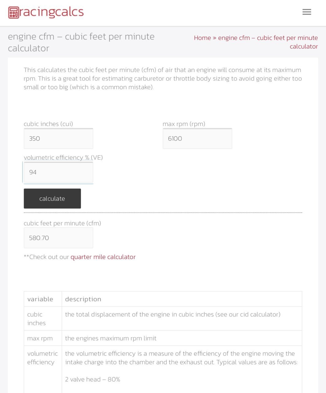

    so 100ll they want my CFM to tell me what's the right preclearner! hummm, so how do I figure out what it is?? 5.7 l crewmax trd 4x4 thanks

    If you look in the product description for the link I posted, you will see "For Engines 4.8 to 6.2 Liters" and ours are 5.7.

    There are cfm calculators available online. I went through Donaldson, they confirmed cfm requirement, and needed a pre-filter with a 5” outlet.
    https://racingcalcs.com/cfm-cubic-feet-per-minute-calculator/
    I did the math on VE for the 5.7 and it is 94%, you can use a lower value like 80%, but it’s still 500ish cfm required.
