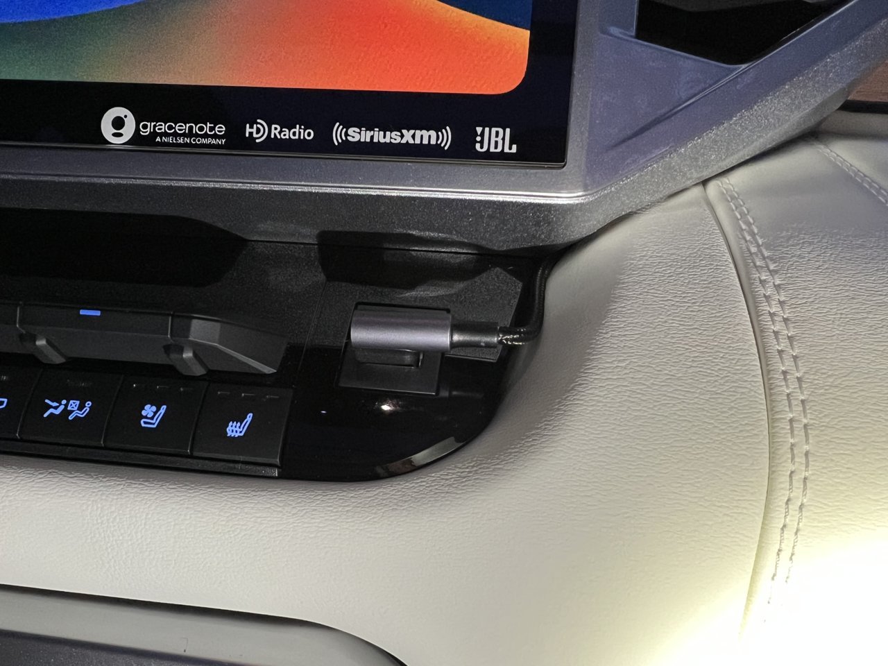

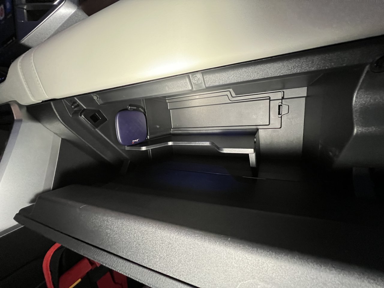

    Finally got it in tonight... This will make those long days sitting at a construction site much more tolerable!

    Nice clean install. :thumbsup:

    Got a link to that cable?

    Thanks for the info. Can you send some info on the process to install that cord please?

    @1794Tundra1202 I fished my cable(same one as MaiToyTunCap) through the front and fished it through. I removed the inside filter cover in the glove compartment to grab it. I did notch the cover for the cable too. I wasn't about to tear the dash apart.

    @TheSS712 Thank you - going to give it a shot this weekend. I agree with you there, not trying to take the dash apart. Nice to know that I don't have to!

    Someone with small hands can definitely grab the cable after feeding it through the dash. I fed it through pretty much right above the usb outlet.
