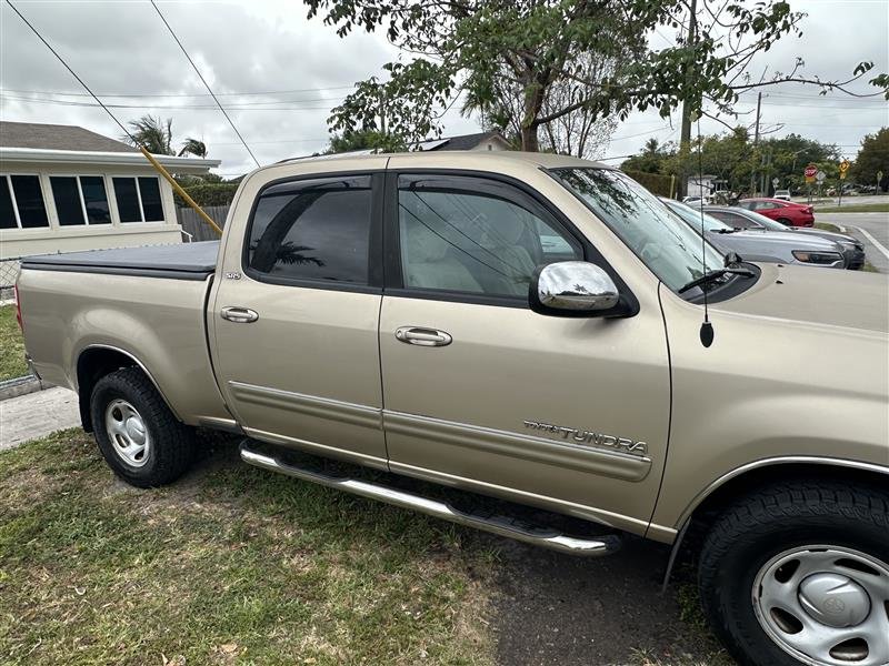

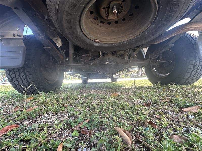

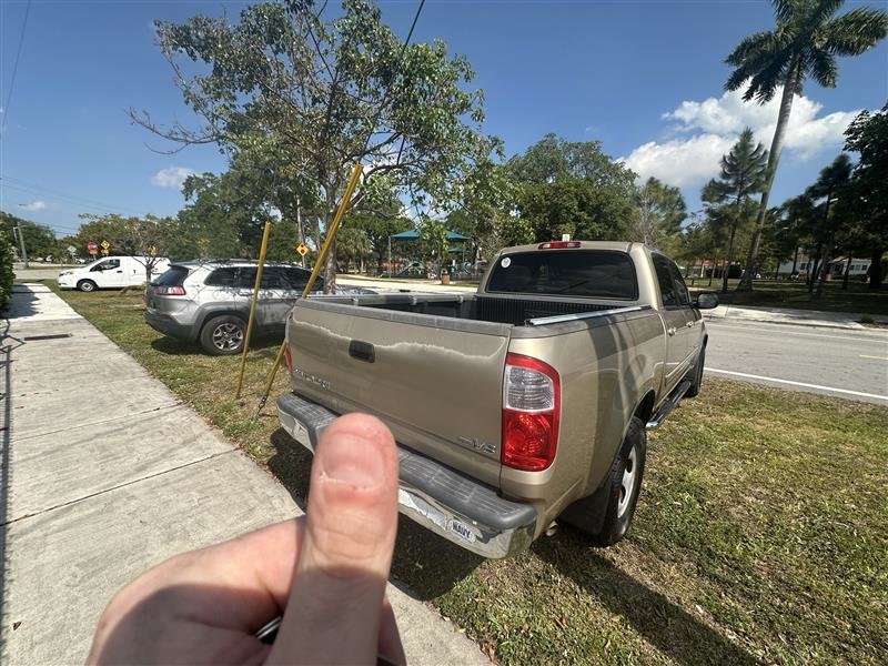

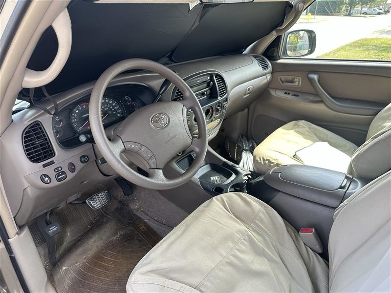

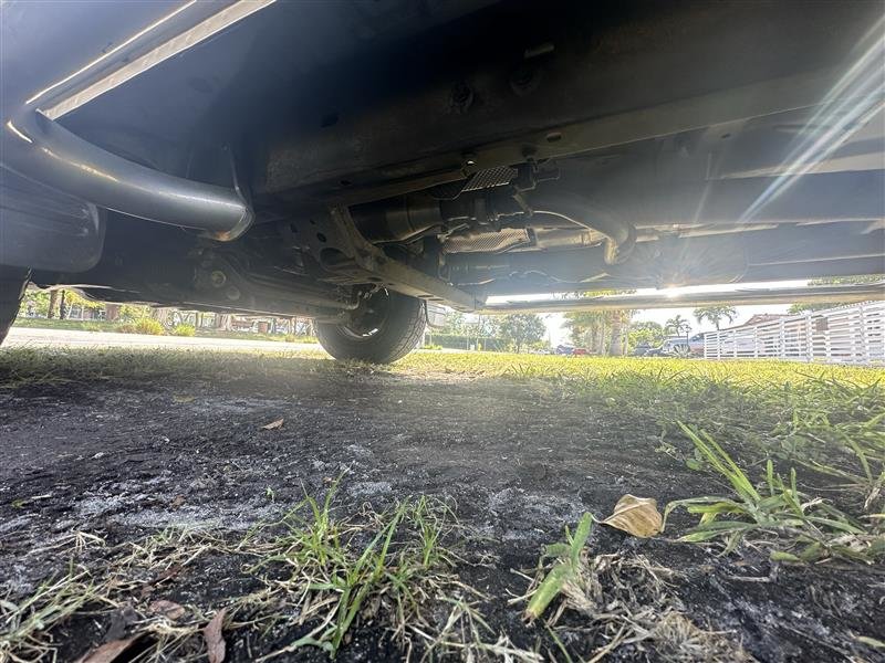

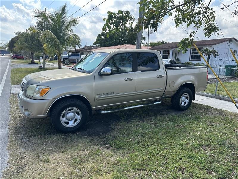

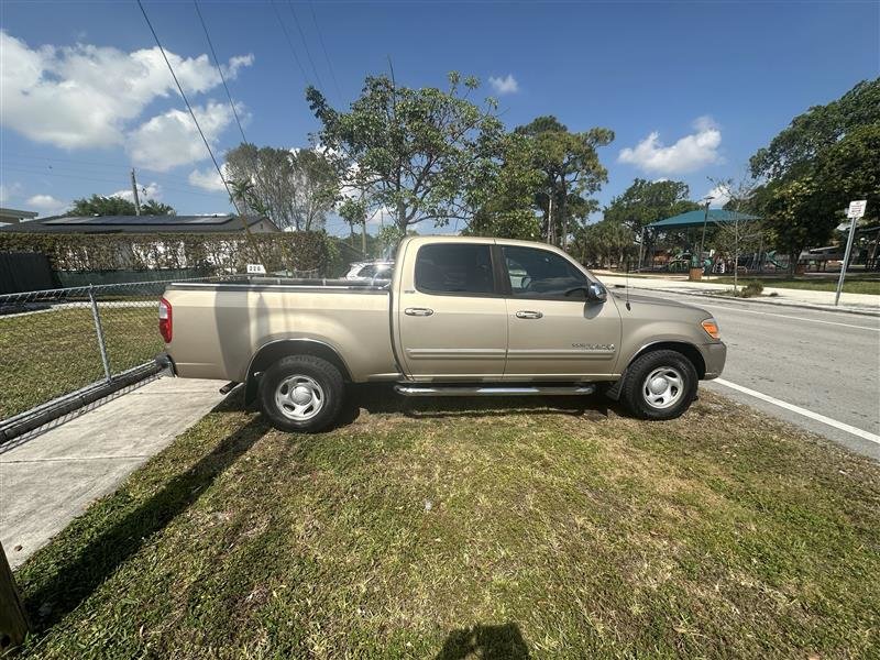

    2005 Tundra SR5 DC 2WD
    Image (17).jpg Image (14).jpg Image (20).jpg Image (1.jpg Image (15).jpg Image (16).jpg Image (18).jpg Image (19).jpg

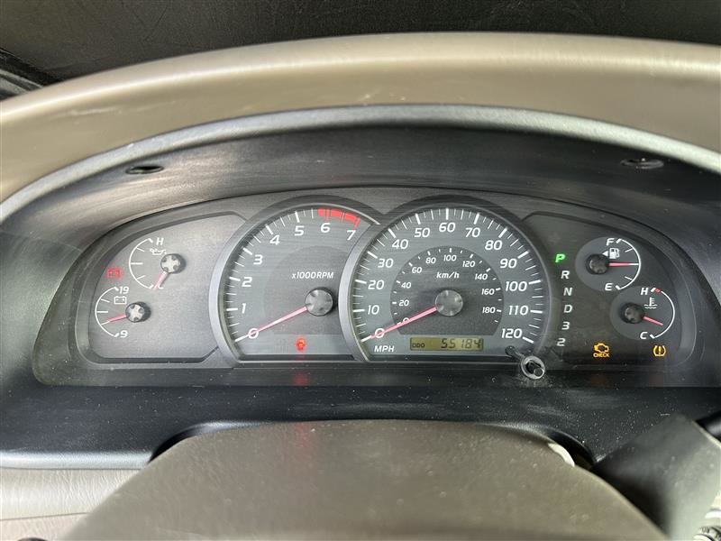

    55k original miles. It was my late grandfather's truck. LBJs were replaced at 30k miles, and the front brakes were replaced at 50k miles six years ago. I'm proud to be the owner of a 1st generation Tundra.

    Whoa, 55K!!! That's awesome. Congrats! Welcome to the group. Would be of great value to read the link @ATBAV8 posted above.

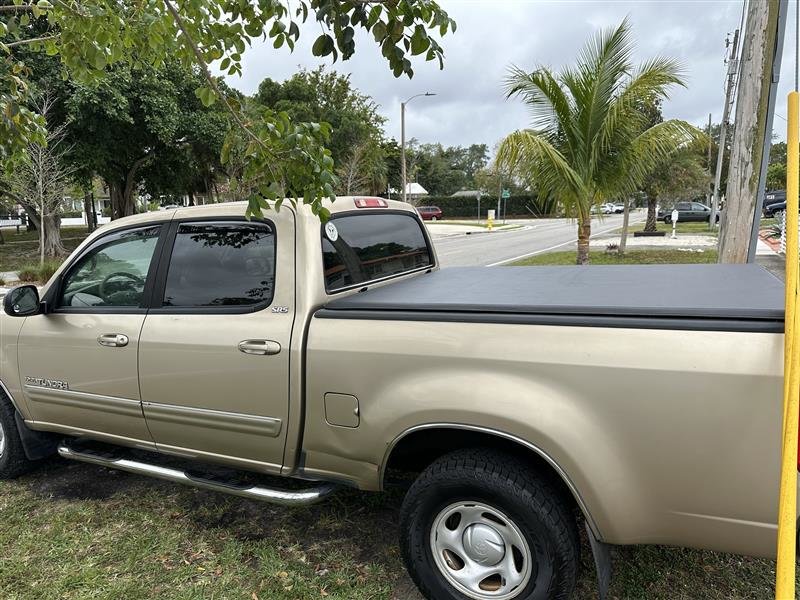

    So far, I've completed several updates to the truck. I replaced the rear emergency brake cable and flushed and bled the brakes, including the load-sensing proportioning valve (LSPV). Currently, I am waiting for the timing belt kit from Rock Auto, which is an Aisin kit. I have also ordered the crankshaft seal, camshaft seals, and a Toyota Form In Place Gasket. Additionally, I plan to order a radiator from Rock Auto and seven gallons of Super Long Life Coolant from the dealer.

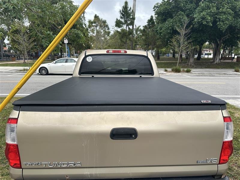

    I had the rubber green bushing for the brake sensor wear out, so I ordered a replacement bushing from Amazon. In the meantime, I'm using a zip tie to block the hole where the brake sensor plunger goes through. I installed a bed cover from Amazon, and to my surprise, it worked out really well.
    Recently, I encountered a check engine code P0441. I ordered a replacement gas cap and the purge valve 90910-12259, and I'm waiting for them to arrive this Friday so I can install them. I also replaced the door weather strips and the front window side weather strips. I’m currently waiting for the rear glass weather strip to arrive for installation. Also added the Weathertech Window deflectors.
