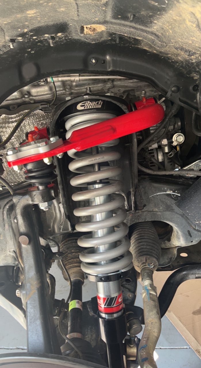

    ToyTec Alumas 2.5,icon IT 2.5 rear,Wheelers superbumpstops, JBA UCA’s, 8 inch BA muffler kit,
    I went with eibachs on this tundra my last one had toytec alumas. When I can I’ll go back to Alumas 2.5. Budget versus extreme is the variable. By no means are the eibachs bad they just aren’t ToyTec grade.
