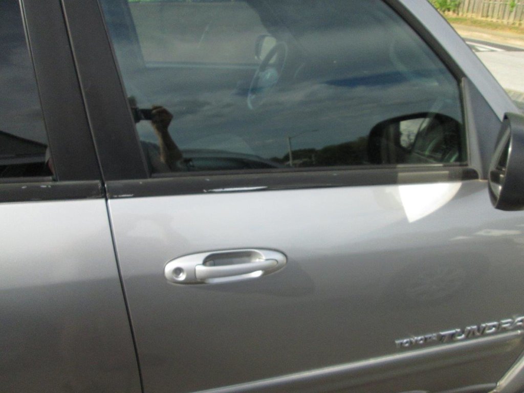

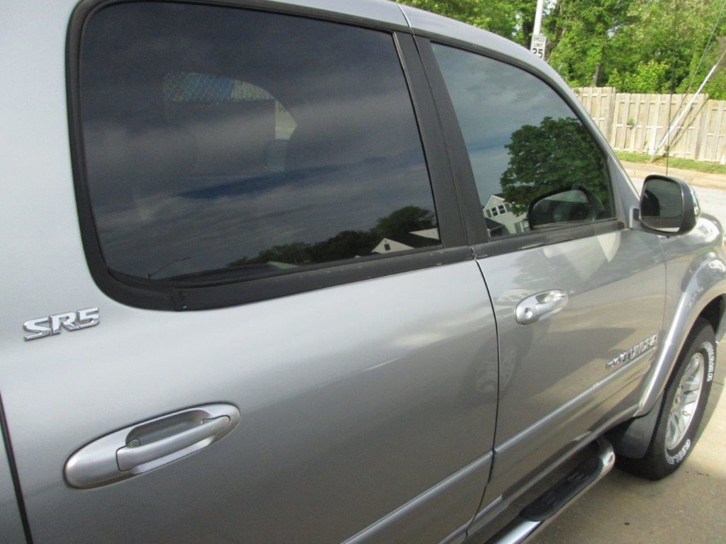

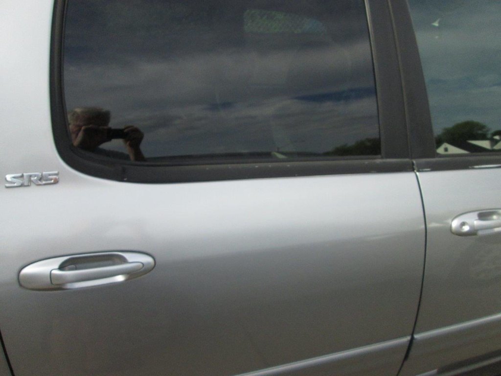

    I need some help with replacing the door weatherstripping. The black coating is bad.
    I don't know how to remove them and could use some help with part numbers for both doors, both sides.
    Just hoping someone already did this.
    Thanks!

    I did see something pretty cool on the facebooks. Someone used vinyl wrap that was carbon fiber patterened. It actually turned out really nice.
    But in looking at what comes off of them when they crack and peel, it almost looks like Toyota wrapped them from the factory. I know they didn't, but the paint peels off so nice, it's almost like they did.

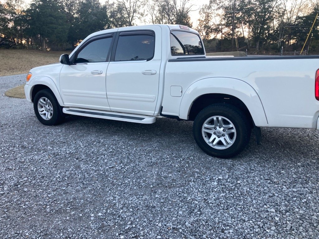

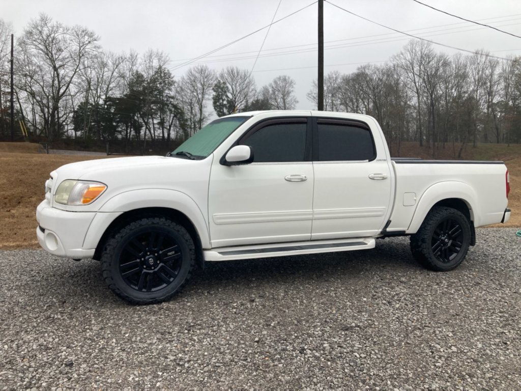

    I pulled mine off and used a magic eraser on a drill to take the black wrap off. They are stainless and shine really nice when polished. I kept mine polished to give off a little shiny accent to match my badging on the back of the door. Its just a hint of shine and compliments the lines of the trucks. This is just my opinion but i cleaned it off cause the OEM wrap was peeling up and planned to paint or re-wrap it but afterwards mounted them back on and said
    "dang this looks pretty good"
    And its been shiny ever since. Here are probably the only two real good side shots that show the reflection. Its just a touch of shine that helps compliment the chrome badging on the door.
