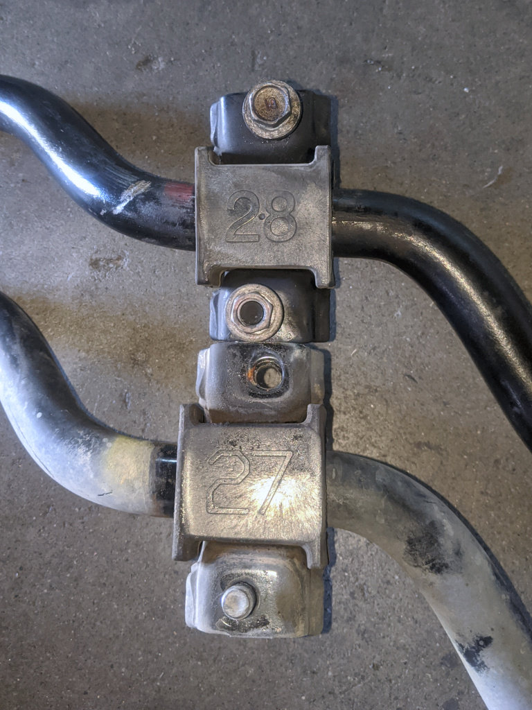

    28mm was sequoia with sunroof only iirc.
    27mm is later year tundra iirc (what my 2wd '05 had).
    If you have the original bushings, Toyota embossed the size in the mold.

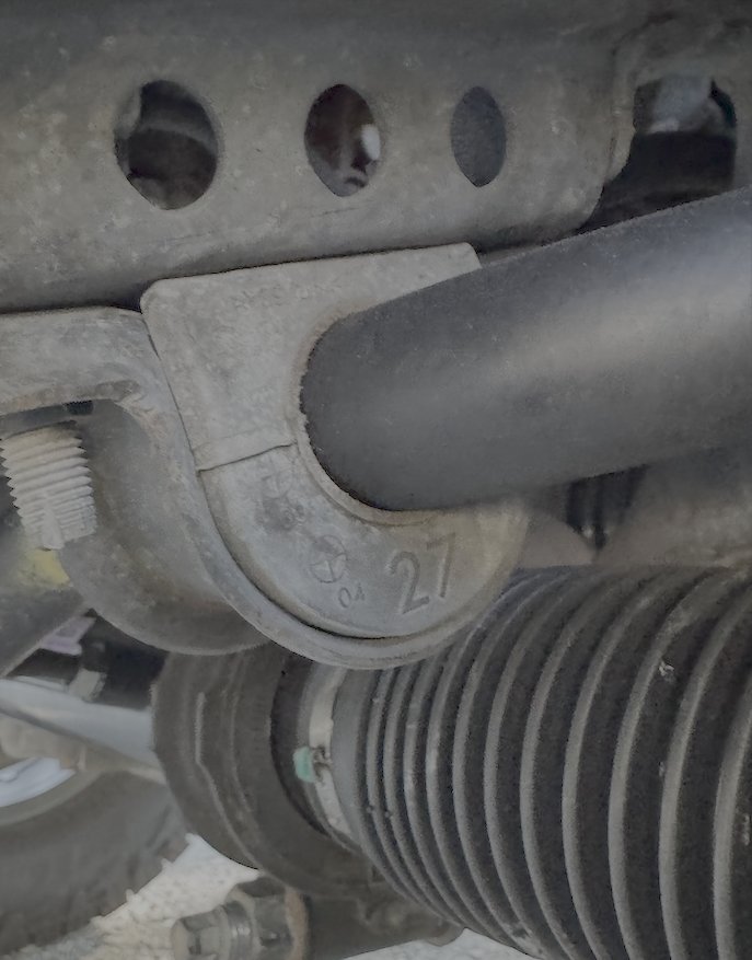

    @w666 so we have the exact same year/model truck (04 AC SR5 V8 4X4) and I just got my new bushings from Ourisman.
    The bushings they sent me, based on providing my VIN, are the 24s. However, when I was underneath the truck checking my original bushings I saw that they are marked "27" on the side of the bushing. I did not remove them yet to see what was printed on the flat bottom section....
    Is it possible that I have 27mm bushings? When I inquired with Ourisman they said it might just be a casting id.
  26. Jun 24, 2025 at 3:37 PM

    Yep, I have a set of digi calipers and I just used them...... and well, I have a 27mm sway bar.
    It even has the yellow paint on it, just like the one in the pic a few posts up. So I guess the Ourisman VIN check is not bullet-proof.

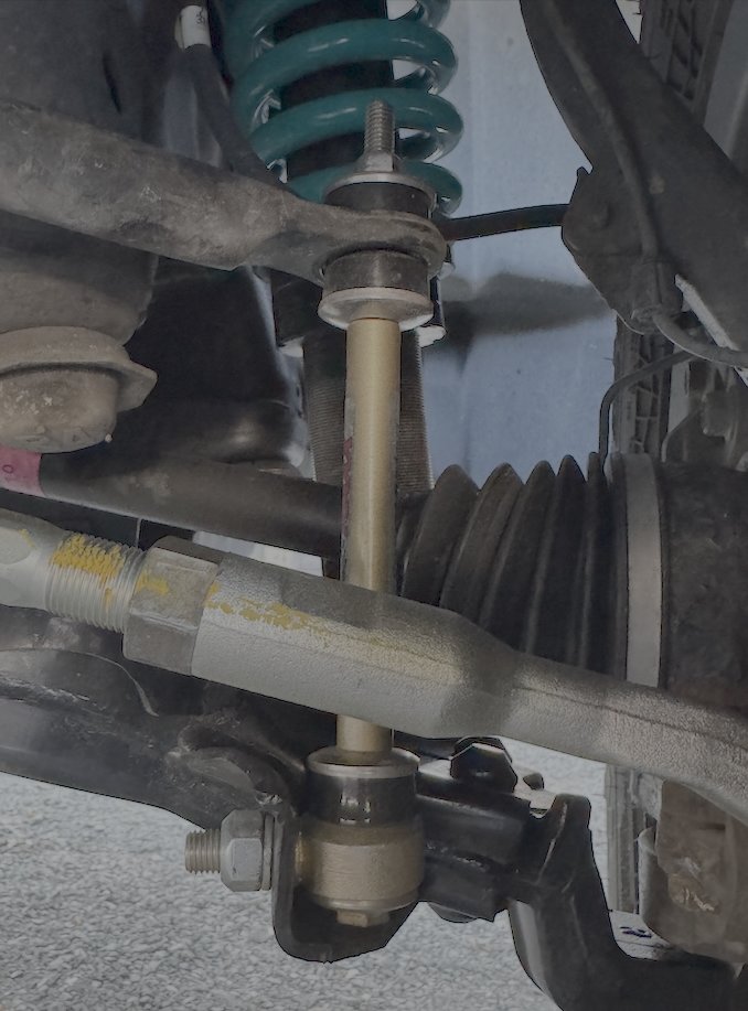

    The reason I bought these bushings is because after putting in new Suspension Maxx links, and a new OEM steering rack, I still have a slight clunk going over rough sections of road at low speeds, turning into driveways, cornering through a pothole etc.
    But looking at my sway bar bushings, they appear to be in good shape... see below. Am I wrong there?
    And here are my new Suspension Maxx links, do you notice anything unusual that would cause a clunk?

    Even if the D bushings only have a few thousandths on an inch play, they might make a clunking sound. Mine did.
