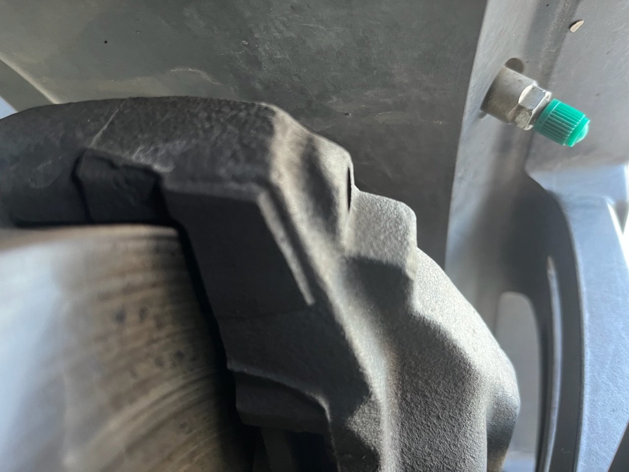

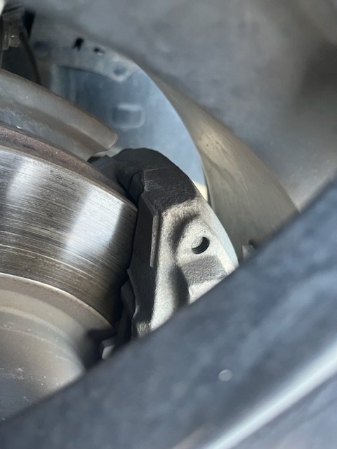

    Got my brake fluid changed at the dealer last year and it improved the tightness of the braking. A year later and its mushy again. Had the tires changed a month ago and no mention of the brakes needing replacement. I do the occasional squeel when cold.
    If I do replace brakes I was thinking Akeboni ceramic brakes. I tow a lot so I want something that'll last and do the job well. Is it necessary to replace rotors or can I just resurface them?

    how many miles on your brake rotors? If braking is still smooth (and appears there is no ridge along top based on your photos), then they might be good to go for a while.
