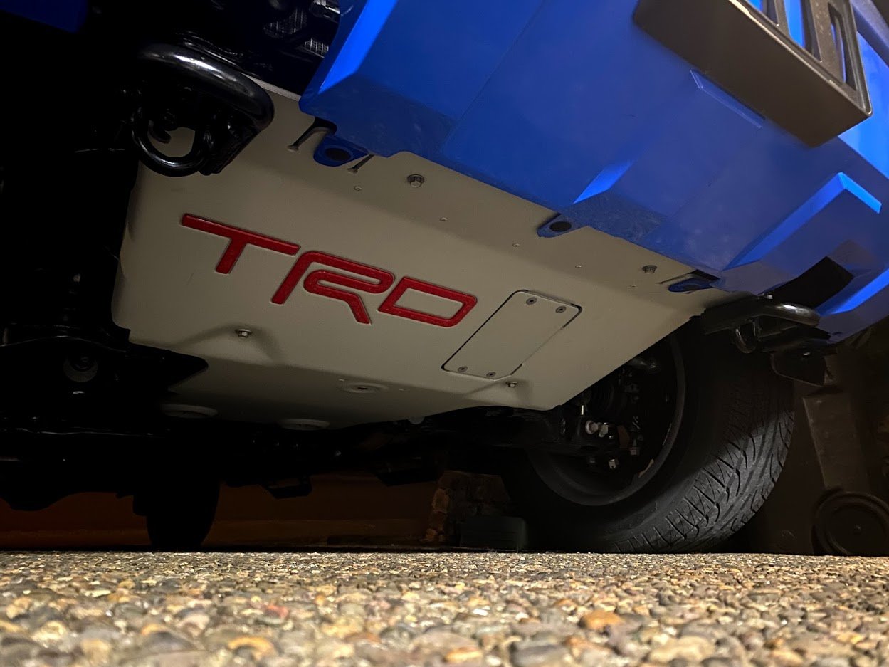

    NEPAChuy
    NEPAChuy [OP] New Member
    Mar 10, 2020
    #43797
    94
    2023 Tundra Platinum Hybrid Supersonic Red, 2020 Tundra Platinum Voodoo Blue
    Truck is a work in progress. I think next step is getting some 18" black wheels and new tires.

    Crunch527
    Crunch527 Brute Force and Ignorance
    Nov 1, 2016
    #5049
    671
    Iowa
    TRD Supercharger/BAM
    Good on you for getting that figured out. I have the same skid and they are more trouble than they are worth, not to mention expensive for what it is.
    If you didn’t put some rubber gasket material between the areas where the skid plate touched the frame, you will experience popping noises. No matter if you installed the hardware perfectly.
    Best to get some thin rubber gasket material from Lowes and slip in between and retighten.
    There are threads on here with pics.
