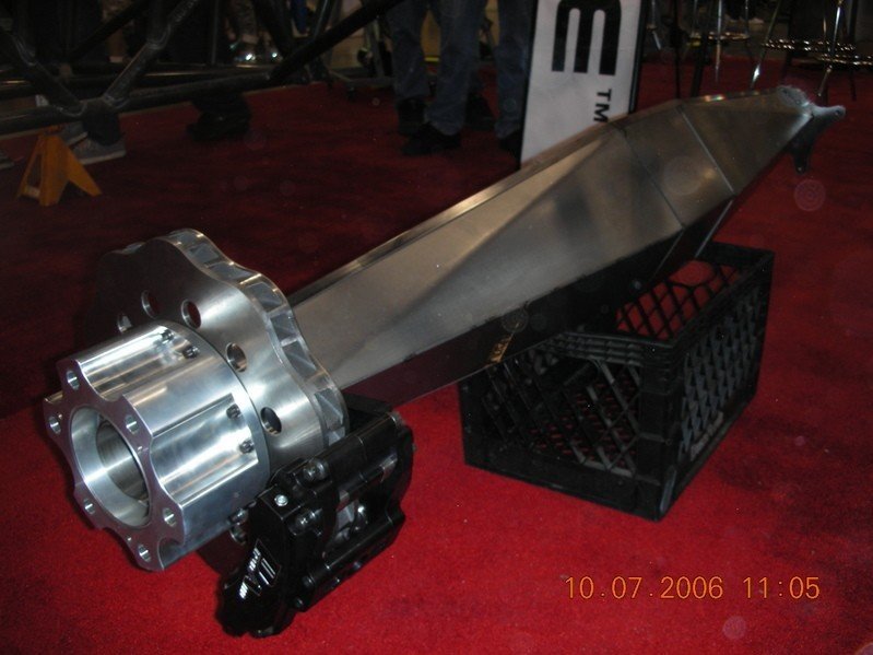

    Thought I'd share some rear end porn that I found doing more homework. Fairly certain this is about as tits as it gets from the TT world. lol
    Specs;
    47 spline 300m gun drilled shafts-Aparrently from all of the homework i've done so far. I've learned the TT guys break the 40 splines on a regular basis.
    Christman 10" diff- which is a ford 9" clearanced for a 10" ring gear among other specs I can't find.....yet
    Just out of shear curiosity I want to know more about this shiny beautiful object lol
    It's on milk crates to show off how light it is.
    ColoradoTJ likes this.

    Not a bad way to spend $8000+....
    Buahhaaaaahaaaaahhaa
    bandit[OP] likes this.

    RIGHT!!! hahahaha. still that's a sexy piece of engineering right there!

    If you have the coin, do it. I would have some envy.
    A full Spider 9 is going to cost you some coin too.
    That front axle that I posted earlier must me made of gold. Into that one for 5000.00 plus.
