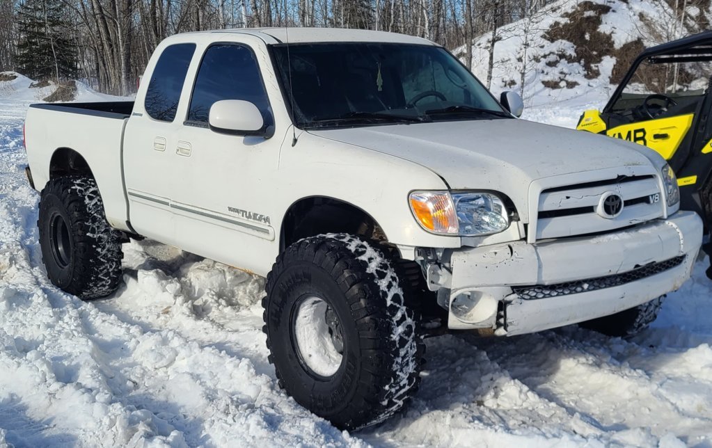

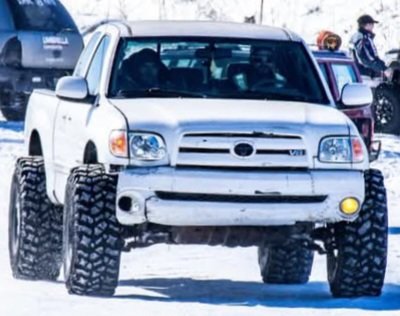

    Sounds like you need a solid axle swap! That way you can push the front axle forward for better approach angle of those ledges and better tire clearance for 37s. Bracket lift and cutting it for bigger tires may work, but it's definitely not the best or strongest way to do it. And then you're still stuck with shitty angle stock CVs and very weak 7.5" diff. Both of which will be easy to break with the v8 turning 37s on the rocks. Just my 2 cents.
    Don't you dare use the "J" word around here! Lol, the only reason they're halfway worth a shit is the solid front axle. And factory lockers, sway bar disconnects and ultra low transfer case gears depending on model. And you nailed it on the reliability... Almost any toyota with half those things will be able to out wheel a jeep with the right driver.
    Side note. I did try the 37s game on my 06. The truck was just sitting and I wanted to build a beater. The only size tires I had were 37s. 5100s leveled in front. Stock rear. Lots and lots of cutting. It rubs when I turn full lock because I had to run spacers. 15" wheels don't clear the brakes. I want to try stock 17" wheels and spacers. I probably wouldn't rub then. Would I recommend it or do it again? Probably not. Will I switch to 35s for better clearance and less fear of the front diff exploding? Yes probably lol. With a solid axle swap I wouldn't hesitate to run 37"+ tires. I hope to get a d60 and 42s under this rig in the very distant future.
