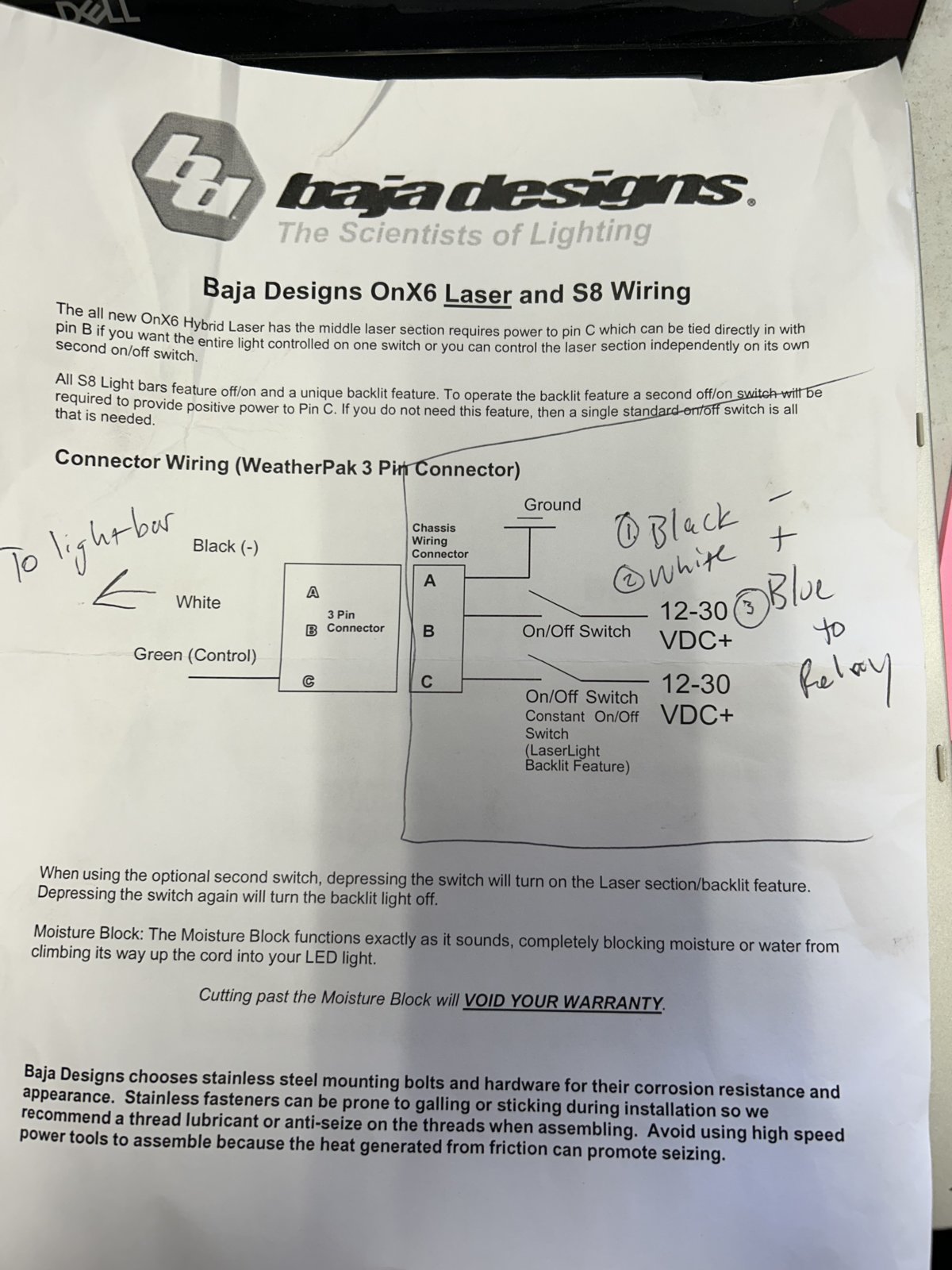

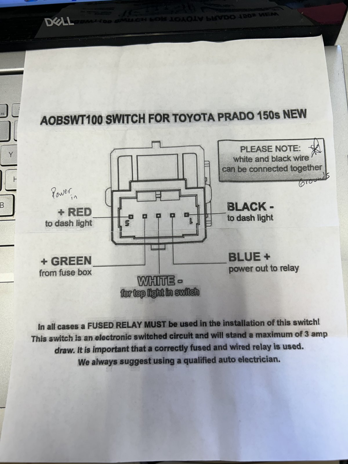

    Yes, I understand that. The confusion lies in how I get those three wires from the BD harness connected to the 5 wires (or 4 if you consider the combined grounds) from the switch harness. The pin diagram from the switch is confusing. Posted again here for reference.

    It goes together just how it shows:
    Red is illumination/dash light +, green is 12v, white and black are ground, blue to the relay.
    I’d pull out a meter or test light and verify the black wire on the BD harness is your 12v.

    no. Black is ground and white is hot.

    Success! Finally got it. Thanks all. I had my red and green swapped.
