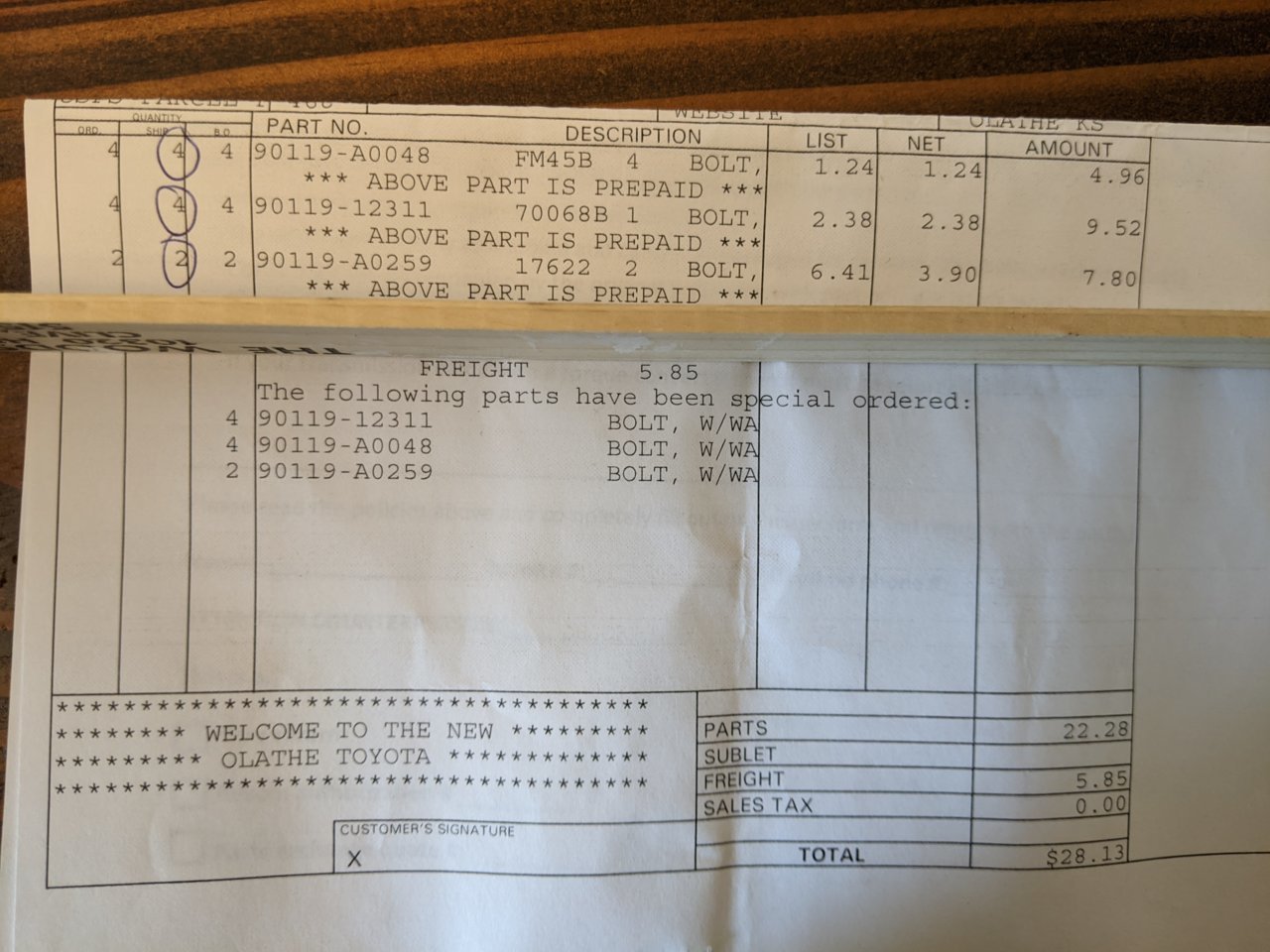

    I believe the 2 more expensive bolts are the long ones that go through the bumper and into the tow assembly

    Thanks man. That’s awesome. Is the one set of bolts not for the bumper bolts? The AO259? is coming up for a control arm.
    The other 2 are coming up for the bumper. I’ve been looking everywhere for this info. So I need 2 of the one and 4 of the other ?

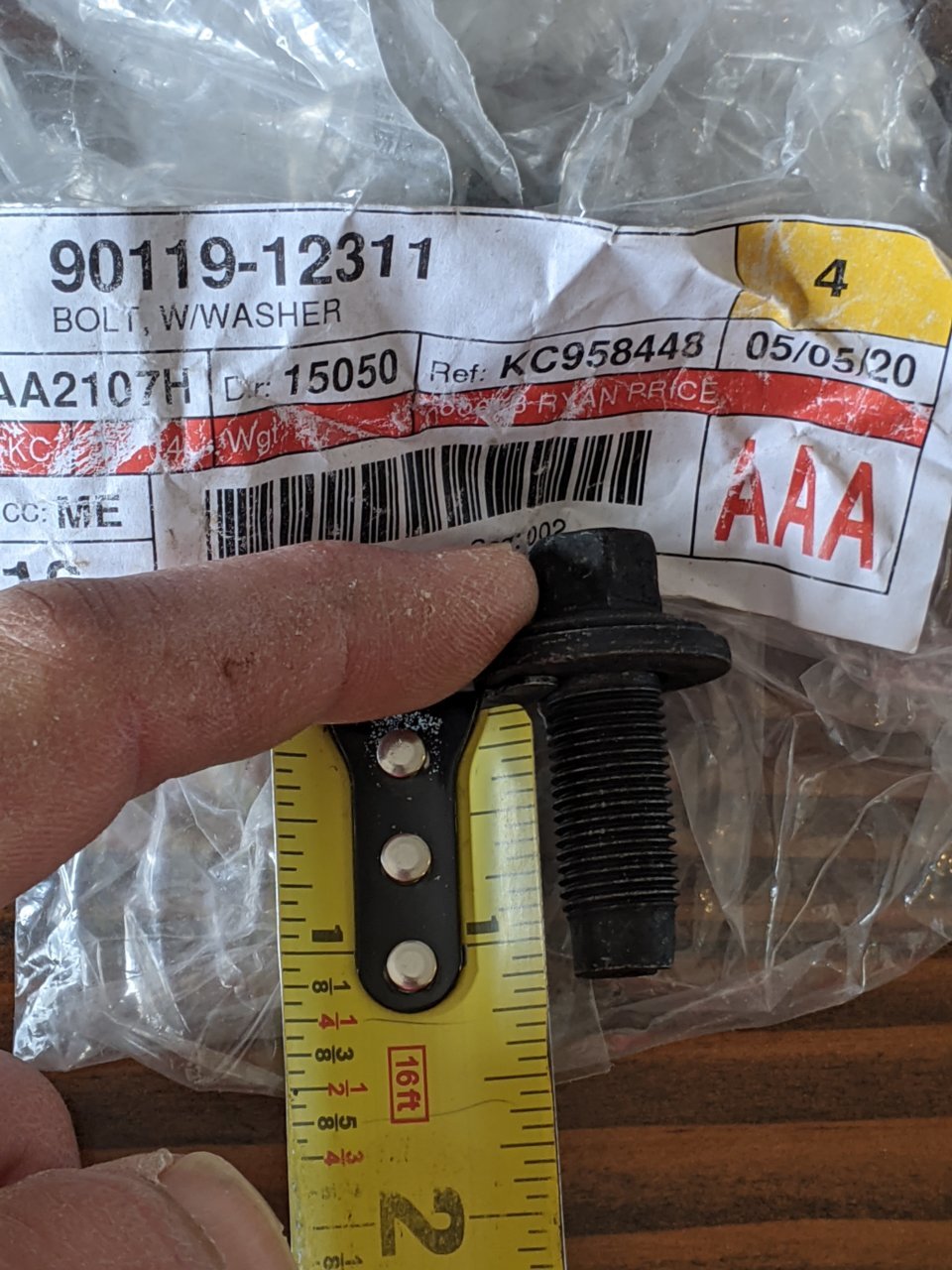

    A0259 are the larger bolts that are for tow assembly.
    There are 4 bolts under the plastic, I'm not totally sure I ordered those.
    Then there are 4 on underside of bumper that attach it to frame or bumper support. I believe they are theA0048.
    For reference here's the 12311. I haven't installed.
    The easiest way is to call. I used Olathe toyota and the guy figured out what I needed.
